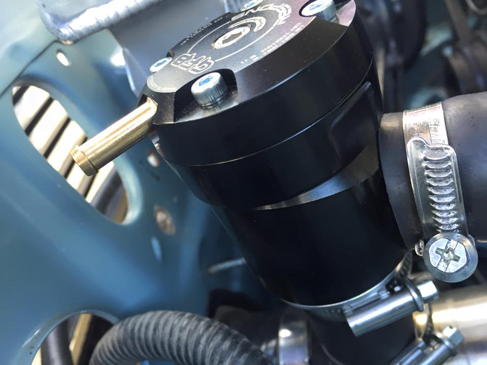

pics of the top mount external gate steam pipe exhaust manifold, the brand new gt2860rs, gfb tms response bov, 38mm tial external gate

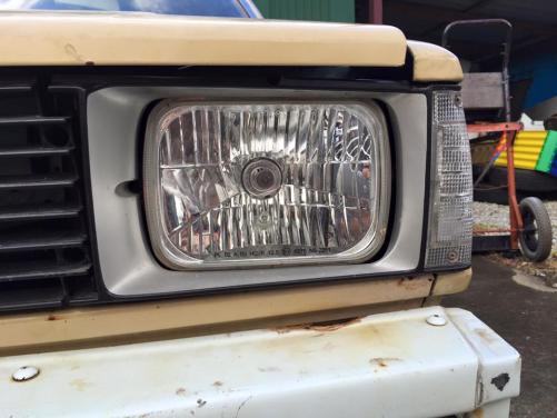

new bars for the ke and brand new head lights and tail lights from ebay
pics of the engine bay sprayed stone blue in arcylic metalic pearl with the ca18 droped in almost ready to fire her up soon. upgraded the radiator from the corroded stock one. got a new intercooler 400x300 I think from 999 automotive for better response. pics of the intercooler piping with the plumb back bov to keep it nice and legal to try keep those cops away. also got the exhaust done by fabulious fabrications
PIPING FAB 2-2.5” HOT SIDE, 2.5” COLD SIDE INTERCOOLER PIPING
INTAKE 3” INTAKE PIPE
BOV PLUMB BACK
DUMP ONE PIECE DUMP/FRONT PIPE TO SUIT T28, 2” OUTLET WITH FLEX JOIN AND MOUNT TO GEARBOX
CAT 3” HIGH FLOW METALCAT, FLANGED
EXHAUST 3” CATBACK, OVER DIFF, FLANGED AT MUFFLER
MUFFLER 3” MAGNAFLOW MUFFLER
WASTEGATE PLUMB BACK
