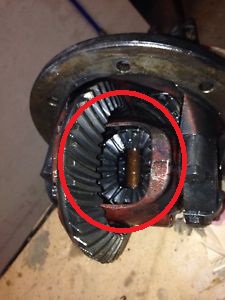

Cheers for the info boys, I have a few more questions. Would different ways of welding the diff cause more difficult to pull apart? Also, different diff ratios would cause a problem correct? I'm pretty sure they're the same but it would be awkward if I pulled it all apart and they were different.
All the welded difs I've seen have the spider gears welded together and/or welded to the crownwheel carrier, neither of these should stop you unbolting the crownwheel off the carrier.
different dif ratios shouldn't hurt as you will be using the crownwheel and the pinion from the welded dif

Cheers Jon! I'l certainly have a look into pulling them apart. So basically just swap them over and be careful with lining up?
Edited by SloRolla
on mine, that entire hole is just weld. It was pretty poorly done, slag all over the gears.
