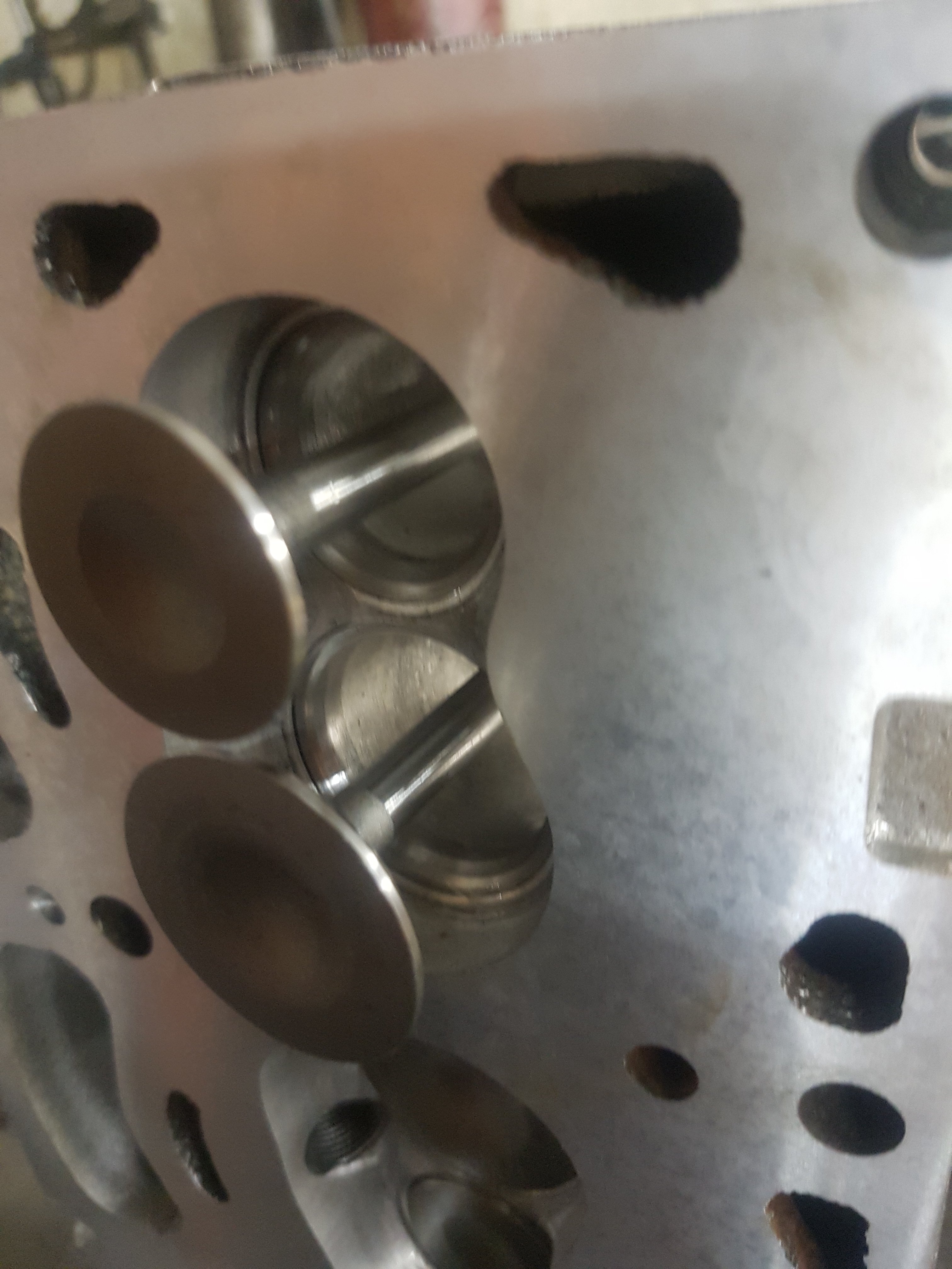

 I know I can go 1mm over using the factory valves seats but i'm wondering if its worth fitting new valve seats and going up to the 38mm, I haven't played with bigger valves before so not sure how much difference 37-38mm would make. Any ideas?

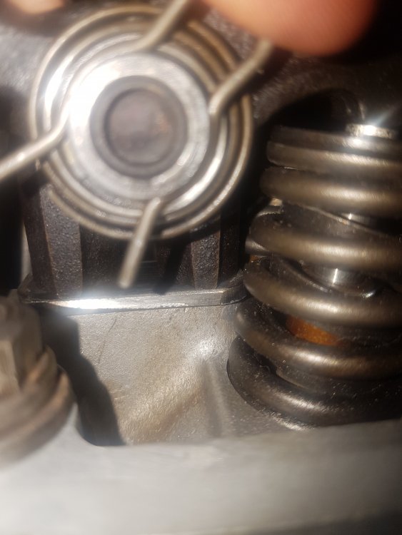

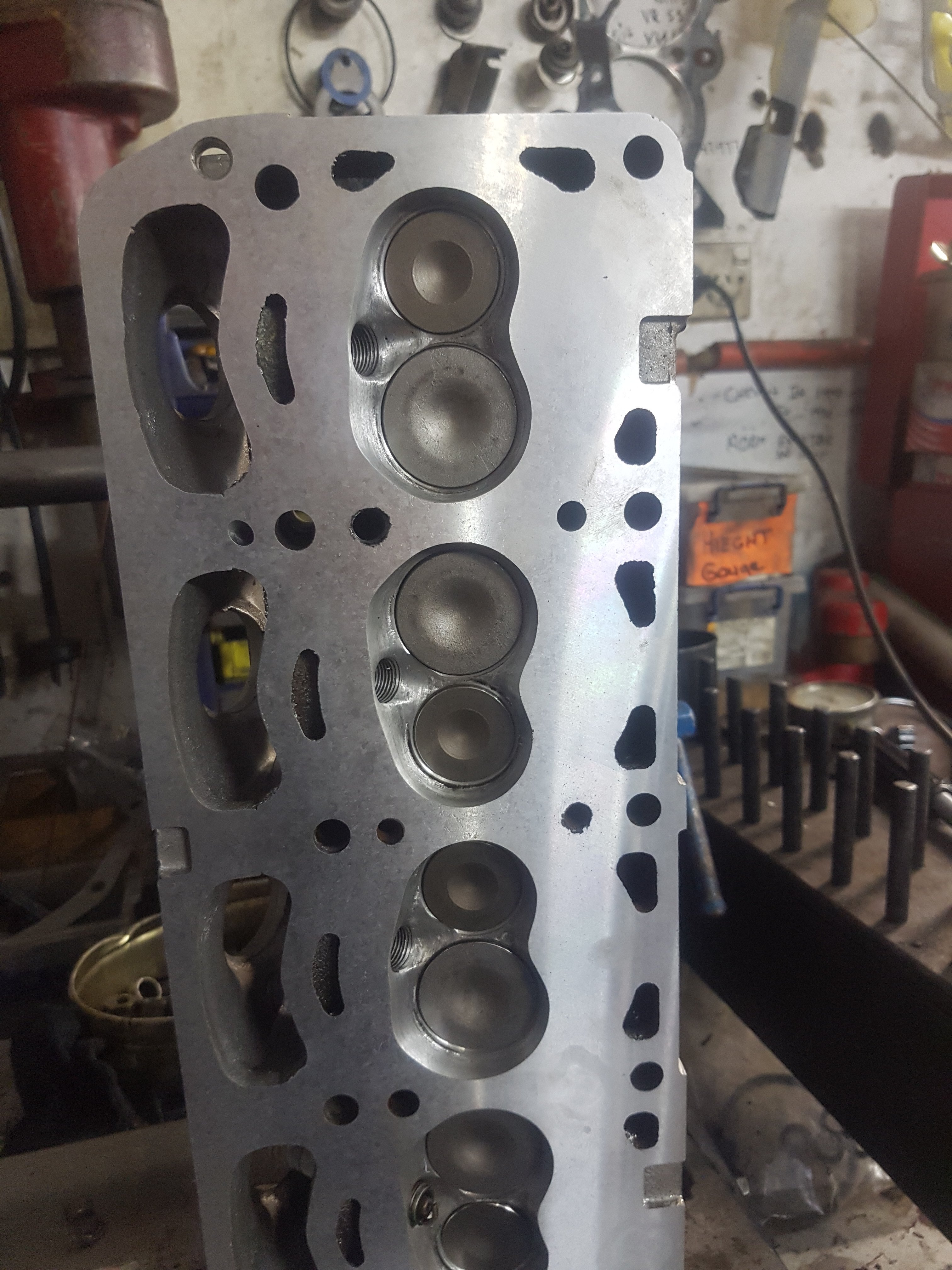

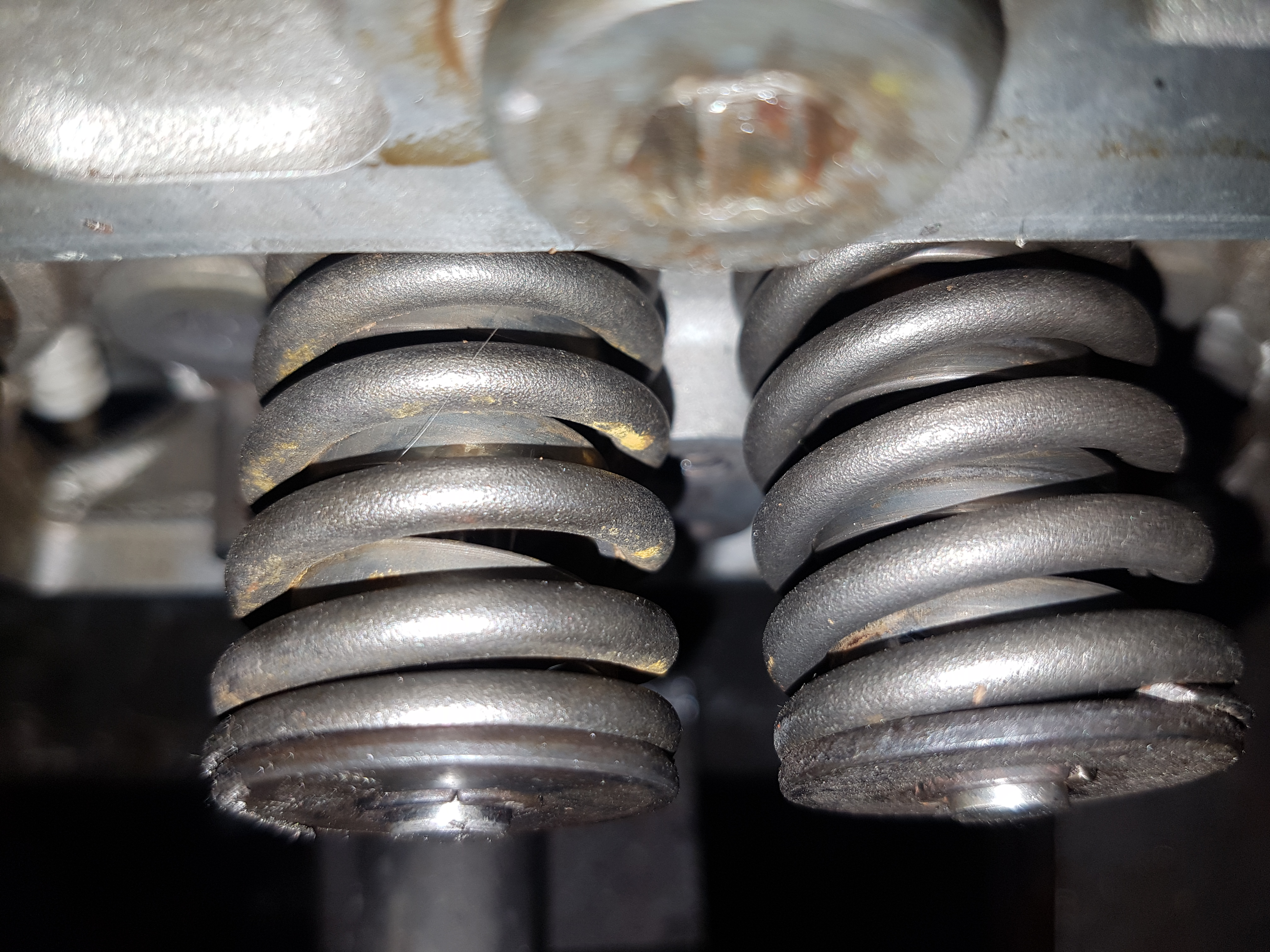

I have used a15 valves In my 5k you need to use blue 202 valve springs datsan colets and a12 pushrods and 3k adjustable rocker gear  and you have to make 3mm spacer to space up the rocker gear
You have to get the seat recut to suit the valves and porting the head will also help with flow You have to trim the rocker gear adjustment screw

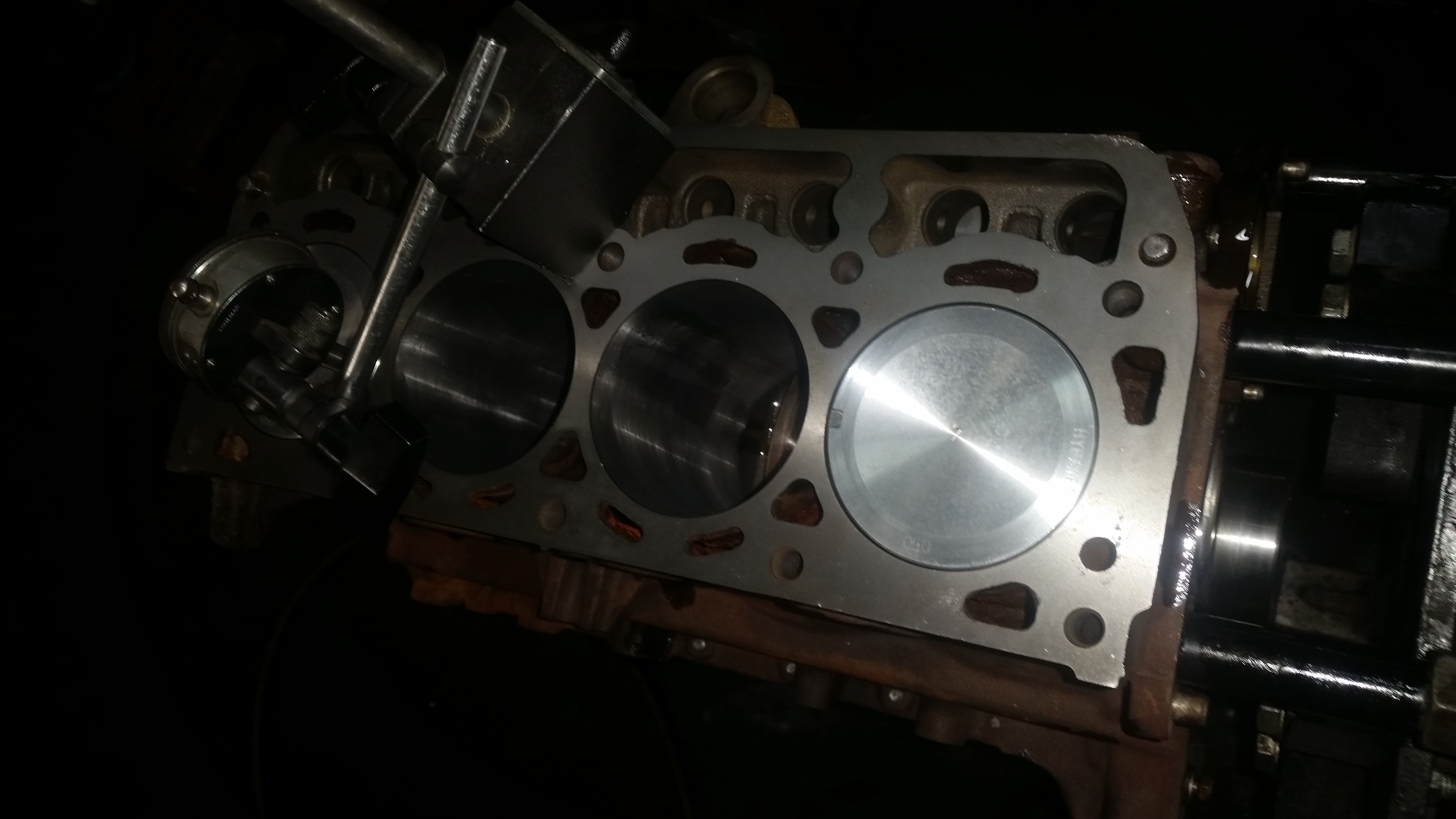

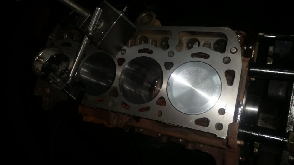

40thou over, 10:1 comp, twin 40mm Dellortos, light flywheel, electronic ignition, ported head, double valve springs, big cam, extractors, rebuild.

If you read my 5k build post it tell everything i did
I didnt take much off the 3kb head as I'm running a zero deck height and machined the 0 dish pistons down to a near flat top
