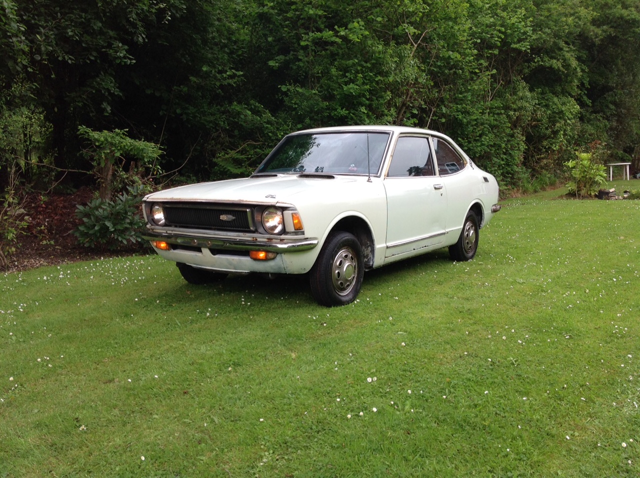

I'm going to sound like a novice thats exactly what i am at this point with the ke25's, on some i have seen bonnets with a lip were as mine is flat what options are they
are the bonnets different on the te27
Essentially the answer is that there is an early and late front, with different bonnets, bonnet trim, under grill trim corner garnish and so on.
Model change occurred from August 1972.  Yours is an early model.
A TE27 is your body shell with a vast range of options and trim levels from a 1400 T engine all the way through to 1600 2TG's.  Put simply the coupe chassis with a T engine.  Most of these model options were available in Japan only.  US also had TE27 variant but with a 2T rather than a 2TG
so how do i go buy getting that bonnet
If you want the later pointed bonnet, you need the other bits that go with it, as above.  I left out the grille from the list.  There is some serious money to be spent.
Like anything, you will need to find them, which in your neck of the woods may be hard work.  Even in Australia, where these cars were very popular, they are now hard to find, especially in reasonable condition, whether early or late.  Guards, bonnets, bonnet front trim, grilles and correct grille trims, corner garnishes are in high demand and generally priced accordingly.
If you prefer the Trueno type front, you will also need the Trueno specific guards which are different again, as are the various Trueno front parts.  Australia didn't get the Trueno model.
Essentially you join the parts roundabout like everyone else.  I spent years getting to know people around the world when I was actively sourcing parts, and it took me some years to locate everything I needed.  Since then, prices have risen astronomically.
I would think very seriously about the effort and expense of sourcing the later front end panels.  The early flat front is a rarer model these days and a very nice one was restored here in Qld not that long ago before being put on the market for an astronomical price.  It was a genuine TE27 levin however.  Not sure if it ever actually sold.
If you can find them, shipping will be horrendous.  There is a guy in Spain you will probably already have found on ebay who gets good stuff, but at eye watering prices.  And "modify", a member on these forums (and others) from NZ is able to source parts and good to deal with.  He is also involved with a great guy (Grant) who makes replica seat trims and door trims.  You will quickly find him on your forum travels.
