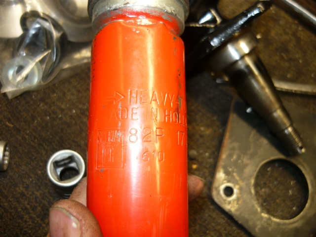

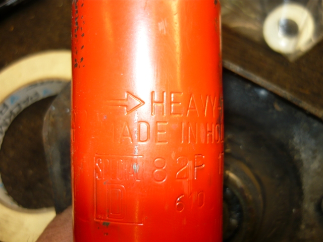

Firstly, anybody know of someone that rebuilds old school Koni red / yellow strut inserts. I had mine rebuilt about 5 years ago but never installed. I have recently fitted them but one is not right. They are adjustable but adjusting does nothing. Toperformance said they are too old and they don't have parts for them any more.
Secondly. what are other people using if they need replacing?
P1010512.JPG.b6a003b51a410a3bb65f02f9367a3031.JPGP1010513.JPG.0b6e6a42894a304564bfaee13362eab7.JPGP1010516.JPG.1d2515ee363b354717800057786f6d38.JPG

Seems I have 2 choices.
.Monroe GT Gas
Or SACHS Shock Absorber 290 675
Both about the same price. Anyone have a preference or know of a problem with one?

I think you will really struggle to find anything other than a standard insert for these unfortunately.
Question has been asked a few times.
This was one of the more recent
https://www.rollaclub.com/board/topic/72643-shock-absorber-inserts-for-front-struts/#comment-704206

I'd laugh but I'm not much further either.
You would reckon that if a Golf insert fits, surely there would be an adjustable option available somewhere. I'd be asking Golf specialists in Germany or UK.
When I put the short body MR2 inserts in the front of my AE86 I used the technotoytuning spacers that double as the top nut. This places the insert low down in the strut body to reduce the possibility of bottoming out the piston.
I'd reckon some one of your skill and ingenuity could make something up like that, as long as you can find the right insert.

And at least from he two old threads you have evidence that the Golf inserts will actually fit

Another option I have read about is AW11 rear inserts which aparently are the smaller diameter (as compared to the larger diameter ae86/ae92 size).  used as a short stoke shock youll need to make a spacer if putting into std housing. Or shorten the housing.

The AW11 inserts are discussed in one of the threads referenced above, but apparently only a particular early model AW11 insert fits

Sorry i hadent clicked all the links. I'm sure the autostore or shock shop you're buying from will be able to confirm the correct sizing.  if not, walk away.
