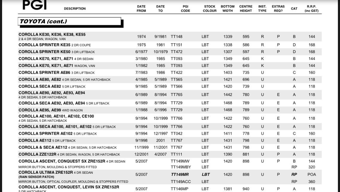

I would like to know if the front windshield from KE30  is interchangeble from ke35?
They look very similar but not sure.

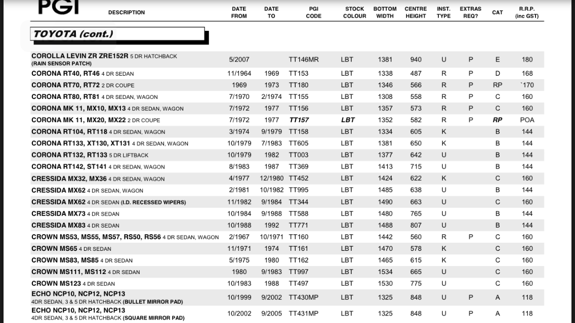

Here are the other relevant ones for most of us. Don't assume a listing means the screen is available. Just a reference regarding sizes. i.e the KE15 screen was NLA when I downloaded this quite some years ago.
