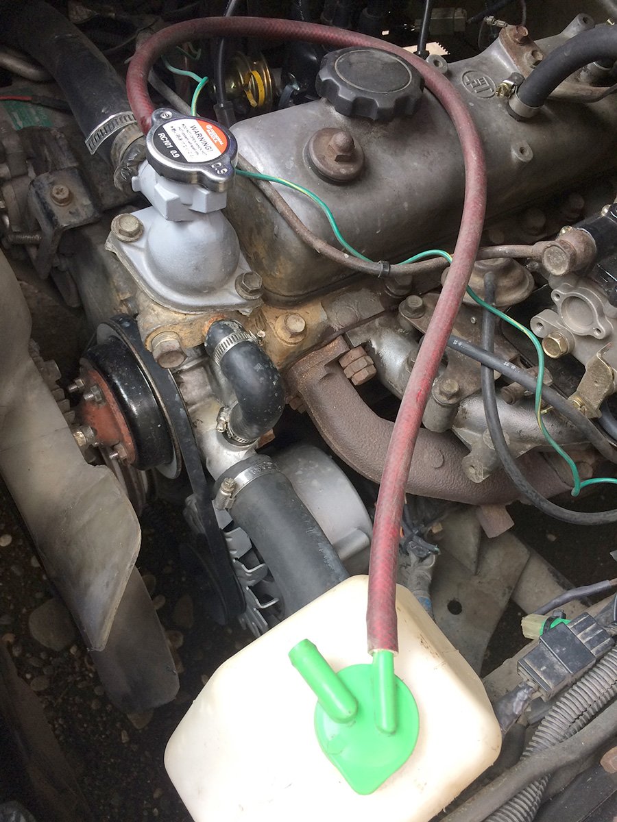

Just replaced the water pump and hoses on my 5K.  This engine has a radiator cap on the water neck, owing to the position of the radiator in the KM30.  Today while running the engine with the cap removed, I observed at higher RPMs that water churns right out the top.  Is this normal behavior?  I had expected sort of an 'upwelling' of water coming up out of the head to the water neck and rad hose.  But this shoots out with enough force that it is also going out my overflow hose, which attaches in the same location as the top rad hose.  This explains why I lose about a liter of water over the course of a 20 minute highway drive, and also why poking around town it won't really lose much water at all (no overflow bottle, long story).
I do not believe there is any thermostat installed, tomorrow I will pull the t-stat housing and have a look.  It occurs to me perhaps the t-stat normally would prevent the churning that I'm seeing.
Any thoughts?

updated pic
Yep, I'd expect you are right.
..and seeing there is no trace of coolant stains there I'd say you live in a hot climate and the previous owner had some sort of cooling problem with it.
Confirmed no t-stat installed.  Spent the better part of the afternoon with my father in law making a bracket to hang the overflow bottle, Philippine style.  Yes you are correct, no coolant until I can keep everything in the system haha.  After installing and filling the overflow bottle, we took it for an extended drive with no issues.  Today was cooler, however, but tomorrow is a trip over the mountain.  Fingers crossed.....
My theory is the weight of the water in the bottle would serve to prevent casual splashing at the neck from getting through the overflow tube -- it has a volume of water pushing back against it.  Will keep an eye on things and plan to install a thermostat.

Two observations made since yesterday which concern me:  1) a kind of milky slime in the t-stat housing, 2) white smoke from the exhaust at higher rpms.   So I'm thinking a new head gasket may be in store.
Not good....  Well, don't worry about coolant,that's for sure!  When you get a t'stat in it, fill it up and start it from cold with the rad cap off.  Any compression leak usually pushes bubbles up the radiator and floods half a litre of water out before the bubbles can escape. Maybe this is why there was no t'stat in there. I'm not sure how well this test will work with your rad cap placement, but give it a go.  Also, it loses that top bit of water then doesn't lose the rest so quickly, day after day if you top it up.
