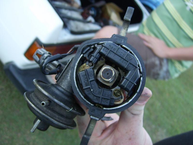

The distributor I bought for my 4K from
the salvage yard here was also marked "5K".
The connector was identical. It also had
a two-stage vacuum advance pump.

i have the same distributor with the two-stage vacuum advance pump and i don't know how i connect it???(the two-stage vacuum advance pump)???? :monkey:
You can use a plastic T-connector, which
the salvage yard owner can probably give
you, and connect the single hose from your
carburetor's vacuum inlet to both outlets
on the vacuum diaphragms.
Some say that the outer one is for advance,
while the inner one to supposed to go to the
manifold for retard, while others say both ports
are for advance - one giving advance at low to
moderate engine speeds, while the other gives
a bit more advance at very high RPMs. I guess this
depends on the diaphragm's design and engine
application.
In my case, both appeared to be for advance, with
the outer one giving more advance than the inner.
I used one of those metal splitters found in aquarium
pumps, which had shutoff taps, as I wanted to
experiment shutting off each hose in turn to see
what difference it made. If you do not have the T-connector,
you can of course use these splitters and open up both
outlets permanently. The vacuum hoses fit them exactly.
If you cannot get metal ones, normal plastic ones can be
used, which was what I used at first, and appear to be
able to withstand the engine heat.
You can read my other thread "Electronic Distributor
for 4K Engine" .

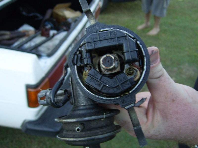

....Now i find one carb with 2 valves!can u help me if this is right to put it between distributor and my carb?
or
I read your article!!!thanks
Seems there are some script errors with the
pics you posted, can't see them.
I'm not familar with the extra vacuum inlets on
other carbs. Maybe the others here can help.
According to Mikey's Toy on the other post,
he mentioned that the outer diaphragm port
goes to the standard inlet just above the
carb's butterfly for advance, and the inner one
goes to the intake manifold port for retard.
Edited by Tham
i believe now its ok!!! :faq:
yeah Mikey's Toy I believe it has the better opinion!
