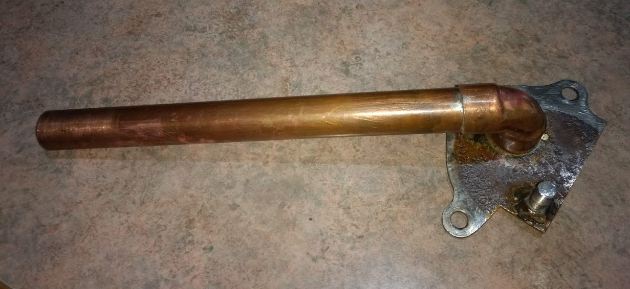

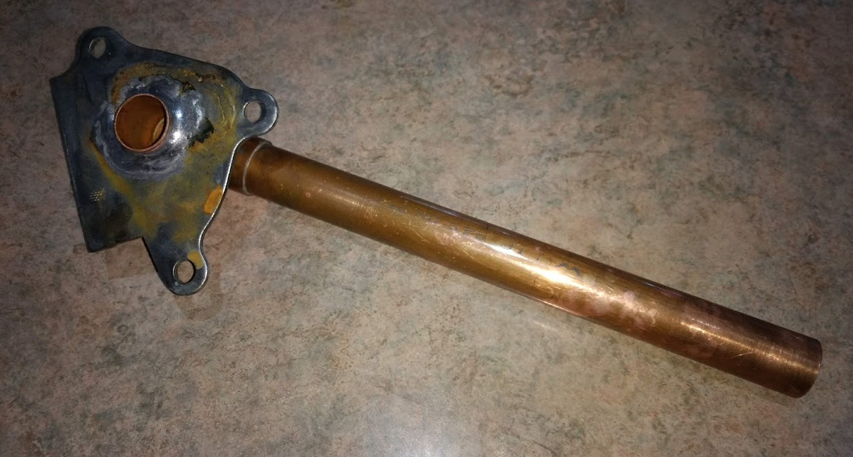

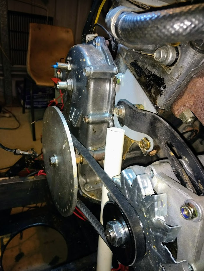

The original water pump backing plate, cut down; is now mounted on the 5K EFI project.
Without the water pump & it's fan belt driven pulley, I have fitted a shorter belt between the crankshaft pulley & the new 120A alternator.
The belt adjustment tension bar, is now pivoted off a post on the upper RH corner of the backing plate; as previously, it was in the same position, but on the front of the pump body, that no longer exists.  There is not a lot of room, betwwen the back of the alternator & the timing chain cover, so the white plastic pipe, was used to work out where an entry point was needed on the backing plate to feed the water into the block's water jacket.
The original hole in the backing plate was filled in, & welded with a filler piece.  A new hole was cut above to be the entry point for coolant to the block water jacket.  The bottom raditor outlet, will be connected to an electric water pump, whose outlet will be connected to the bottom of this depicted 25mm dia. copper pipe.  So here is what it looks like at the moment.
The vertical copper pipe has been left intentionally long; so that when the electric water pump arrives from Sydney (thank you ebay), I can mount it down near the bottom radiator outlet, & then cut the depicted vertical copper pipe to a length, to suit the final position, of the new electric water pump.

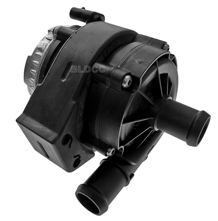

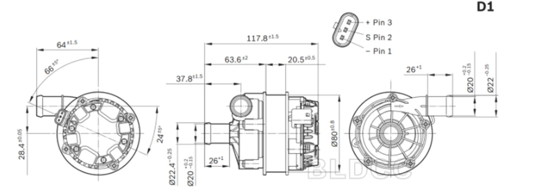

For those of you interested, here are the specs, of the Bosch electric water pump, which I will receive on Monday.  I'm sure it will do the job.  I had a giggle regarding the spec. for max. lift, of up to 7 metres.  My guess is that the vertical distance from the radiator outlet, to the top of the 5K head would be about 1 metre, so no issues there.

Got the pump lashed up on the test bed engine, & it is now going great, but was not without, a few learning curved balls encountered..  That's it; down in the lower LH corner of the pic.
First thing I noticed, was how quiet the electric water pump was. In fact it was so quiet, it was hard to tell, it was running. The exercise today, was just to get it running On/Off, at full speed.  Varibable speed; controlling the flow rate, will have to wait, until I build a suitable controller.
Initially, I could not get the electric water pump, to run for more than a few seconds, before it automatically shut down.  I figured it was sensing that the pump was "dry", & shutting down to protect it.  It did seem however, a very short time, before it shut down.  I have no idea, what sensor it uses, & was not going to pull the pump apart, to find out.  Purging air from the coolant passages, may be a very definite requirement, when first filling the coolant system.
I learnt a quick lesson, that the pump needs a "flooded inlet", at all times, & that the outlet, must be facing upwards, & be higher than the inlet; so no air gets trapped inside the pump body, at all.
After I repositioned the pump, (as above) it ran without cutting out at all.  I measured the DC amperes, & it was pulling 5.6 amperes.

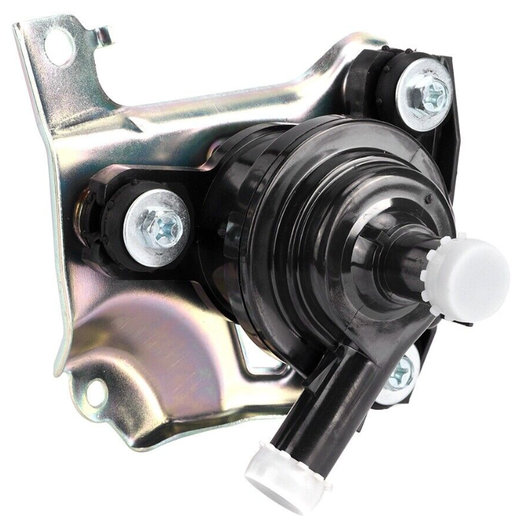

Here is another commonly available electric water pump, off an early Toyota Prius.  I like the fact, that it has three (3) rubber isolated mounting points, which renders it easily to mount; unlike the Bosch unit, I currently using.

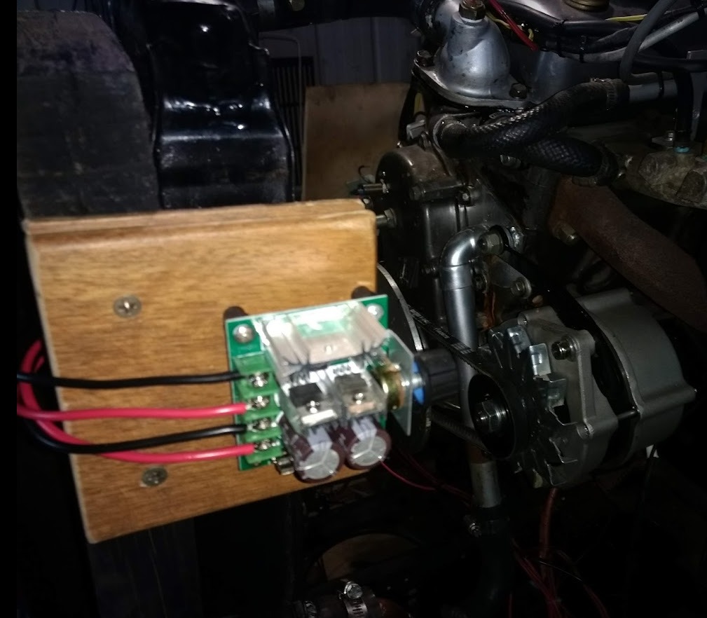

I found a DC motor speed controller on ebay, which controls the electric water pump, & flow of the coolant, from a trickle to full on.  It handles a DC load of up to 10 amperes.  With the radiator cap removed, you can clearly see the water flow change as the water pump speed is changed.
It has a knob on it, which will be useful, as I manually try different flows & resultant temperatures, but also can be controlled by a 0-5V DC voltage, ultimately; from a controller, once a control system & program, is determined.

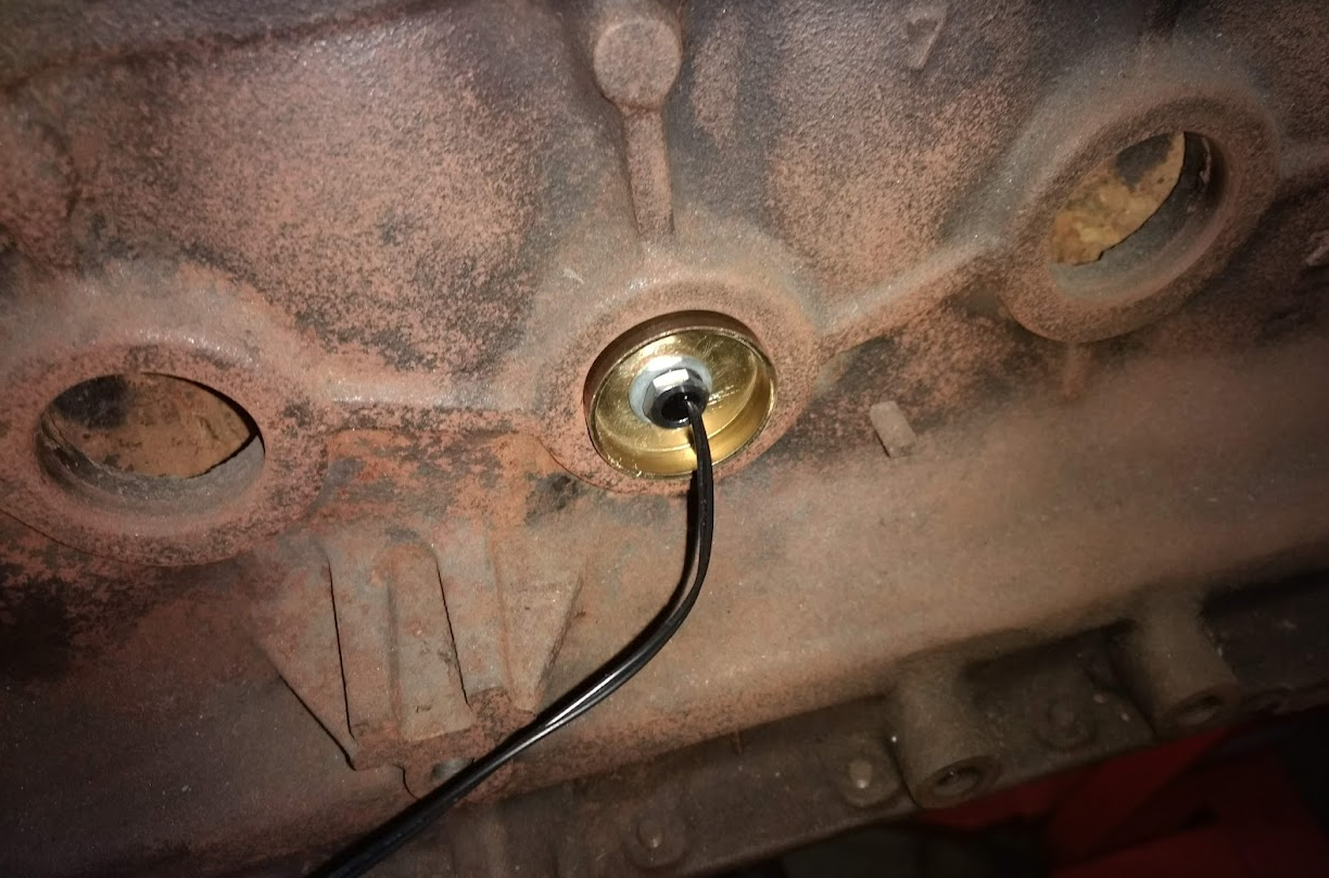

So I started fitting sensors to the coolant system in several spots today.
One on the hose leading to the top of the radiator, which will basically measure the temperature of coolant leaving the engine head, & entering the radiator.
I already have a return line, at the back of the head, which returns hot coolant to the thermostat housing.  I will fit one to that pipework, close to the rear exit from the head.  Another will be fitted at the water pump, which is attached to the lower outlet from the raidator.  This will allow easy delta T across the radiator, by sunbtracting radiator outlet temperature from radiator entry coolant temperature.  The other place, I would like to measure coolant temperature, is inside the block coolant passages. The most convenient way to accomplish that, is to tap a temperature sensor, into a Welsh plug on the side of the block. It's simply a matter of drilling a hole & tapping it, in a Welsh plug, & then replacing an existing one.  That will require the manifolds to be removed, to gain access to the three (3) off Welsh plugs on a K Series engine.
