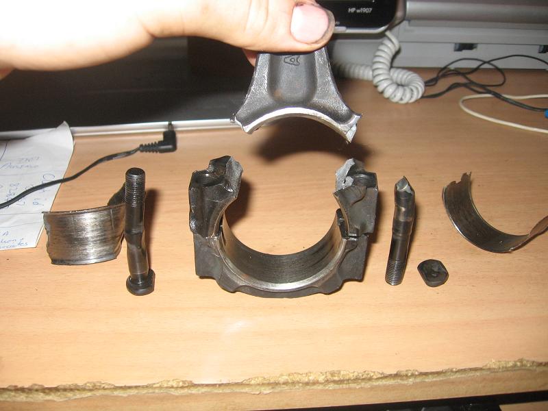

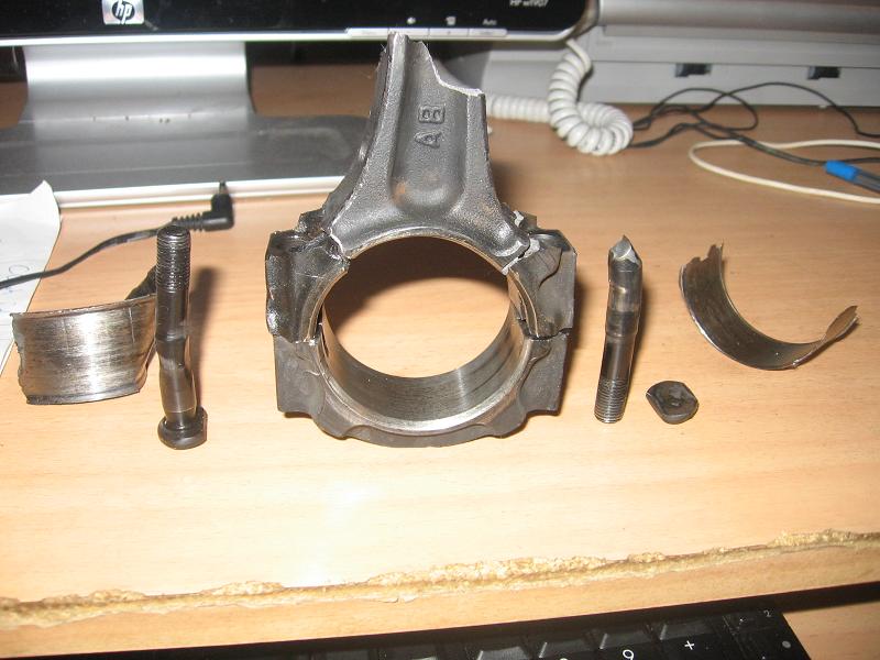

i riped the engine from the celica and took the sump off and have a look what came out ahahahahah
not good
me being no mercanic but i reccon the person that f@$ked it most probably over heated it
coz you can see its riped the bearing out and probably locked up and riped the conrod to shreds
if you look at the one of the studs had its head torn off and it looks like it got hot really hot
not good
Most probable is a bolt snapped (or the nut came off, I noticed there is no nut on one bolt and the thread looks alright. or did you take it off) , allowing movement (small at first). The conrod and bearings then smashed themselves to bits on the crank and bending and finally breaking the other bolt in the process.
If the bearing started spinning, the result can be the same, but the first scenario looks more likely.
