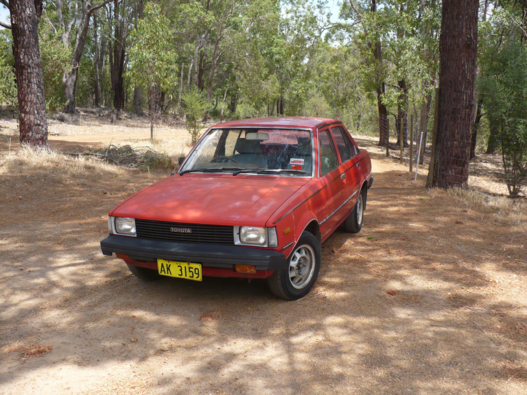

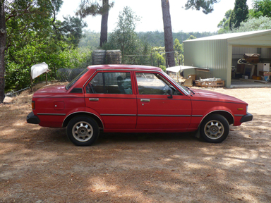

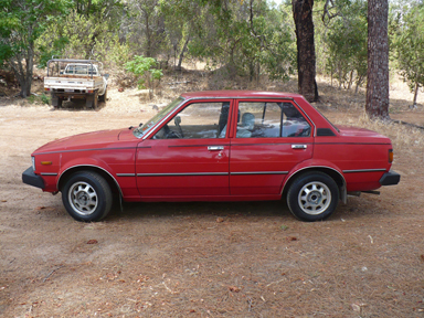

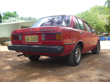

Mybowlcut Posted January 18, 2008 Report Posted January 18, 2008 (edited) Hey. I bought this little Corolla two years ago when I first got my P's. It's done 352k+ k's but it's still going. I'm currently using it for pizza deliveries and it's treated me well, but I was thinking of changing a few things or even the car... It's a 4 speed as well so it's tends to be quite noisy when down shifting and around 80km/h. I was thinking of either getting it panelbeated and getting rid of the rust and painting it. I also wanted to put one of those 4A-GE engines in it as I've read around these forums a lot that they're pretty good. I thought for a while and realised that it might be cheaper to just sell it and look for the same model that's in better condition. So I've got a few questions for you guys: - Are 4A-GEs hard to find? - What is the typical cost of getting a 4A-GE put in? - What are they like on fuel? City driving? Country? I don't know much about cars so any suggestions that get a bit technical might have to be dumbed down. :D Cheers. Edited January 19, 2008 by Mybowlcut Quote

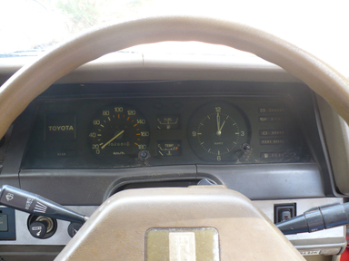

Mybowlcut Posted January 19, 2008 Author Report Posted January 19, 2008 (edited) 1. Nope, 16 valve 4ages were delivered in AE82 twincam hatches. Buy a dinged or rusted one, freshen her up and put her in. Youll have loom, computer and all accessories that way. You will need rwd extractors too. They can be a bit tricky to find. Us ebay is good for them. 2. Could be as little as 2000 dollars all up, if you do the work. If you pay someone you will still need to source the right pedal box for a hydraulic clutch, a t50 gearbox and tailshaft, slave and master cylinder and clutch line. You'll also need a motor and all accessories, rwd pipes, new exhaust, and a mod plate, efi fuel pump, and surge tank, or a Jap ae86 fuel tank, with efi baffles to stop fuel surge. 3. Very easy on fuel. If the motor is freshened up it should pull 10klm/litre if you thrash it. My 20valve does. Never owned a 16 valve but it surely wouldnt be more with a standard ecu. You have the perfect opportunity to build a tough 4age ke70, as you have one car to pull apart and one car to drive around in and get to work, while you take the other one off the road. That helps sooooooo much. More pics please!! :D Thanks for the reply. :) So I could buy an AE82 twincam hatch and have all the parts I need? Or will I still have to find everything you mentioned in post 2? I'm so glad to hear that it's good on fuel... haha. I really want to have a nice little corolla that's got a bit of power without losing too much in fuel money. Yeah you've got a point there. I guess I should hold off on selling the red one then eh? Haha. I'm buying another KE70 on tuesday for around 1500 because it's practically in perfect condition and only had 2 owners. I guess I'll keep that one off the road since that's the one I wanna do up and use ol' red for driving. :) More pics just like you asked: There's a few more in this post which I'll probably have to temporarily hold off until I get my car sorted out: linkified! I found some cheap cars which I think have 4AGE's in them on ebay: 1 2 3 4 5 6 7 What do you guys think? Edited January 19, 2008 by Mybowlcut Quote
