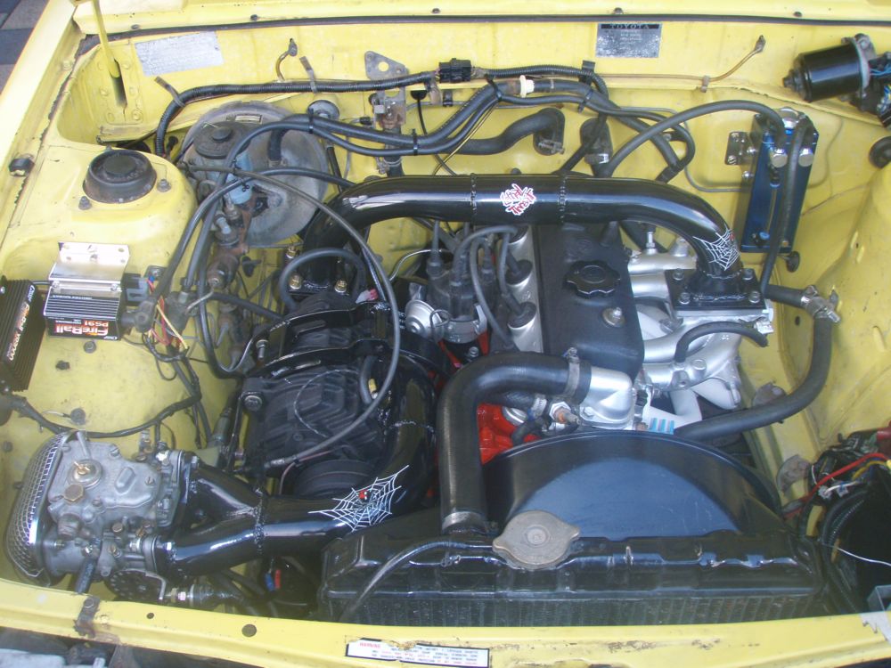

ok so here is the pic
the carby looks to me to be eatjer weber 40 or 45 DCOE side draught
I'm pretty sure that charger is an sc14
its been a long while since i seen the thread and i can't find it again so I'm just saying how it looks :)
got to say though its a real clean set up ey :)
:bash: :yes: for who ever set this up
oh wow thats a perfect example right yeah
very tidy O_O
looks like the job will be a nice head f%&^ cause i wont b able to hav my rolla of d road dat long :/
might hav to borrow a 2nd car if i really gna go through with this
hahah cheers mate
we made that setup worked great with 100kw :wink::).
ans as for internals we ran this setup for along time worked sweet no prblems no overheating either.
any more information don't be affraid to ask:D:D
Thanks Kalby
kalby that is some sweet stuff u got there
the piping looks barra man dead set :wink:
I'm just curious on the carby is it a 40 or 45 DCOE?
thanks in advance mate :(
EDIT: ohh and how much psi was it pumping?
Edited by agius

hey that was my mates set up... looked awsum
