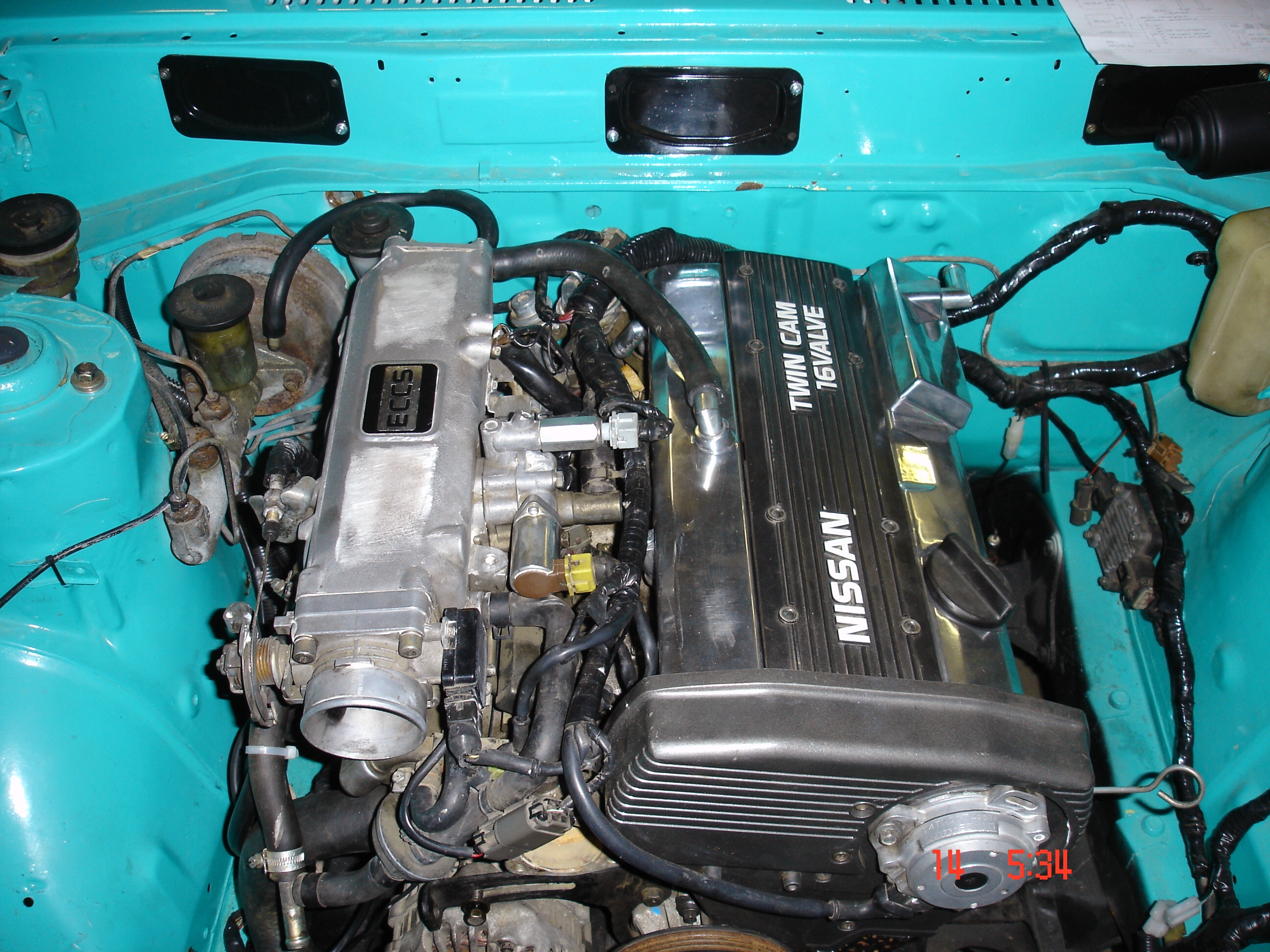

Hey guys thought i would introduce my baby as i m new to the forum
my project is almost near completion.
It is a '75 coupe Complete respray in aqua green early holden colour. Ca18/5 speed conversion. Chipped standard ecu Bosch efi fuel pump. pulsar seats speeco gauges new carpet hoodlining door trims custom panels (old cig lighter etc & shifter surround) celica wheels. Toying with waht to do it has a completly rebuilt ca18de but its built to handle 10psi. Interested to see what it ll be like n/a but also have t25g and manifold ready for it and a mircotech ltx-8 for when she gets boosted. only thing is if i go n/a straight away i need to get new zorst when i boost her.

This is a pretty clean thing! Getting used to the color.... but very clean to say the least...
Keep it up dude :cool:
Edited by Tiger
Thanks for posting pics mate.
Have to get some more pics on sat when i get camera back. Colour grew on me too. Was a bit suss on it but love it now.
