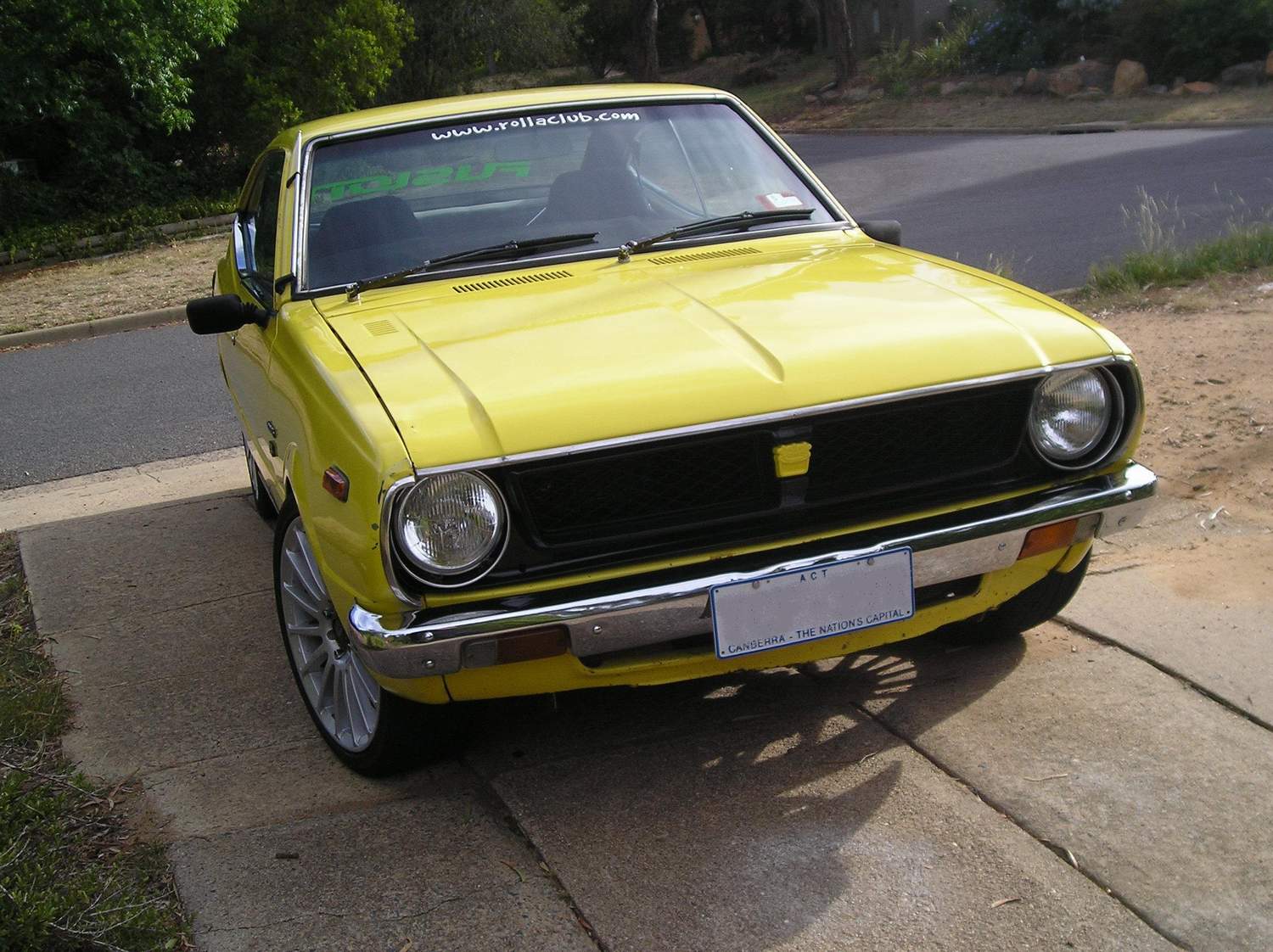

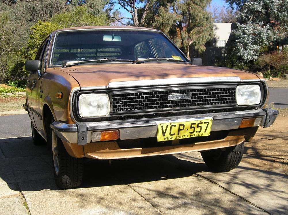

September 7, 200620 yr comment_139446 Yellow car is my KE35 coupe, Brown car is a square headlight KE55, but it has the early KE55 bonnet on it, like your car does Report
September 7, 200620 yr comment_139493 I just looked back through your thread, that is also a KE55 rear bar on your car Report
