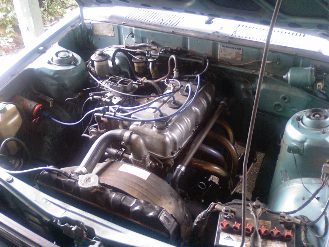

I'm sure you mean 3T-U. My dad put a 3T in my KE70 when I moved on to a AE71.post-8643-014803600 1285057775_thumb.jpg
