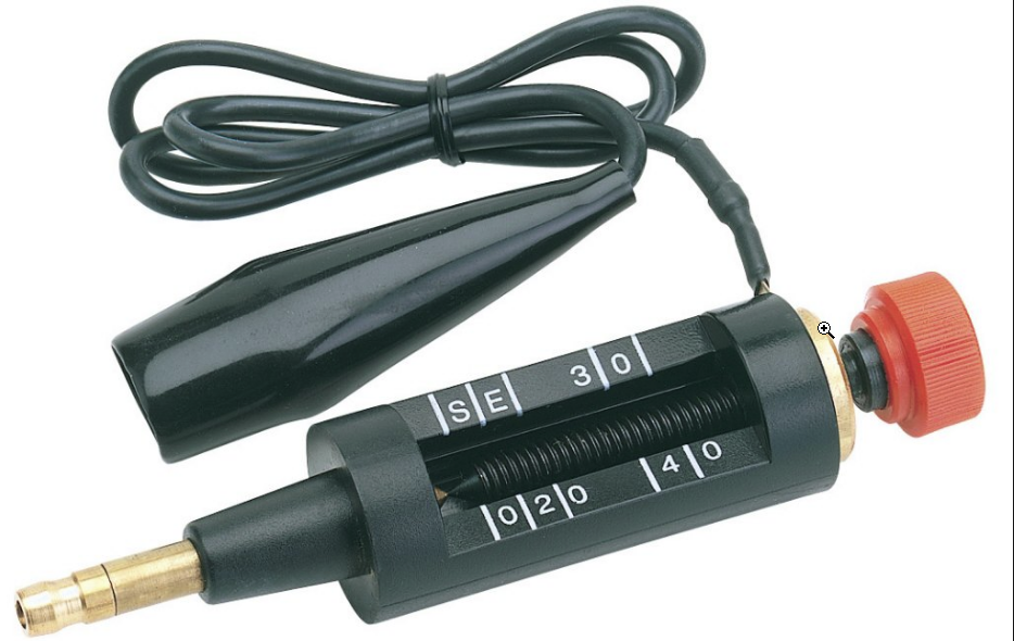

  1. Hi Jeremy, Let me explain it another way. The primary & secondary resistances have really nothing to do with whether a spark generated by that coil is weak or strong. Yes coils can break down, but I'm not talking about used ignition coils; I'm referring to new coils. The coil with a primary resistance of 3.0 ohms can deliver the exact same energy as a coil with 1.5 ohms. It just takes longer for the coil to charge up. Yes, if you have a V8 doing 10,000 rpm, you have very little time between firings, to charge up the coil for the next firing, so may need a low primary ohm coil to make it charge quicker. We are talking here about a 4K engine with half as many cylinders, and half that sort of revs. It has plenty of time to charge up a coil with a 3.0 ohm primary. GT40, no ballast resistor… 14V / 3.4 ohms = 4.1 ampsGT40R 1.4 ohm with 1.6 ohm ballast resistor… 14V / 3 ohms = 4.6 amps As far as the secondary resistance goes, the voltage developed by the coil, is only as much as needed to jump across the spark plug gap. It you close the gap right up, a spark can jump it with probably 2-5K volts. In a working engine, under pressure more volts are needed to jump the gap, but any coil capable of around 20K volts will suffice for our humble Rollas. It's only extreme performance cars that may need potential voltages like 30K - 40K volts to fire a spark. I have a little spark gap here on the bench, you can buy on ebay for less than $ 5.00, that allows you to increase the gap until it won't spark. The rough scale on the side tells you what the voltage is to jump that gap. At 30K volts the gap is 20mm wide ! The indications of a good strong coil, is one that produces a spark that is bright blue/purple & white in colour. A weak coil, is one that produces a very yellowy spark colour. Yes, there are weak coils. One of the big dangers with coils is operating them without a spark gap, which can lead to breakdown inside on the secondary winding, which has a lot of turns of fairly fine wire. Don't forget there other things in the secondary of the ignition coil that can create weak sparks. The main culprit is bad HV dizzy leads. P.S. As a rule of thumb, a good coil should produce a clean sharp bright purple spark with an average dwell time (charging time) of about 3 milliseconds. If you are getting a weak spark, I'd be looking at other things in your system, than just the coils specs. Cheers Banjo
