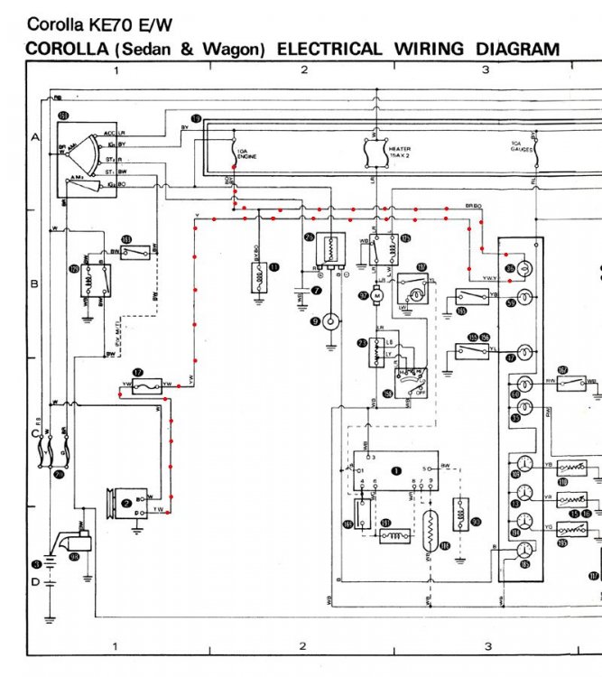

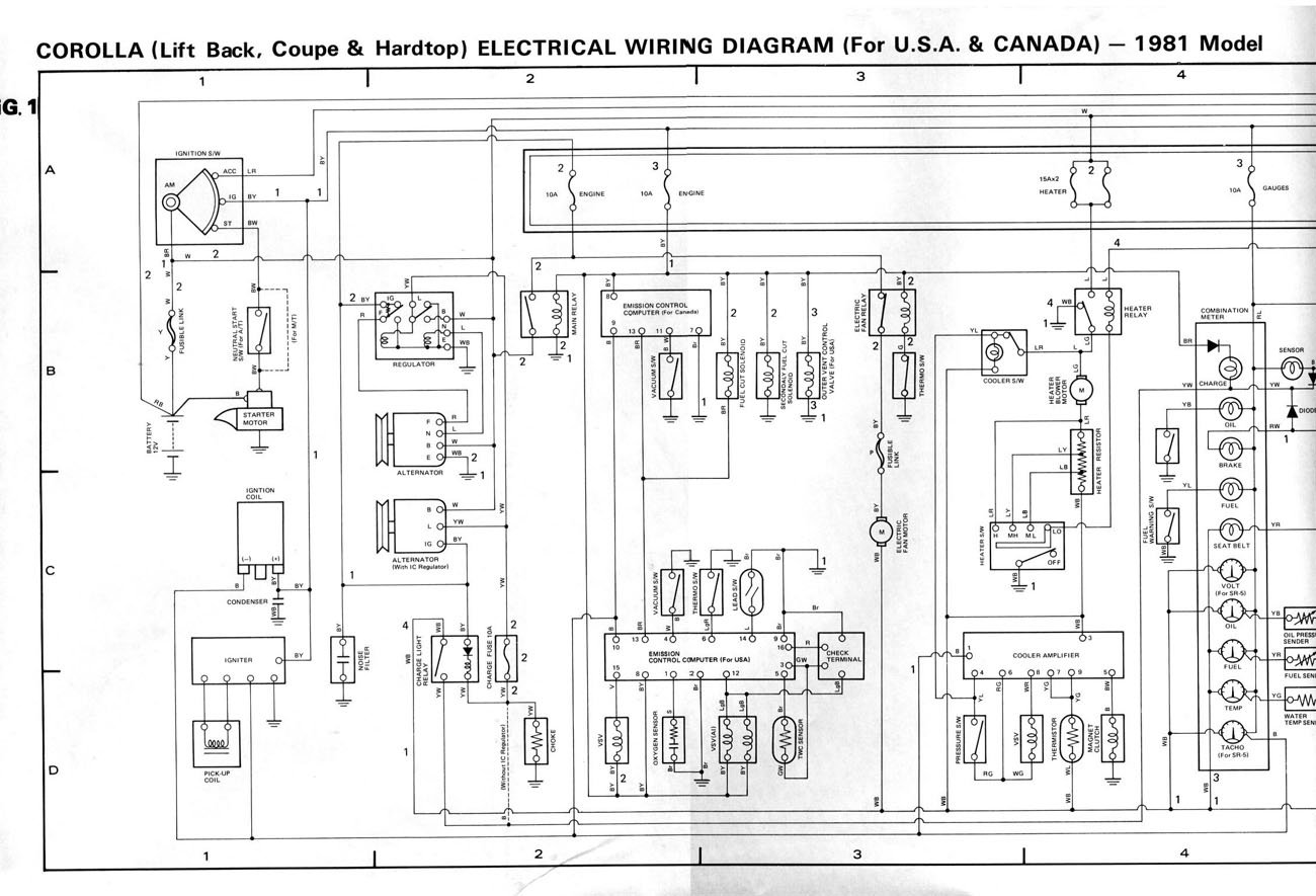

  1. No, the battery should be fine, it is not in the ignition light circuit. Was it a new alty or a reco, or just one out of another car? It sounds like the alty is charging OK, maybe its a wiring issue. The charge light circuit looks like this- or like this- which shows both internal & external regs. Have a read through this too- http://wilbo666.pbworks.com/w/page/39441708/Toyota Alternators
