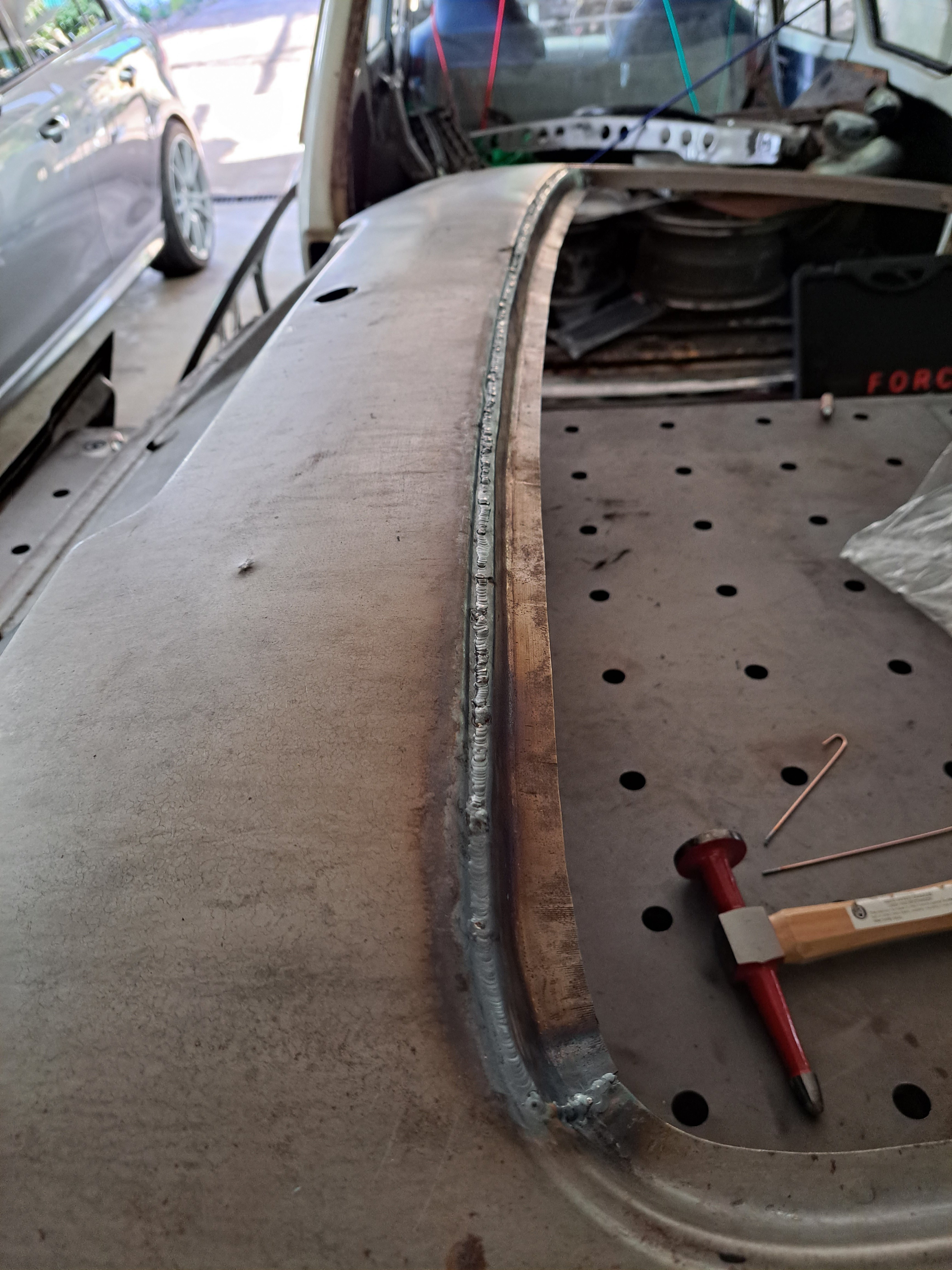

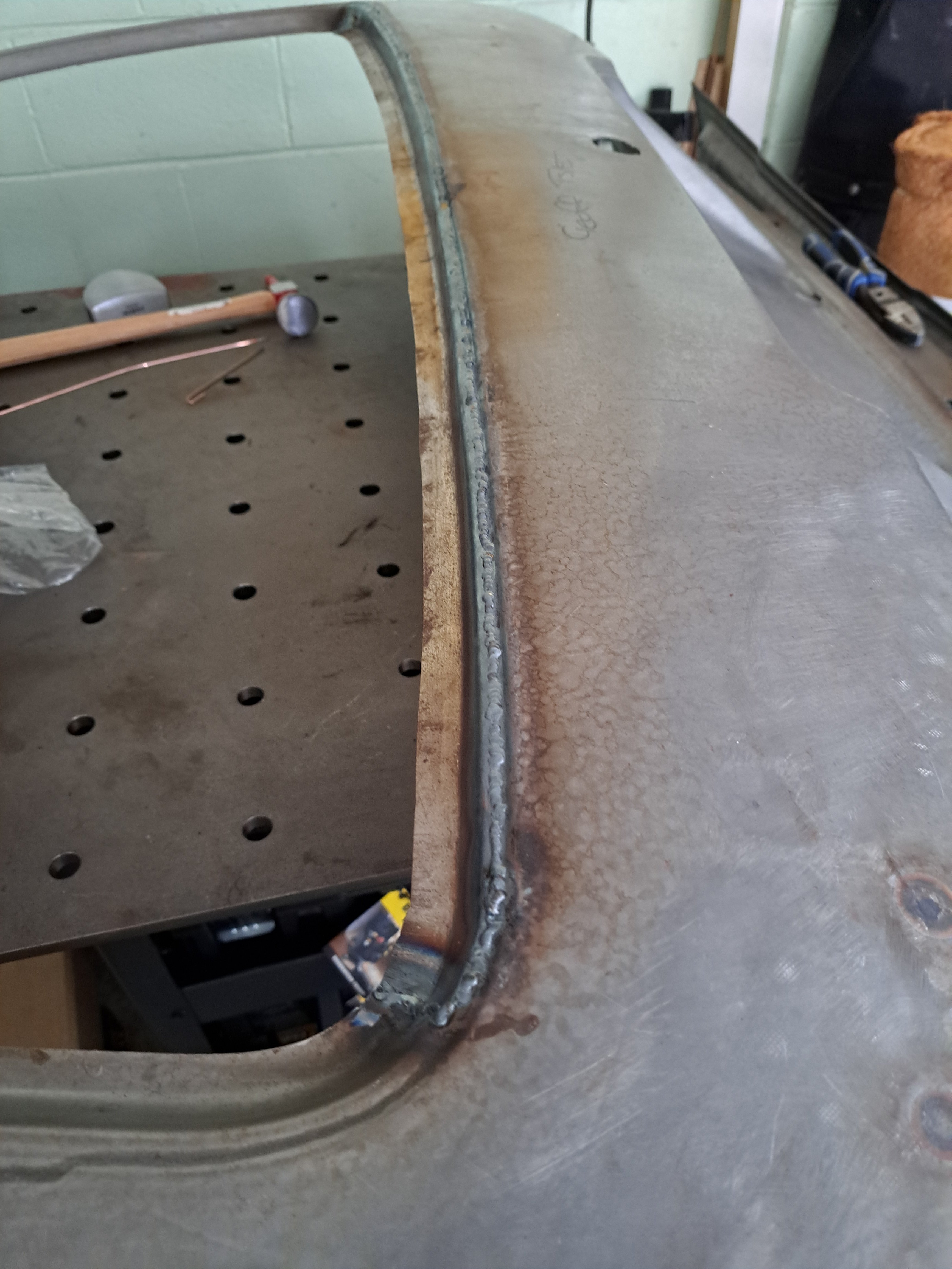

  1. And then the window sill was welded into place The weld started well, but then there were sections where the parent metal was still corroded so I had to fill large gaps with filler rod But now the main welding is done I'll linish things back and straighten the weld area.
