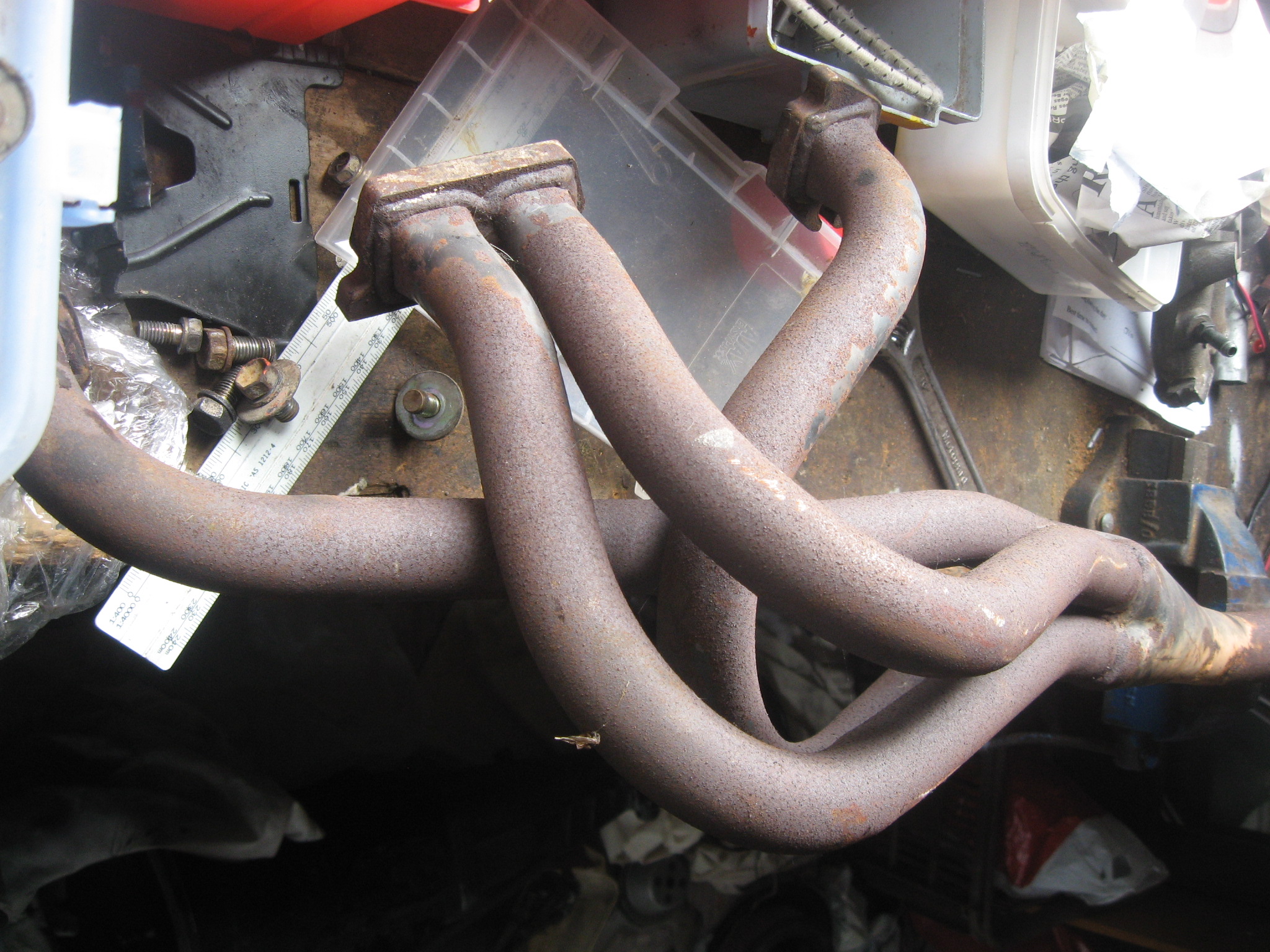

  1. Has anyone twin turbo'd a k engine? i have 2 subaru turbo's and it could be a bit of fun making up a mani for it. Is there much difference in response with twin turbo setups? What about a draw though twin turbo setup with a su to each turbo? Ive got a pair of extracters for sale if anyone in nz wants them $50

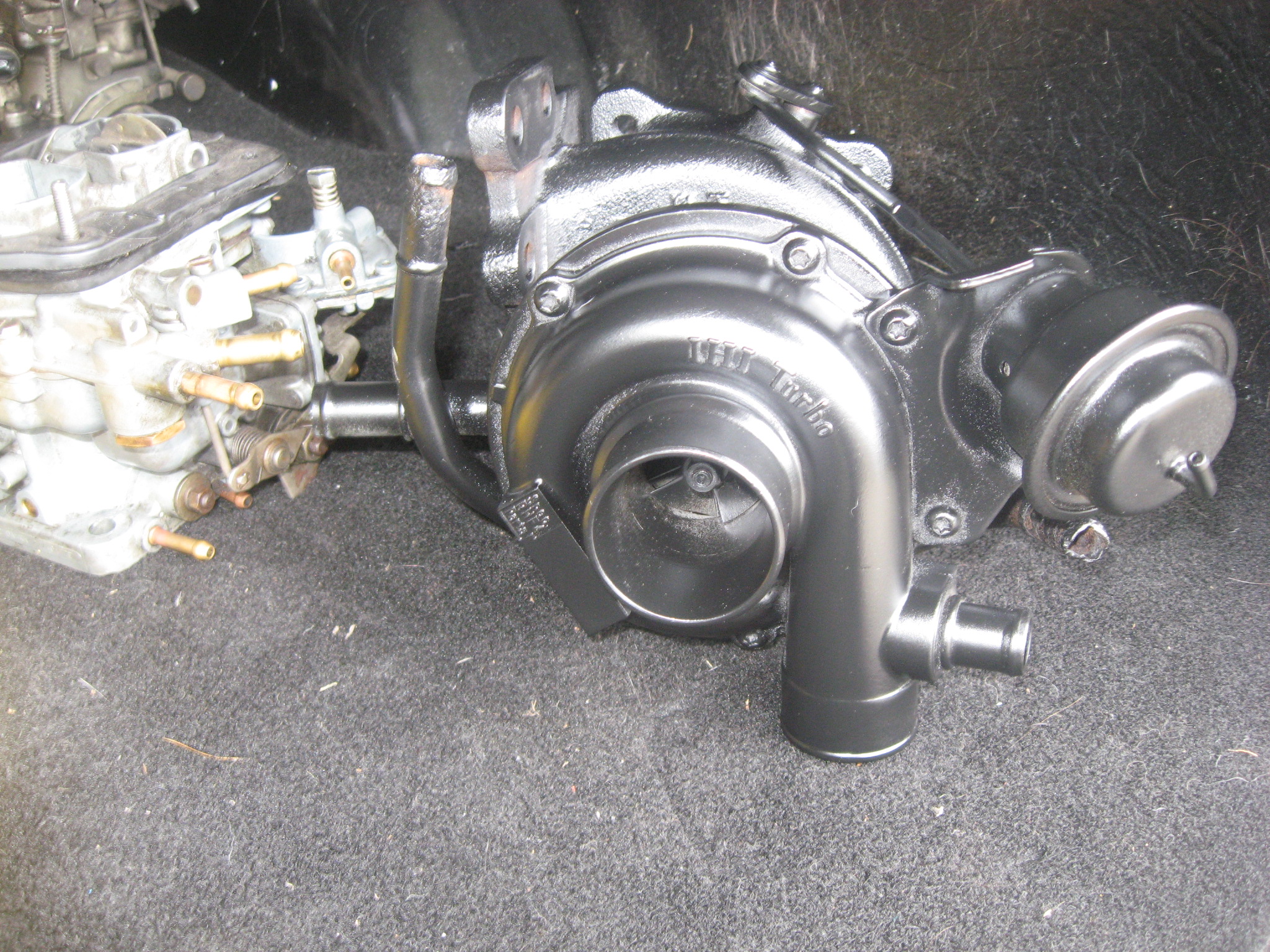

  10. Standard head. Just ported and cleaned with faced falves and custom turbo cam. Will be running 10 psi. Need to find some forged pistons. I am in process of making manifold and turbo manifold. Will put more pics up tomorrow.

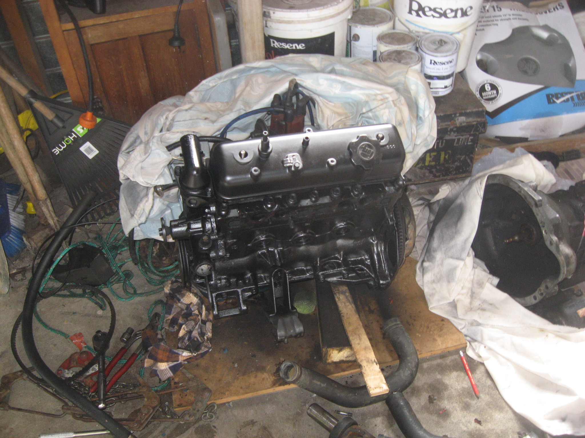

  11. Heres a few pics of my 5k turbo ke70 wagon project 5k engine big turbo cam ported head valves faced shimmed head new gaskets a12 push rods 32/36 weber carb rising rate fuel regulator vl fuel pump tdo4 turbo r32 intercooler ae86 adjustys reset and added leaves 13x7 dished rims more photos to come
  12. Is that a r32 intercooler your using?
