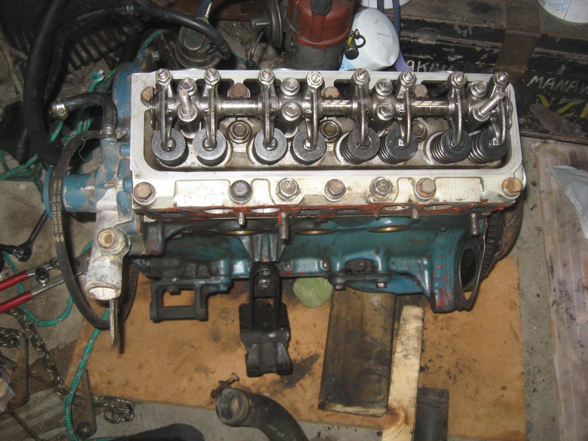

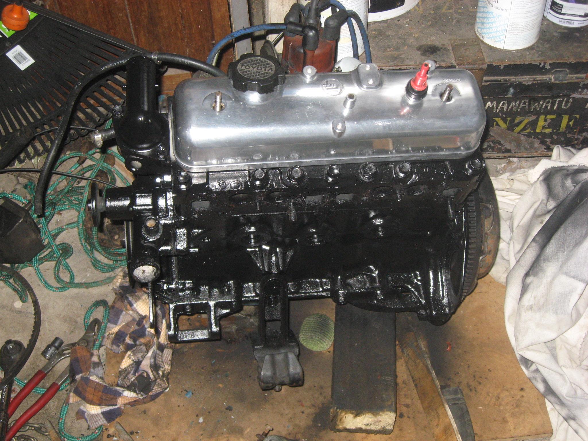

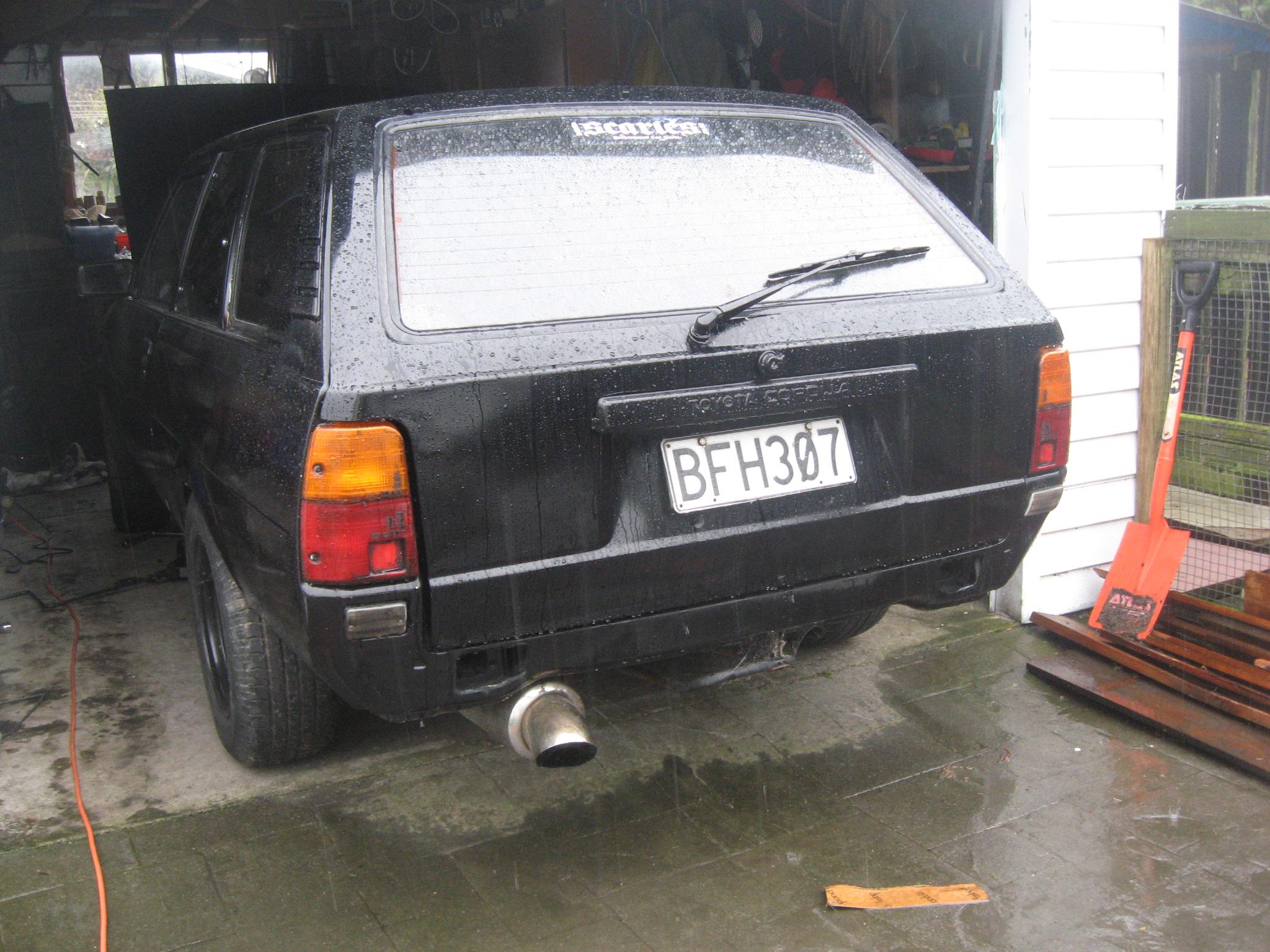

Heres a few pics of my 5k turbo ke70 wagon project
5k engine
big turbo cam
ported head
valves faced
shimmed head
new gaskets
a12 push rods

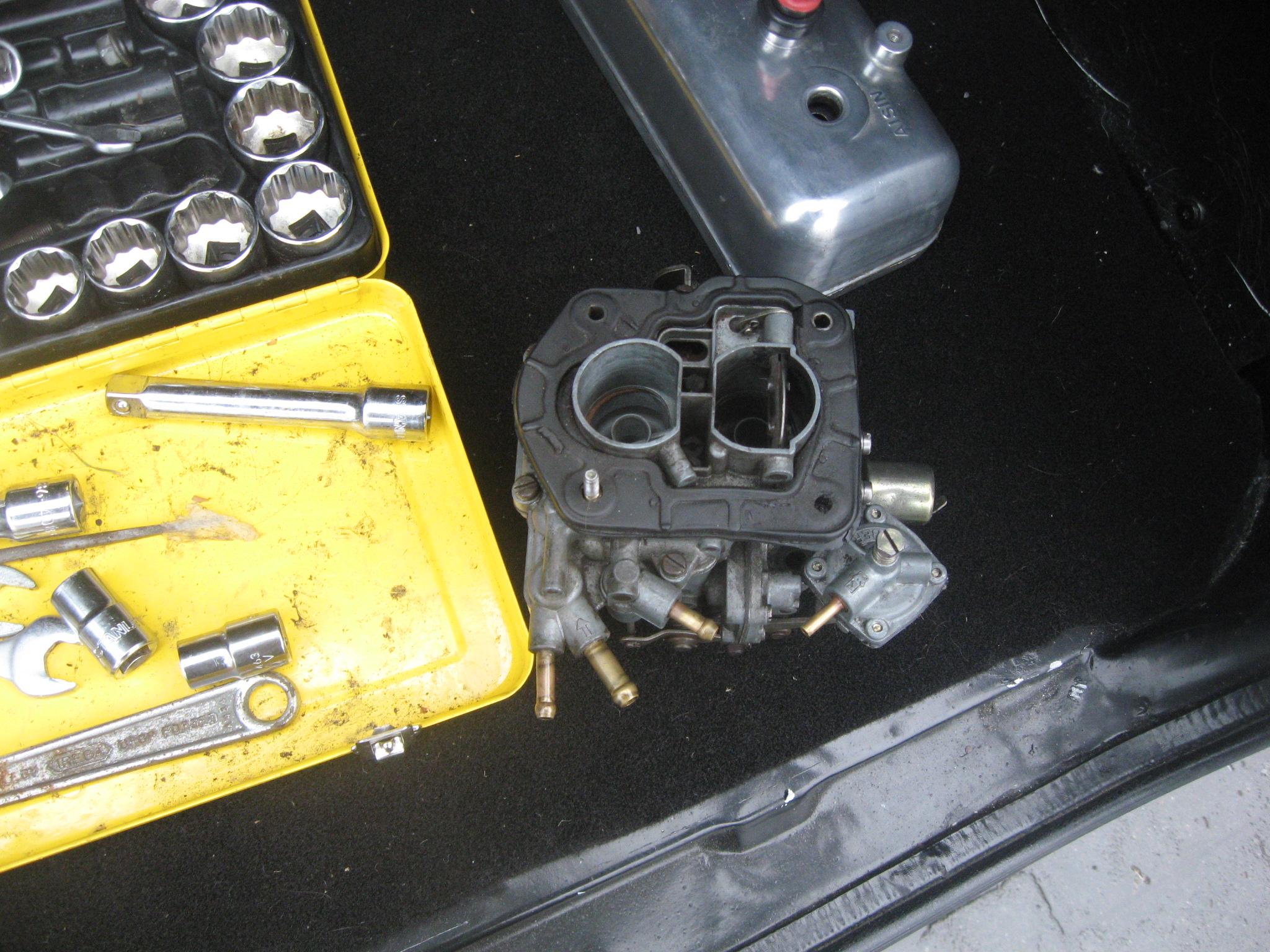

32/36 weber carb

Standard head. Just ported and cleaned with faced falves and custom turbo cam. Will be running 10 psi. Need to find some forged pistons. I am in process of making manifold and turbo manifold. Will put more pics up tomorrow.

BTW, what is that weber mate?\
i don't believe ive seen one like that b4

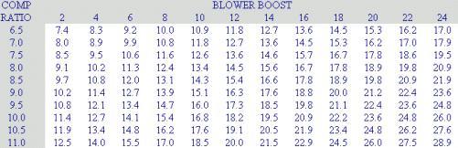

so you not going to lower compression of the engine?
tryed to make one but couldnt figure out how to change it to rides.
Its a 32/36 datra weber
whats happing with the dizzy?
Had a 4k turbo and went well with standard compression once it's running i'll see if i want to lower compression do you think it will make much difference? I'm going to get dizzy regraphed to suit turbo.
Will go hard without you lowering the compression but then reliability comes into play .
This could be of use for you working out compression with boost
what lifters are you using?
Oh yeah if i put a 4k head on the 5k would that lower the compression enough. I'm using 202 lifters with a12 pushrods.
That's what I used, they love boost! maybe a bigger needle and seat, dyno tune and you're set. ;)
Yeah used a similar weber on my 4k and went good. Love your ke it sounds so sick!!
