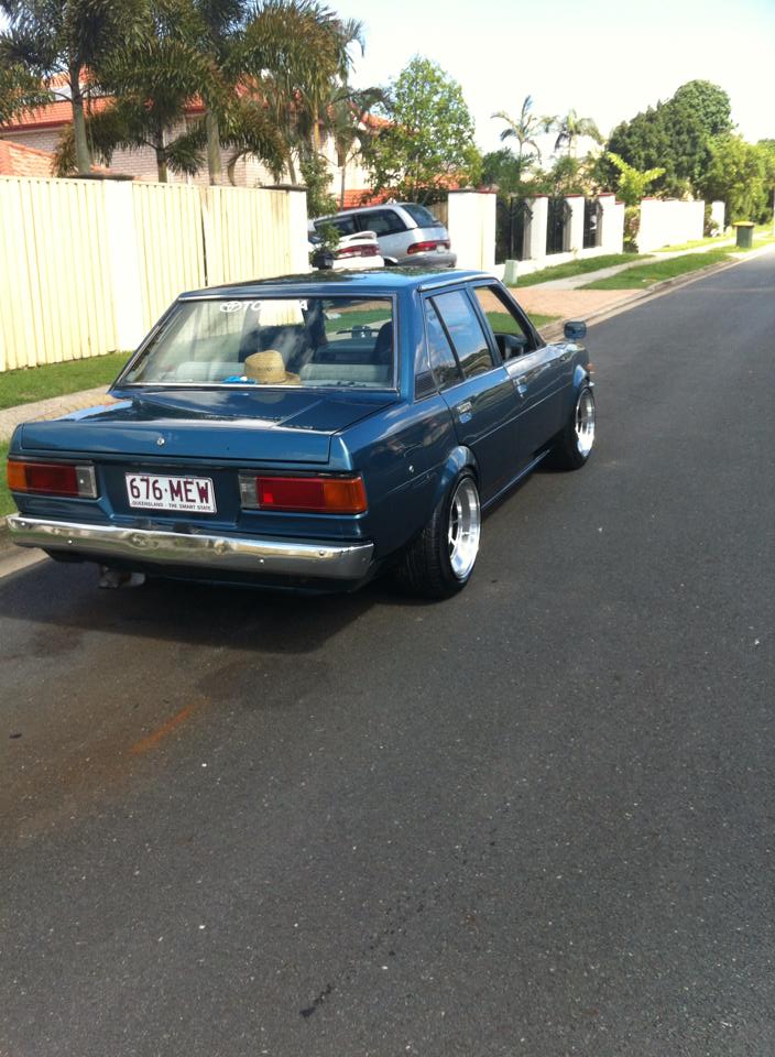

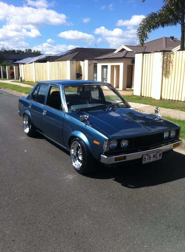

still rocking your quads dave :) haha and offset fronts are 15x8 -0 rears are 15x9 -0 -

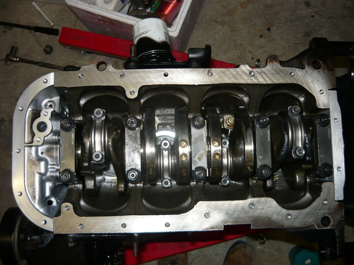

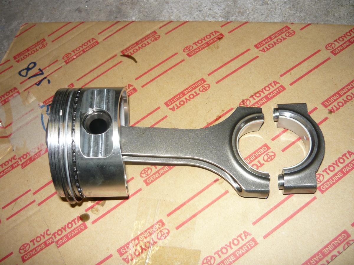

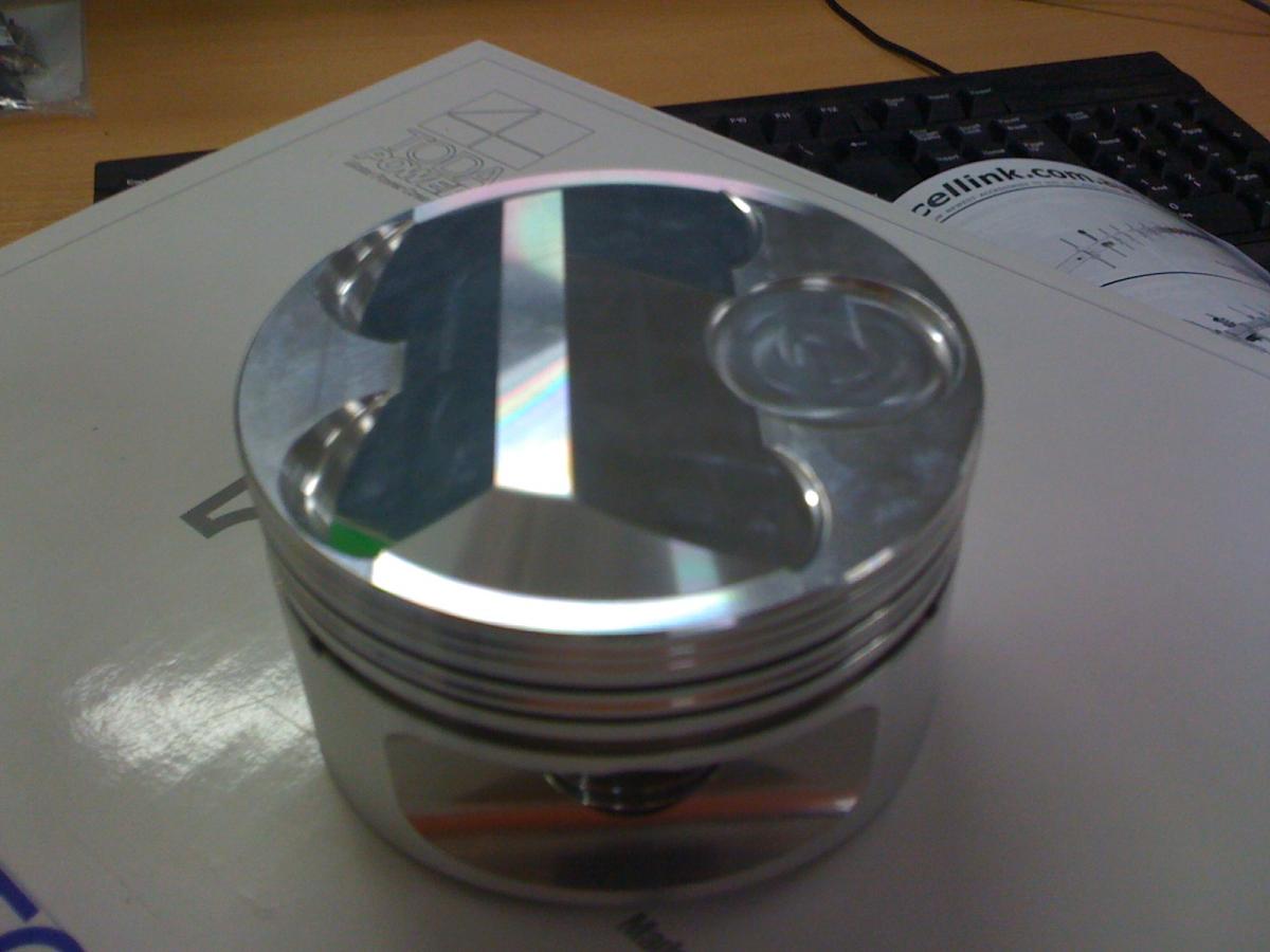

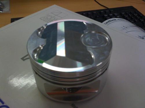

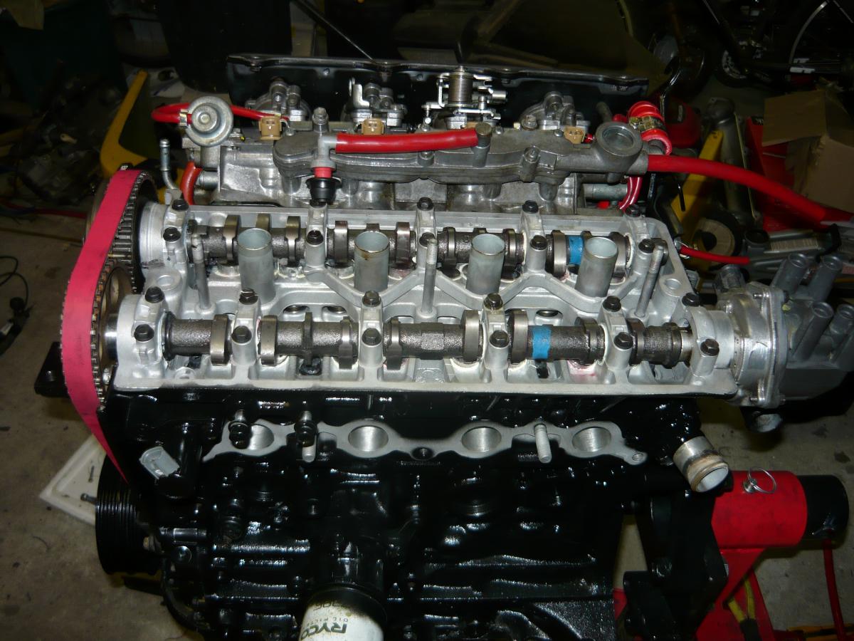

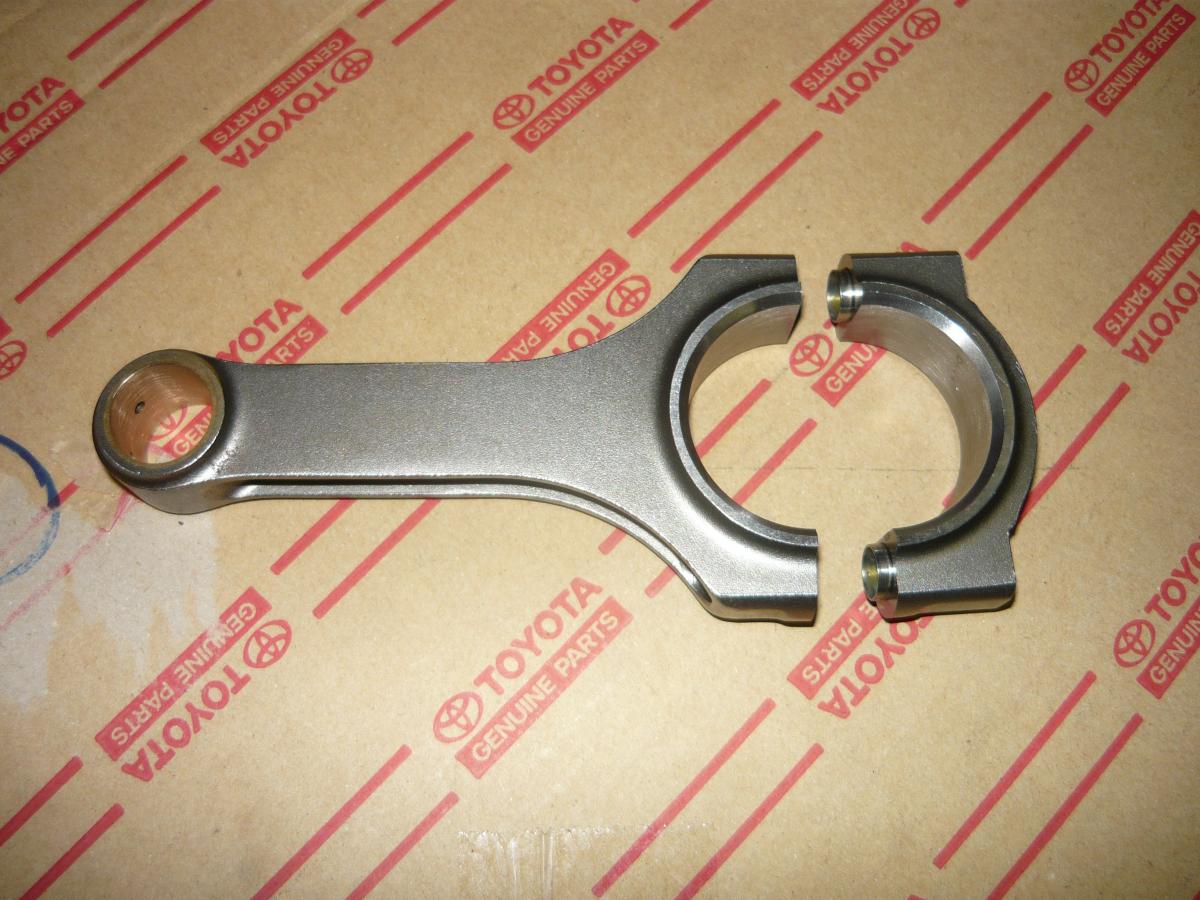

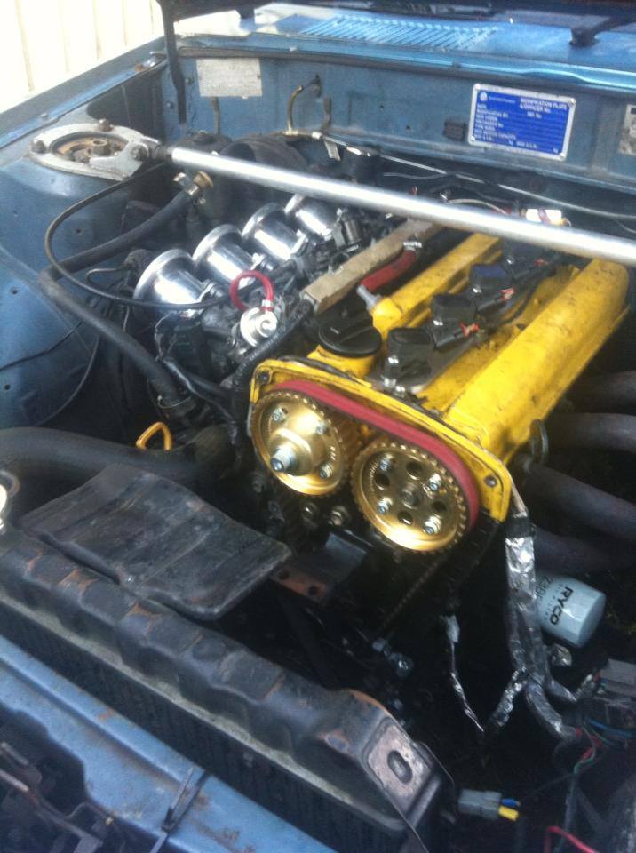

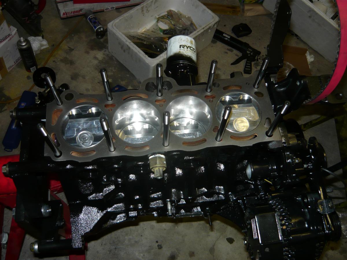

since i got daves old 70 it had a blown motor bad paint dings rust etc... the guy who dave sold it to didnt take care of it at all.. so this is my build thread : :) 4age silvertop 20v the rebuild is as follows (hopefully i included everything) : toda over sized high compression forged pistions C/R 12:5:1 H beam forged condrods ARP head studs ARP crank studs Kelford 194-C racing cams Toda racing adj. cam gears Full head reco port and polish Supertech 1mm over size valves Supertech racing vavle springs Tomei crank caps TRD 0.8mm multi layer metal head gasket TODA timeing belt 1zze Coilpacks ALL ENGINE PARTS BALANCED ITB'S (trumpets) + all RWD conversion parts Fuel system - Bosh 070 internal pump Bosh 040 external pump surge tank other mods T-series diff with TRD 2way + 4.77 final drive Haltech PS1000 Fully adjustable coilovers with camber in front AE86 9KG springs on the back T50 Gearbox Fully adjustable recaro racing seat jdm ae86 calipers, 2022, dba slotted rotors. QFM brake pads ADR approved braided hoses. Quad head light setup (Daves corona made) 2 1/4 inch exhaust with 2 resonators and 2 sausages (no exhaust noise, only motor GRRRRR ) 4-1 extractors Fresh Paint, No Rust, No Dints, UBER UBER pumped rears to fit 15x9 -0 hope you like :D iv got heaps more pics of the engine build, cbf uploading but you get the juice of it :) vroom vroom -
