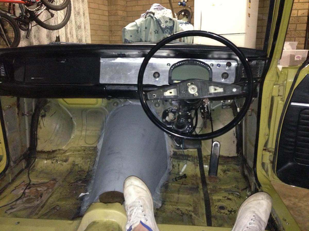

  19. Bit of free time today so made a rough dash to see what needs done then make a final good one but happy enough with this outcome, will wrap it in black vinyl and should look ok.

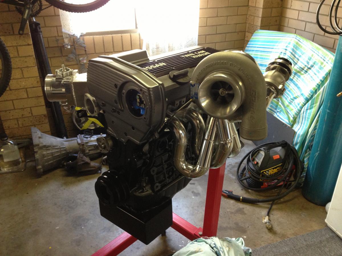

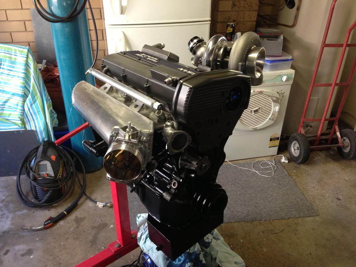

  22. Painted engine other day, going for the stealth look with all black fittings and hose too, must be the new in thing. Cpc plenum (Another Ariel masterpiece). My home made exh manifold. Can't wait to spool the t67.
