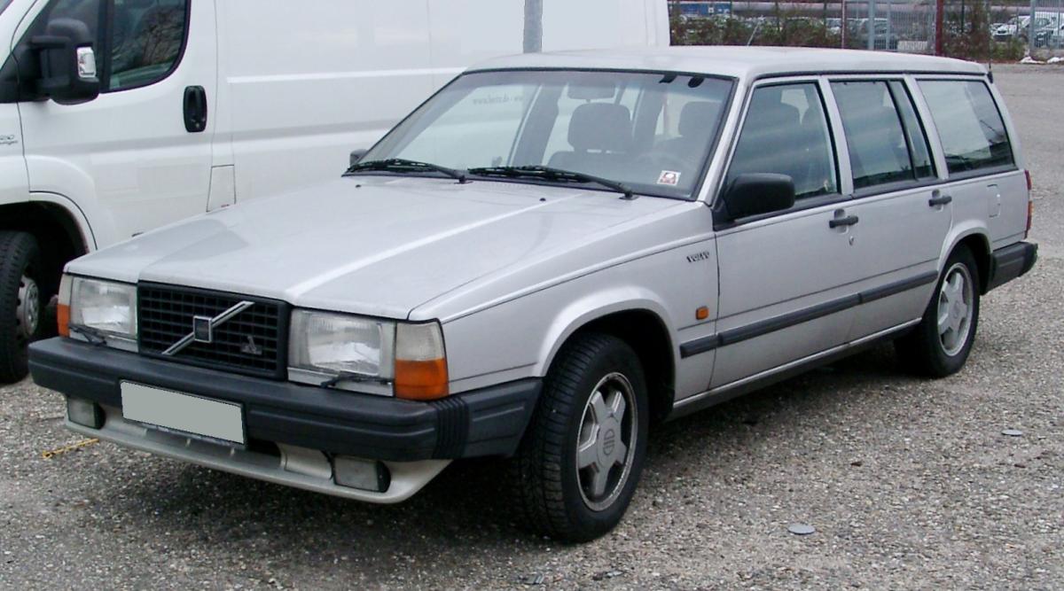

Has been a couple of weeks so a little bit of an update. I've only really been fidling with things. Got the original radio working. Reception is terrible but its a cool piece of originality. My main project at the moment is a front lip. I have not heard of anyone using one but I am trying to modify a volvo 740 front lip to fit the very different shaped 55. This is the lip i have And here are some pics of it taped to the front of the car. It is obviously going to be too wide so i will need to cut and shut it, as it turns out the centre of the three holes in the middle is the exact width i need to remove. Could be a little fiddly and require me to crack out some fibreglass and cross my fingers but i think it should come up ok. I know the pictures are average but i assure you once it is done i will be getting the good camera out to update properly. Also Fog lights will be going on as on the volvo above. Just got to round up a set Still on the hunt for a 2tg if anyone has one sitting in the shed :yes:
