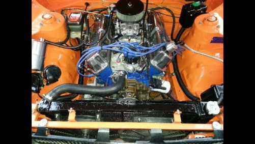

Mechanical Sympathy Posted January 13, 2014 Report Share Posted January 13, 2014 You really need to talk to one of the engineers linked above. Thought are that it's really hard for us to say - has the conversion been carried out to a high standard? How is the roadworthiness of the vehicle generally? Is it a stripped out, matt black, cig lockered hose beast with a 3" side pipe? That Windsored '35 coupe on Ebay was awesome. A 289 looks much better than a 1UZ imo. Link to comment Share on other sites More sharing options...

MIKE KE55 Posted January 15, 2014 Author Report Share Posted January 15, 2014 That was it mechanical sympathy, Damn fine looking transplant. Damn fine. Link to comment Share on other sites More sharing options...
