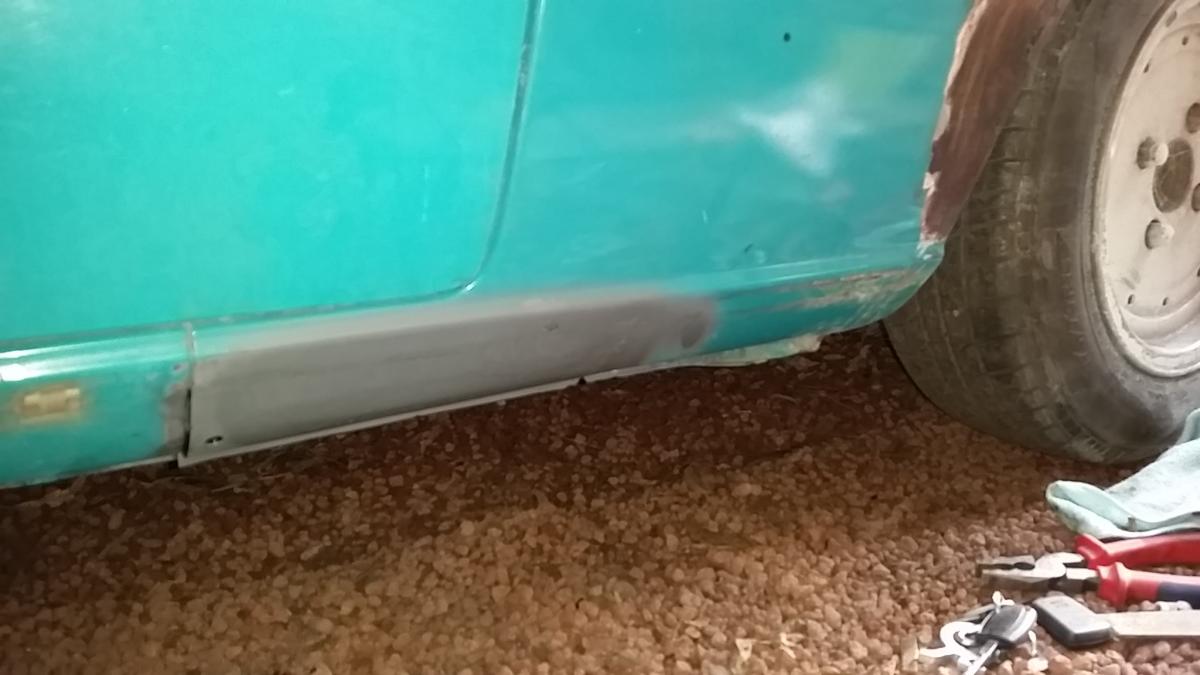

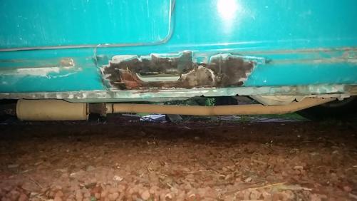

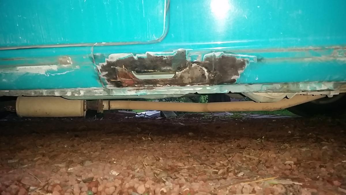

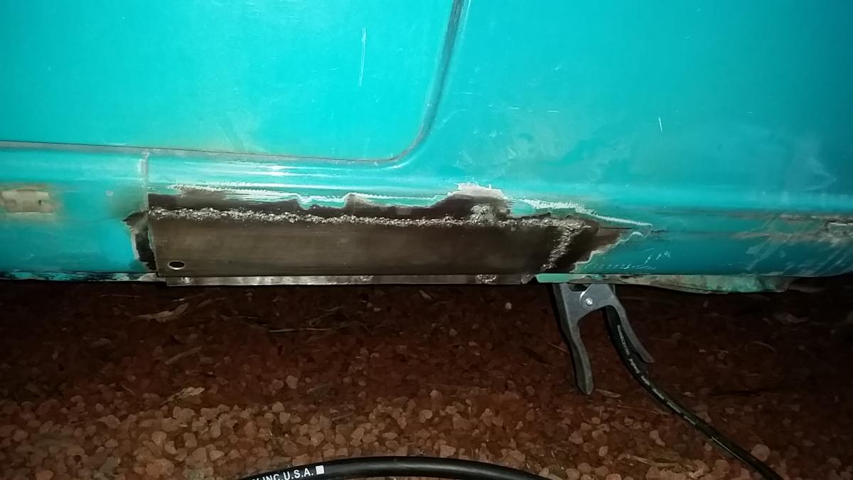

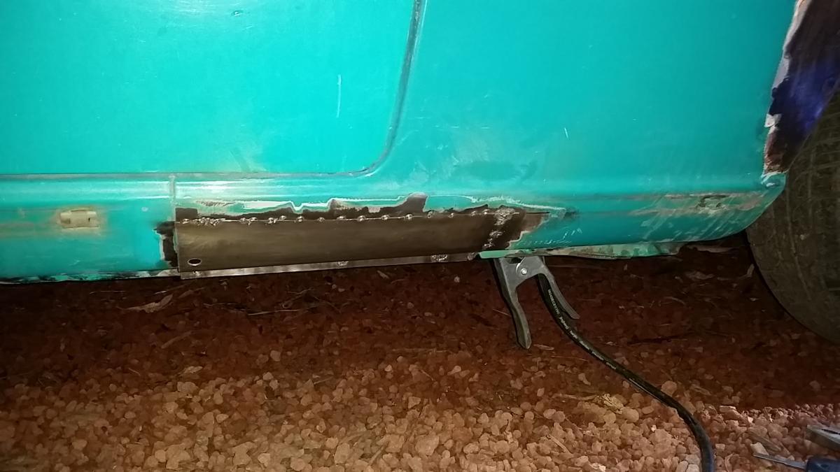

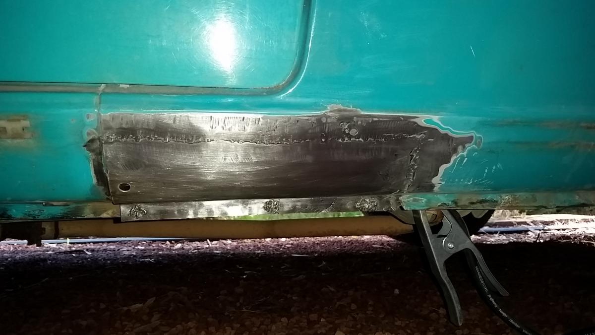

    I had a whole message typed out but lost it so here is the short version. Recent purchases. 2tg with 222 head The matching side draughts Freshly ported manifold T50 with Exceedy HD clutch Lightened flywheel Ke35 rolling shell for panel sections Not much had been happening till yesterday. I decided to start rust repairs on the passenger sill. I'm not great with a welder and haven't had the cash to get gas set up for mine so gas less mig was the only option. I folded up the patch panel from flat steel. It hurt to cut up the coupe but it had to be done. The pics below show how it was done. Not the best looking job ever but I'm happy with my first attempt. Cheers Bos

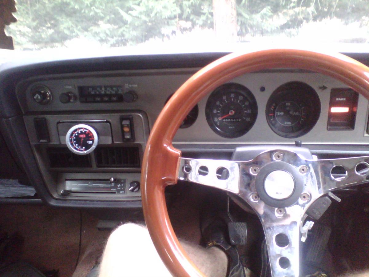

    Another little update. Gave the car a little tune and modified the throttle position to raise the idle RPM. There is a bit of a flat spot down very low so now the idle sits just above that so its a bit tough to take off smooth but no issues driving. Feels really nice. My main update has been the addition of a Tacho. I was completely against the idea of having a Tacho as i want to keep the dash looking as original as possible. I did however come up with a set up which ticks all the boxes. I have mounted the Tacho into the front of the ash tray. this means i am able to remove the Tacho, unplug the back of it and put in an original ash tray. It needs a little neatening up and ill have to sort out some paint but it works well. I reckon it looks alright where it is sitting. More updates too come. Possibly Some Engine news coming shortly. :thumbsup: Almost forgot. I also got my Speedo working again. Wasn't a massive issue but legitimizes the car a little.

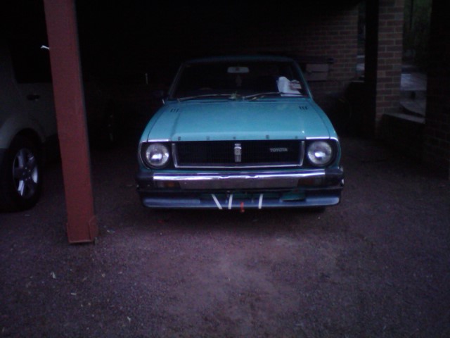

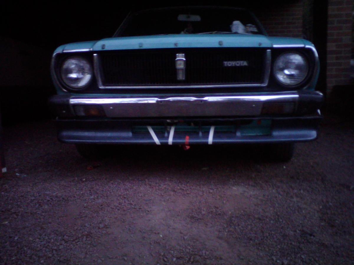

    Has been a couple of weeks so a little bit of an update. I've only really been fidling with things. Got the original radio working. Reception is terrible but its a cool piece of originality. My main project at the moment is a front lip. I have not heard of anyone using one but I am trying to modify a volvo 740 front lip to fit the very different shaped 55. This is the lip i have And here are some pics of it taped to the front of the car. It is obviously going to be too wide so i will need to cut and shut it, as it turns out the centre of the three holes in the middle is the exact width i need to remove. Could be a little fiddly and require me to crack out some fibreglass and cross my fingers but i think it should come up ok. I know the pictures are average but i assure you once it is done i will be getting the good camera out to update properly. Also Fog lights will be going on as on the volvo above. Just got to round up a set Still on the hunt for a 2tg if anyone has one sitting in the shed :yes:
