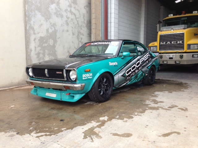

  1. My baby Ke55 3sge BEAMS turbo improved production car

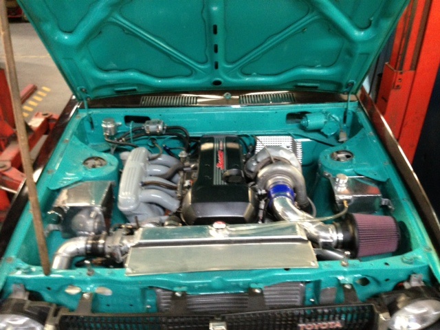

  2. Started to build exhaust manifold using old 3sgte to mock up Time to rebuild t5 Moved the starter to driver side More to come..

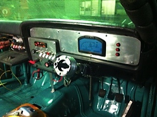

  5. Well what weekend, first time out with the new setup and engine felt great. With very old tyres still managed my best time and was 15 kph up on top speed. Had a play with the new dash tonight and all looks good on the logger. Bring on may 18 and the new a050 tyres....can't wait.

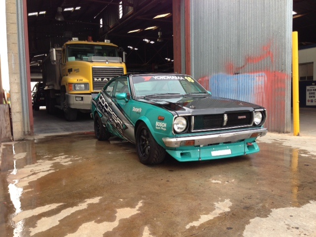

  7. Opps hit button twice sorry guys
