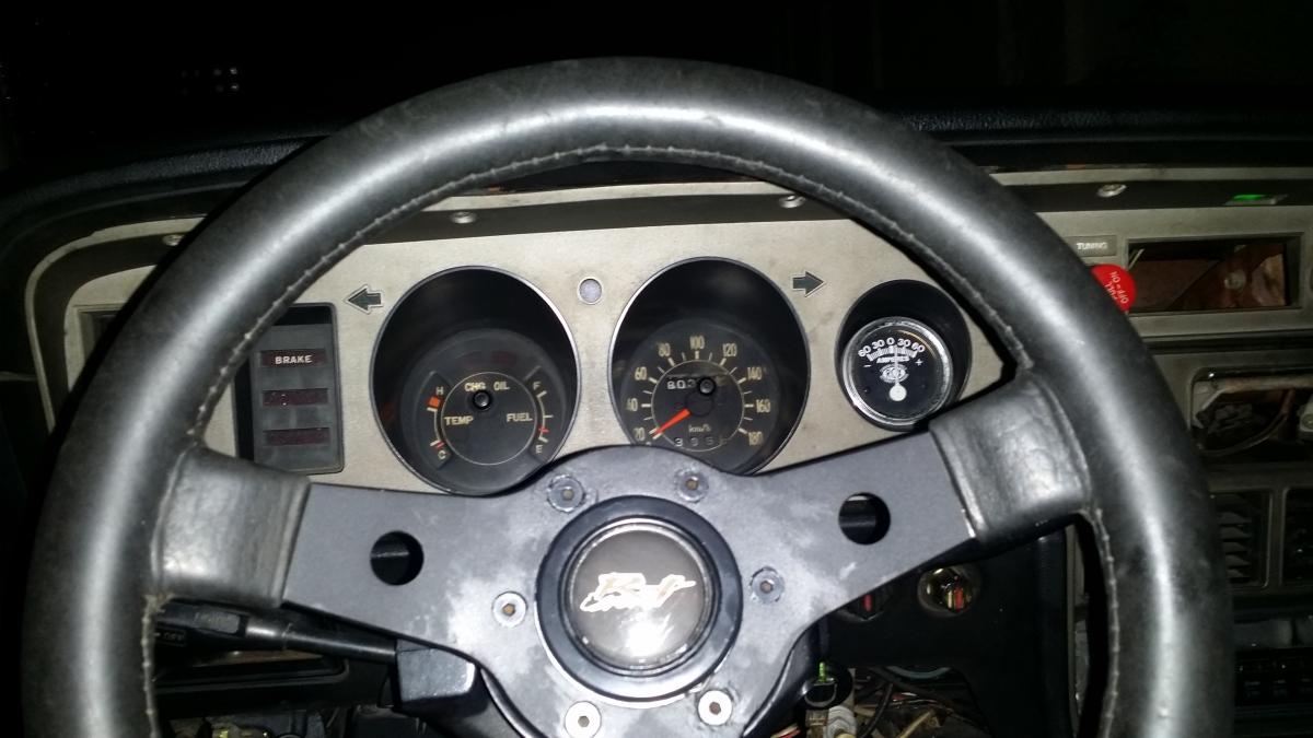

    hey thanks! i don't have one but i would grab a unit tomorrow coz i'd need it when i intall some gauges. UPDATE: looks like it resolved itself... i think there's a ground somewhere so hunting i will go :clover: :clover:
  6. Hey guys! Suddenly i noticed that my ammeter is reading +30 when running and about +10 on idle. I always see the meter at 0 so i got worried. What are the possible scenarios that caused this and should i be alarmed? I ran the car for about 20mins and its still the same. Cheers!
