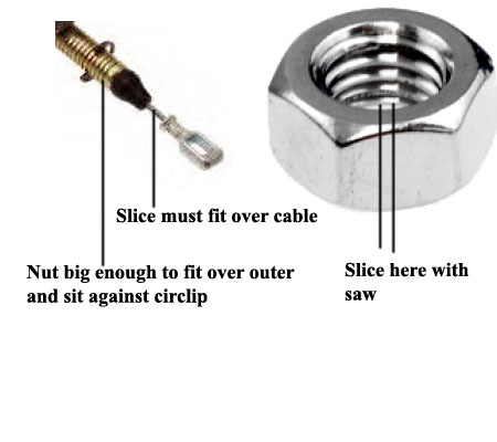

Take a large steel nut with a hole large enough to fit over the outer cable and cut a few mm out of its wall. The you can slip the nut over the cable wire and put the outer cable though it. That will act as a spacer between the firewall fitting and the cable circlip.
If that spacing changes the clutch pickup correctly you know the cable is too long.

Sorry, it was hard to describe in words-
Here is where you slice the side of a large nut, and then it forms a spacer so you can adjust the cable more.
this looks like a great idea! time to get the dremmel back in action. i'll do this. thank you!
