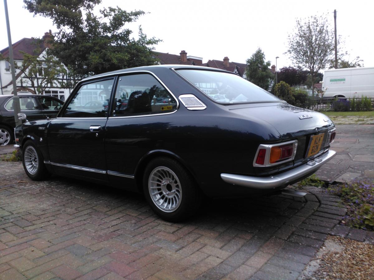

  4. Been knocking around the Forum for a few years now since joining to discuss my KE20 4AGE engine version that some of the older members may remember. Well believe it or not I eventually had a fast road spec engine built here in the UK by Macer Sports. With the engine I swapped out the 4 speed gearbox for a late T50 5 speed. Having great problems here in the UK sourcing a propshaft sleeve to fit the T50 output shaft. I am now looking farther afield as i need 21/22 spline fitting as my T40 had a 19/20 spline output shaft. Does anyone have a spare or know where I can source this part? Thanks in advance folks. PS here are a few pics of my progress after about 5 years!

  22. Finally got my car riding just how I wanted it. In the end I lowered it by using 1.5 inch lowering blocks on the rear for a Mk1 Ford Escort and Mk2 Ford Escort rear shocks to compensate for the drop. On the front I used a 1.5 inch lowered spring with AW11 38mm dia early rear strut inserts with a small 20mm or so spacer to ensure a perfect fit. Running 6J 13" TWR alloys with 185-60-13 tyres keeps the speedo near true and the tyres are clear of the fenders. The ride is hard but not uncomfortably so. Did not get the TE27 wide track look that I was looking for but that will come when I get my 4AGE conversion sorted in the next year or so. Thanks to Pete and all who shared their knowledge and wisdom. (i would have posted a picture but have yet to work out how to do it on here)
