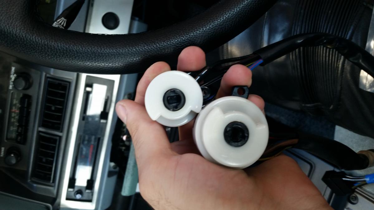

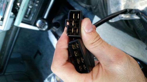

  2. Currently working with the guy I brought an ignition switch off to get the correct part He resent me what he had listed and was the same as the first one I brought Any idea how I find the build date?

  5. Went to install it sat to discover I had been sent the wrong one Emailed the ebay vendor and have arranged to send it back

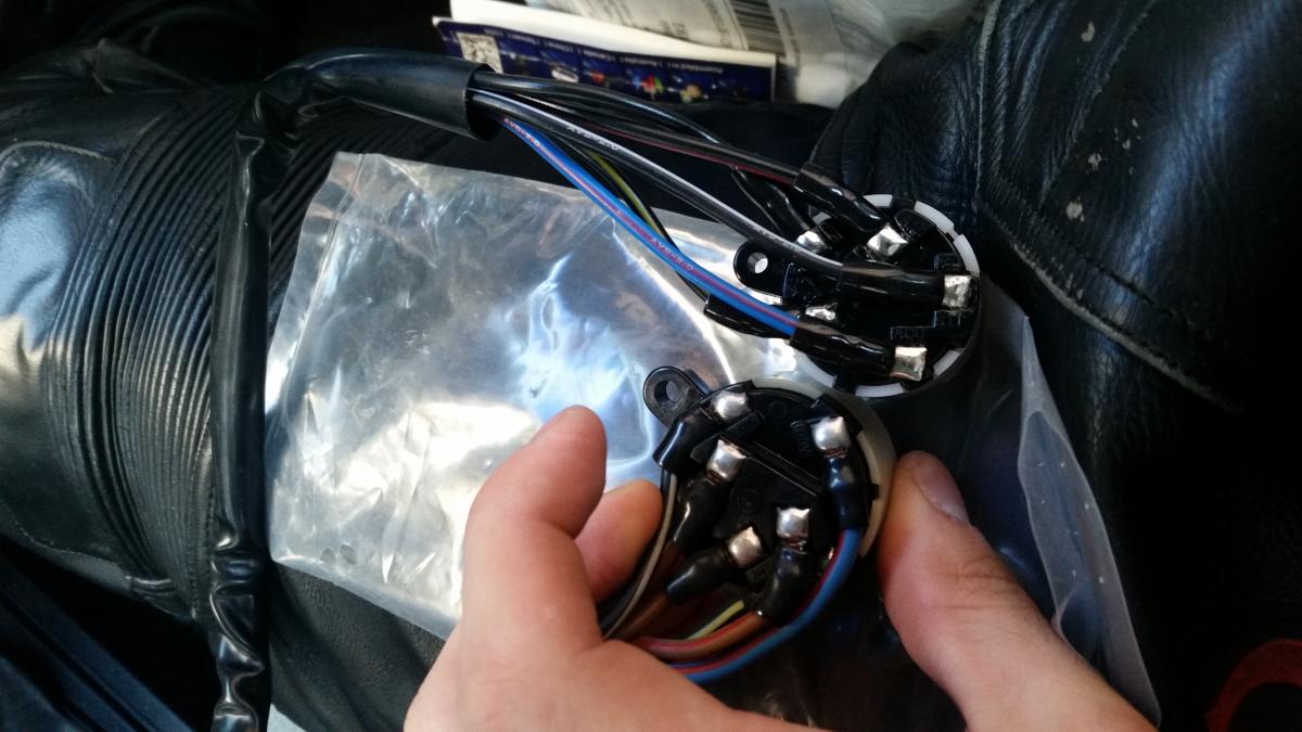

  6. Replaced the ballest resistor last weekend no change Brought a brand new ignition switch which ill put in on sat If that doesnt work then ill have to play with the ignition barrel and metal shaft that goes through the steering column
  7. Thought it might be the ballest resistor but doesnt seem to be ( I bypassed it with the same issue) Probably needs replaced anyway so will get a new one might also buy a new switch as the one from pickapart might be faulty Sigh I hate electrical issues
  8. Seems the car starts and stays on if I hold the key forward a little from the on point but then I let it go and it aligns on the on position it kills the engine. Does this with no ignition installed or with the starter switch unbolted Got a new starter switch from pickapart and same issue Any thoughts ? Have tried realigning the starter switch to the ignition barrel and no change Tried taking the ignition barrel out and starting with a screw driver but the switch doesnt start far enough forward :S

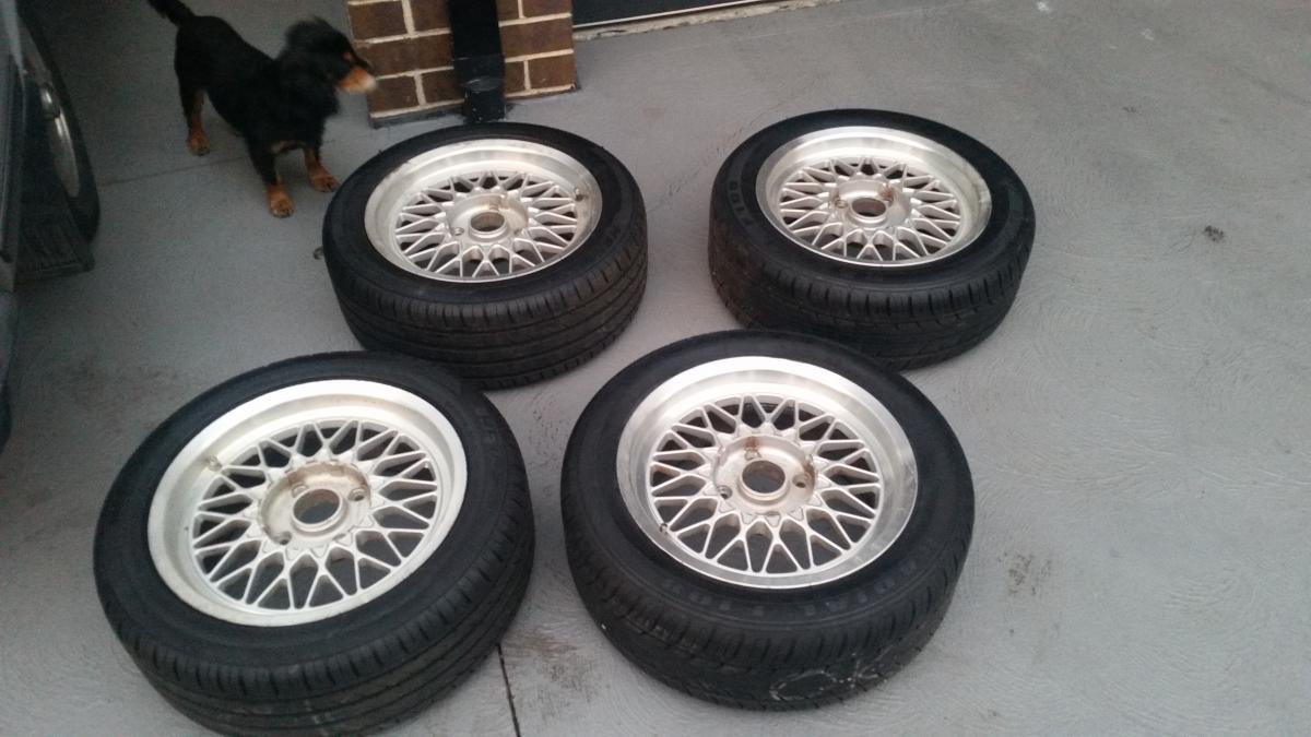

  14. Hey All Picked up a stock as a rock AE71 csx in silver (little bit of surface rust which I am sanding back and killing slowly) she has 200k on the clock and is stupid clean apart from a few scrapes. Got it to teach my GF to drive in and for something to tinker on. Had a KE70 in my late teens that was full of rust (only cost me a 12pack of beer though haha) Haven't had a 4AC since my 88 corolla hatchback (ae92) think you call them seca's over here. Just getting it ready for a rwc atm Things to do are replace a cracked steering boot and the drivers seatbelt (new boots on the way and I have a spare belt, will send the orginal one to be refurbished) Have just put some bbs rims with new tires on. Still have the factory 13s and have a mismatched set of 14s for track use. Still need to pickup some good front tyres, any suggestions?? Only issue I have noticed so far is the brakes are crap (seem to have gotten them better with use) I have a pajero MC to go in and ra40 struts with brakes etc as well on the way. Other issue is she intermittently starts, not sure what the story is as I havent played with carbs in a long time Fuel is showing halfway up in the sight glass, and it revs on the starter motor but doesnt seem to keep running Could be the auto choke? (Fixed hadn't aligned the new ignition barrel properly when I replaced it and it moved to the off location when I let go of the key) Will have another play and see how I go, may have to look into an electronic dizzy swap. Have to keep the engine appearing factory for the GF when she goes on Ps Will post pics soon :) thanks for any help in advance Bbs rims need to get some centres and lock nuts Rims on the car, 15X6.5 +18
