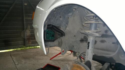

  18. ozyvr4 replied to ozyvr4's topic in Rollaclub Rides
    A Little more done today. I mounted the fuse under the front guard. I will have to build a splash tray for it so when it rains it stays dry. I also made the fuel feed line. I found a 3m length of 8mm ID steel pipe at bunnings that just needed some bending to run along the floor pan. It looks very neat under there. I played around with my spare VR4 wheels. I think with some lowered springs & lower profile tyres it should look good.
