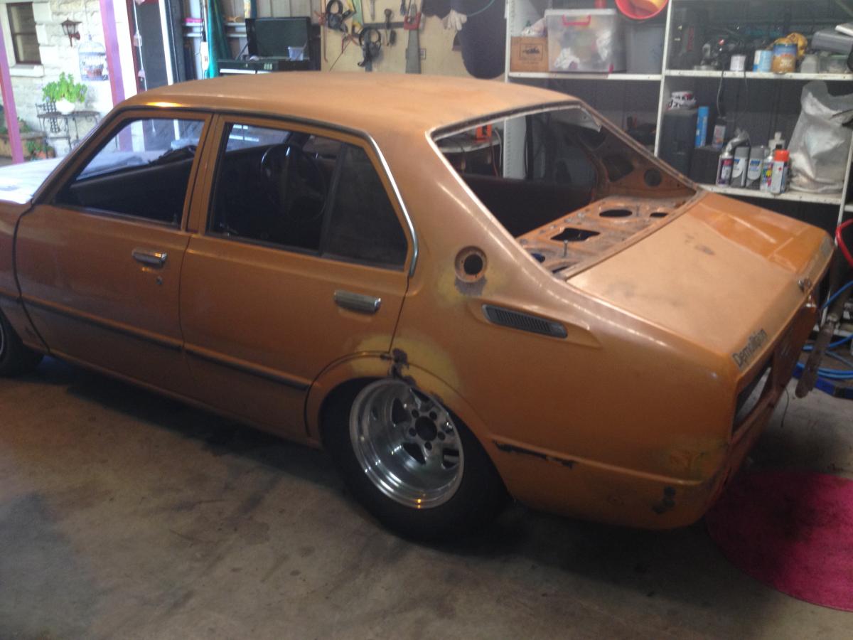

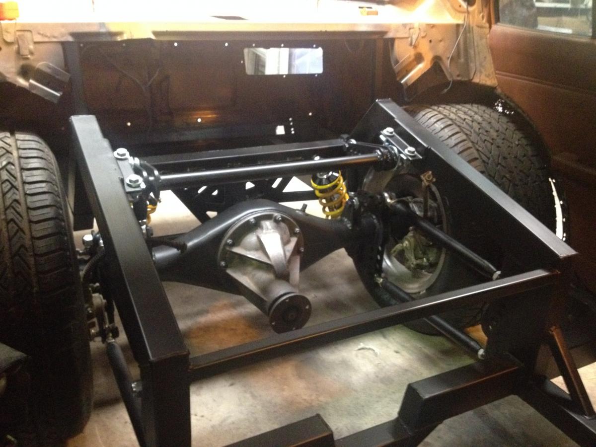

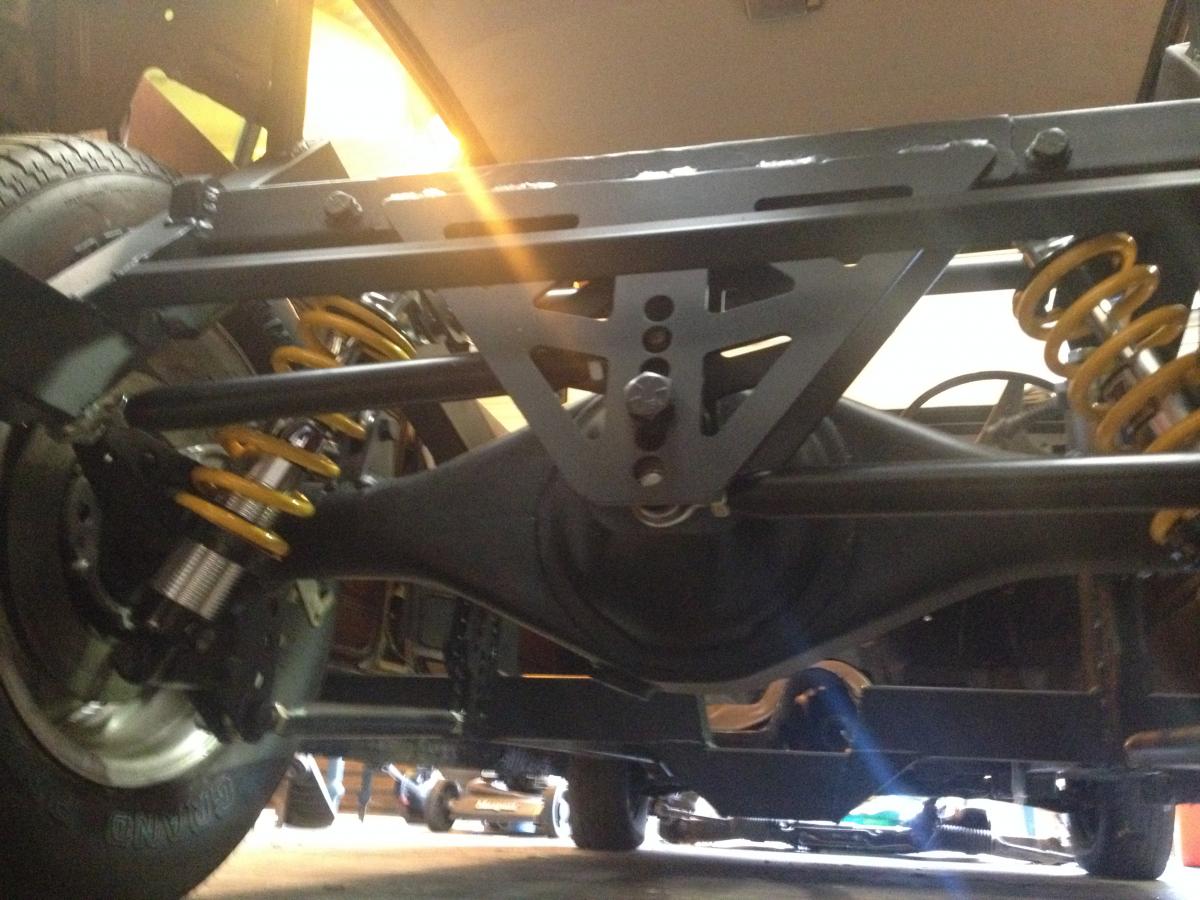

  3. Got the first stage of the Gorilla done, 4 link rear end, shortened Hilux Diff with ford axles and disc brakes, coarse adjustable inverted watts link, adjustable sway bar, in a KE55. The plan with the car is to build a bit of an all rounder, as we don't get enough drag racing, or track racing here to specialise in one or the other. I'm building it so that I can adjust bars/springs change wheels and tyres and have a bit of fun any chance I get. A bit like a track car that I can get to hook up at the strip. Has been 2 years to get this far, but slow progress is still progress! I have a Commodore K-frame sitting on the floor in the shed, and I've heard that they can be put into a KE55 but I can't find any information about it. All the searching I've done has turned up fruitless though, anyone heard of it being done? I would like to use it as it would give me easy access to the commodore aftermarket in terms of brakes, struts, springs etc, and it gives me a rack and pinion steering making a 1uz so much easier to fit.
  4. I like the way the 4 link is located in the above photo. I am also (very slowly) working on a 4 link ke55, but I am building a large clip out of 50x75 and will have no hope of rego or a back seat and I think this would have been a better way to go. Not to worry.. I would not recommend using shorter bars, as the geometry of your setup (pinion angle, axle forward/rear location, roll steer) will change too dramatically as the diff travels up and down when compared to longer bars. I have had a 2 year hiatus on my build due to work commitments, but from memory I think most fabricated parallel 4 link bars are around the 22" mark I think. Doesn't have to be this long but the closer you get the better your setup will be.

  7. Had a look through the thread, is a leaf sprung 2 link set up. Seems to work well though, 8 seconds and near 180mph are proof of that!! I am still thinking that I want some type of 4 link in mine, the research continues.
  8. Looks like leaf springs are gonna be too hard, or just too much work for no real gain. thinking triangulated crossmember type 4 bar at the moment. Want to keep back seats in it if at all possible. It's definitely not a straightforward job, but I'm enjoying it though. Would love to get a look under the rear of OKE020 or WHOSUP cars
