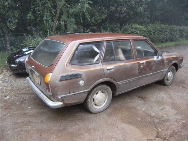

  6. nice little pano you got there... i have a 36 wagon and yeh as others have been saying don't lose interest in it, i saved mine from a crusher for certain and in 12 months turn the car around from a shitter full of mud and rust to what is now..and too get it for free and have the old man wanting to help you is really good to hear good luck with it and ill throw some pics for motorvation...when i first got ithow it looks after some time effort and money

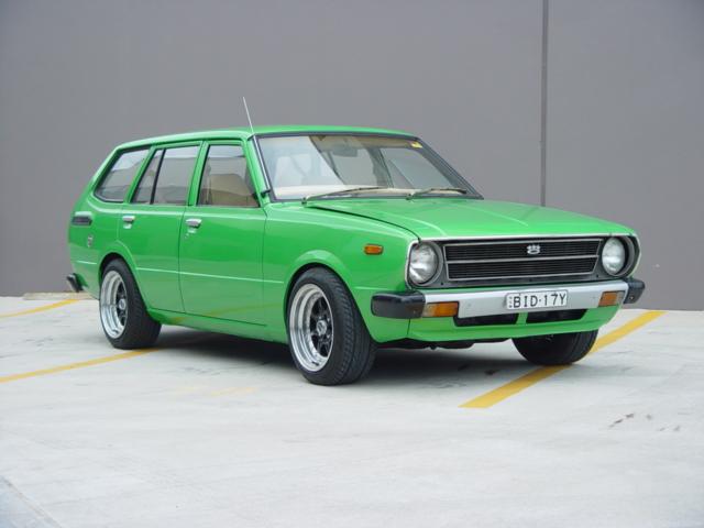

  8. thanks for the comments on my wags..... just finished it was a year long project with the missus and you can see what i started with in my avatar.... cheers chris....
  9. hey yeh ive got them on my 36 wagon got them from jdm yard as well as i deal with the through my work(rda brakes).... heres whats they look like on my car.. ond yeh these are 15x8 +-0 offset
