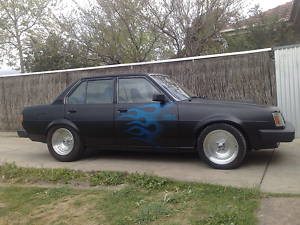

V6 TOYOTA COROLLA
HUGE AMOUNT OF CUSTOM MODS TO MAKE THIS A TUFF LITTLE CAR
V6 VP HOLDEN ENGINE AND TRANS FITTED
VERY RARE GENUINE 4 STUD 15INCH CENTRELINES
R31 SKYLINE DIFF SHORTENED WITH DISKBRAKE AND 4.11 GEARS AND BILLETT AXLES
UPGRADED FRONT DISKBRAKES WITH B&M LINE LOCKER INSTALLED FOR SWITCHED DE-ACTIVATED REAR BRAKES
CUSTOM EXTRACTORS WITH FULL SPORTS SYSTEM
BATTERY IN BOOT, SURGE TANK WITH HIGH PRESSURE FUEL SYSTEM
NISSAN RADIATOR WITH DUEL THERMO FANS
DVD, TV, PS2, INVERTER, VDO SPEEDO, SPECO TACHO, B&M SHIFTER
NEW FRONT RACE SEATS AND NEW REAR SEAT COVERS
NEW INTERIOR CARPET, DOOR TRIMS AND BILLET ACCESORIES
CENTRAL LOCKING WITH PUSH BUTTON START ALARM
HAVE PROBABLY FORGOTTEN SOMETHING....
VERY FAST CAR, HAS GOT ME IN PLENTY OF TROUBLE.
Needs a wash and vacuum, is still dirty from Gazzanats.
