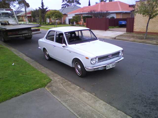

  5. rolla68 replied to rolla68's topic in Rollaclub Rides
    lol yeah the camry is just my daily top fueler, dream ride.... bout as quick as the tow truck lol thanks for the good feed back, was thinkn bout puttin it in some comps and magz, but i will get it ready for the bay to birdwood first

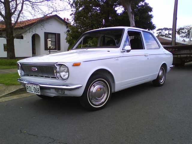

  7. 1969 ke10 5 speed lowered front and rear ke30 front discs 12inch hubcaps, white walls interior retrimmed red vinyl bare metal respray 2 pac white inside, out, boot, engine bay new crash pad $$$$$ venetian

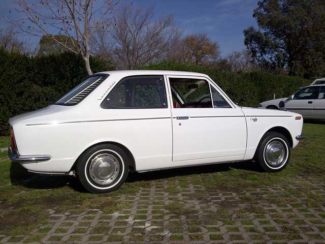

  8. rolla68 posted a topic in Rollaclub Rides
    1969 ke10 5 speed lowered front and rear ke30 front discs 12inch hubaps, white walls interior retrimmed red vinyl bare metal respray 2 pac white inside, out, boot, engine bay new crash pad $$$$$ venetian

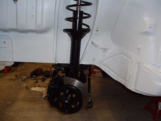

    Inner tie-rod ends - Power Max Part No. TE425R x2 May need new adjuster Outer Tie-rod ends - Power Max Part No. TE426L x2 May need new adjuster i had to get custom adjusters made up because the threads were wrong on the tie rods, can be difficult because the LH thread is rare and i had to get it made up Lower Ball Joints - Pedders Part No. BJ113, apparently meant for ke20, but is only ball joint i could find to fit a ke10, had to machine out the tappered hole for the nut to fit - easy as. bushes were custom made urethanes with graphite in them so they don't squeak hope this helps...

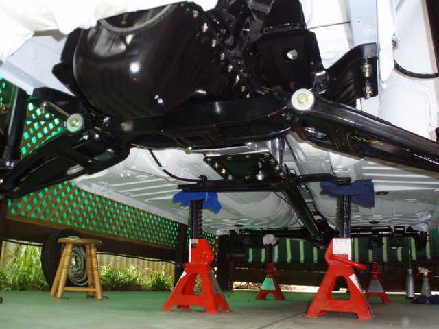

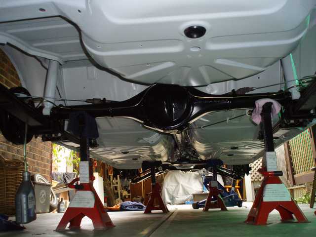

  12. rolla68 replied to rolla68's topic in Rollaclub Rides
    had it bout 4 years, off the road bout 28 months some before pics, it was a jungle of wires....

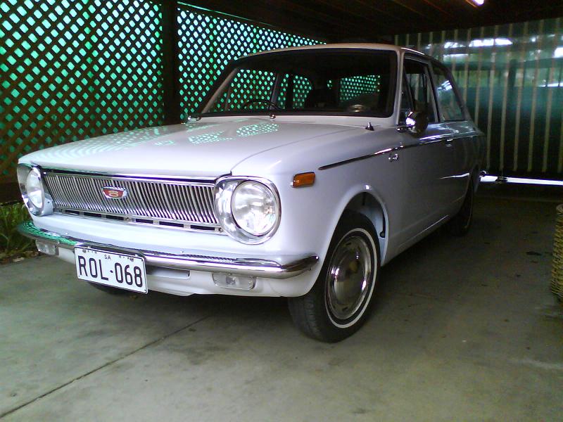

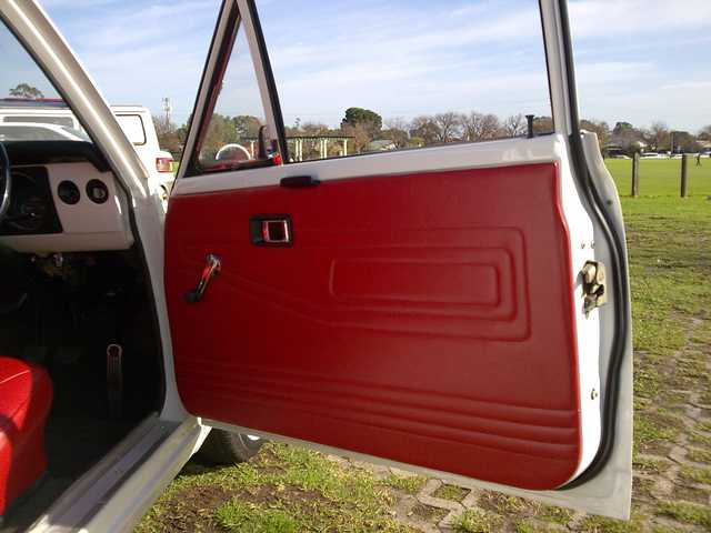

  14. rolla68 posted a topic in Rollaclub Rides

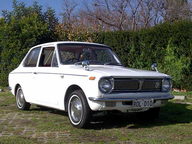

    1968 ke10 5 speed- rebuild lowered front and rear ke20 front discs 12inch hubaps, white walls crx seats and interior retrimmed red vinyl 2 door 68, bare metal respray acrylic white inside, out. underneath, boot, engine bay suspension powered coated, new everything e.g. shockers, bushes, tierods etc. custom EFI alloy fuel tank EFI setup Microtek MT-8 new crash pad $$$$$ venetian retractable seatbelts lots lots more
  15. rolla68 ke10 5 speed- rebuild lowered front and rear, ke20 front discs 12inch hubaps, white walls crx seats and all retrimmed red vinyl 2 door 68, bare metal respray acrylic white inside, out. underneath, boot, engine bay suspension powered coated, new everything e.g. shockers, bushes, tierods etc. custom EFI alloy fuel tank EFI setup Microtek MT-8 new crash pad $$$$$ venetian retractable seatbelts lots lots more
