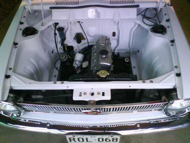

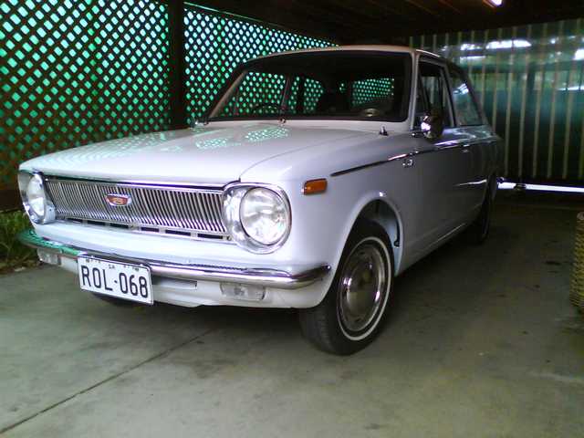

68 Ke10
1968 ke10
5 speed- rebuild
lowered front and rear

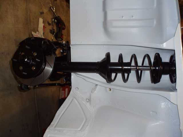

ke20 front discs
12inch hubaps, white walls
crx seats and interior retrimmed red vinyl

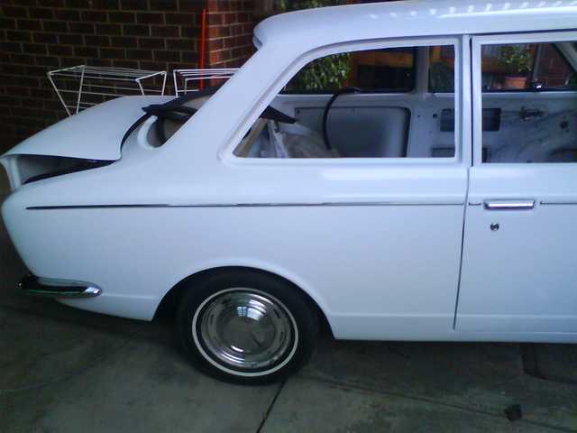

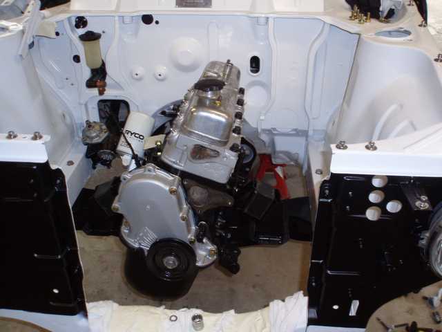

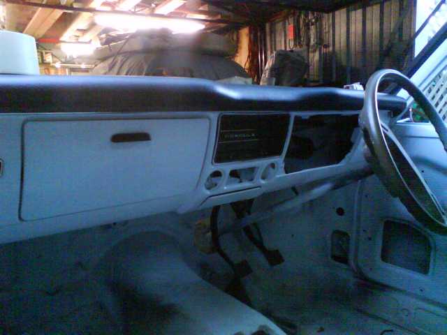

2 door 68, bare metal respray acrylic white inside, out. underneath, boot, engine bay

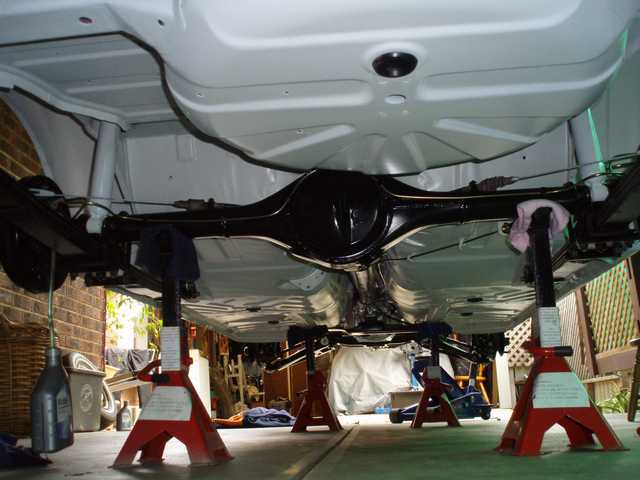

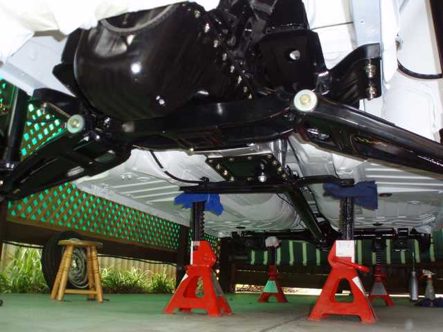

suspension powered coated,
new everything e.g. shockers, bushes, tierods etc.

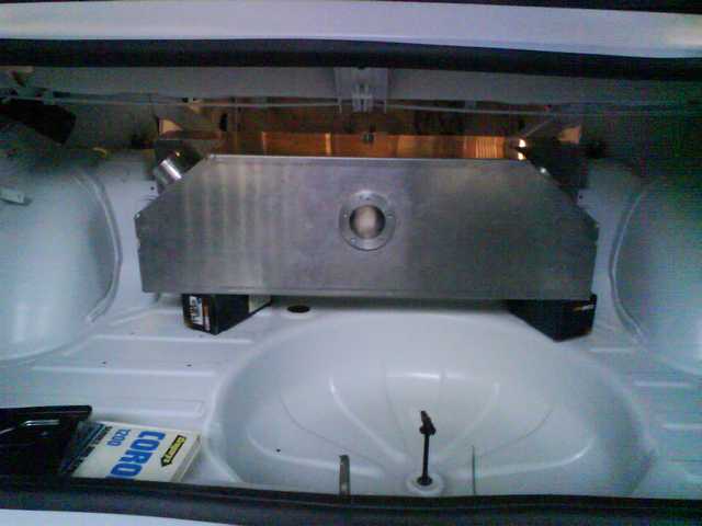

custom EFI alloy fuel tank
EFI setup
Microtek MT-8
new crash pad $$$$$
venetian
retractable seatbelts
lots lots more

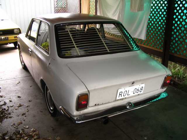

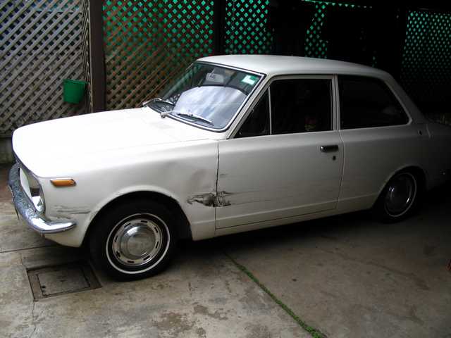

Got any before pics? Interested on the cars history, had it long?

had it bout 4 years, off the road bout 28 months

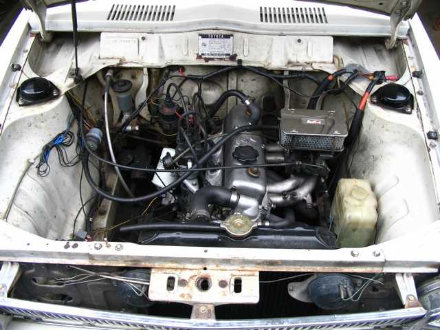

some before pics, it was a jungle of wires....

nice work, where did you get your new tie rods, bushes etc?
Inner tie-rod ends - Power Max Part No. TE425R x2 May need new adjuster
Outer Tie-rod ends - Power Max Part No. TE426L x2 May need new adjuster
i had to get custom adjusters made up because the threads were wrong on the tie rods, can be difficult because the LH thread is rare and i had to get it made up
Lower Ball Joints - Pedders Part No. BJ113, apparently meant for ke20, but is only ball joint i could find to fit a ke10, had to machine out the tappered hole for the nut to fit - easy as.
bushes were custom made urethanes with graphite in them so they don't squeak
hope this helps...
