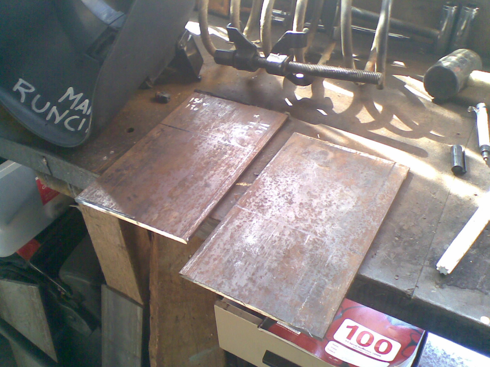

  14. Hey guys, Just bought this corolla about 3 weeks ago. Its now my 6th KE30/55! This one is the best one i have owned bodywise. It has next to no visable rust =) I bought come 13x7 spitfires? they came off a mates datsun, then got them wrapped in some rubber. After getting the wheels put on i decided it was way too high so i decided to lower the front end. Its looking really good so far in my opinion. I've also got a 4A-GE to go in her. Thanks guys, Mark. Anyway here are some pictures. ^Just after getting the wheels put on. Standard height. ^ After i lowered the front. Yet to do the rear end... ^My Twin Cam to go in after i convert it to RWD. Yum =)
