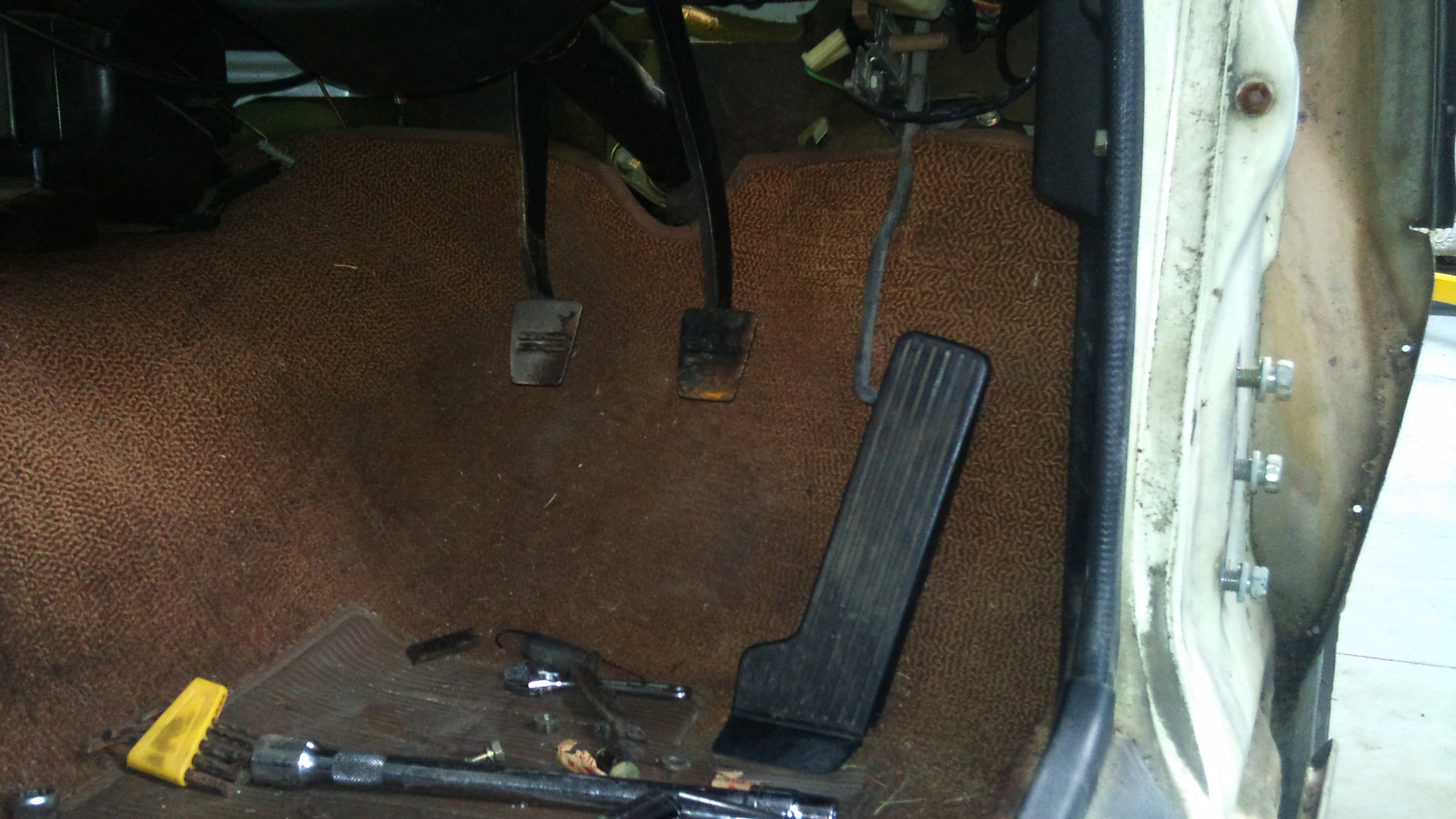

  12. Update, got the pedal box in on saturday and began scotching the engine bay for paint. Wish I could have a week solid on this thing to get it sorted!

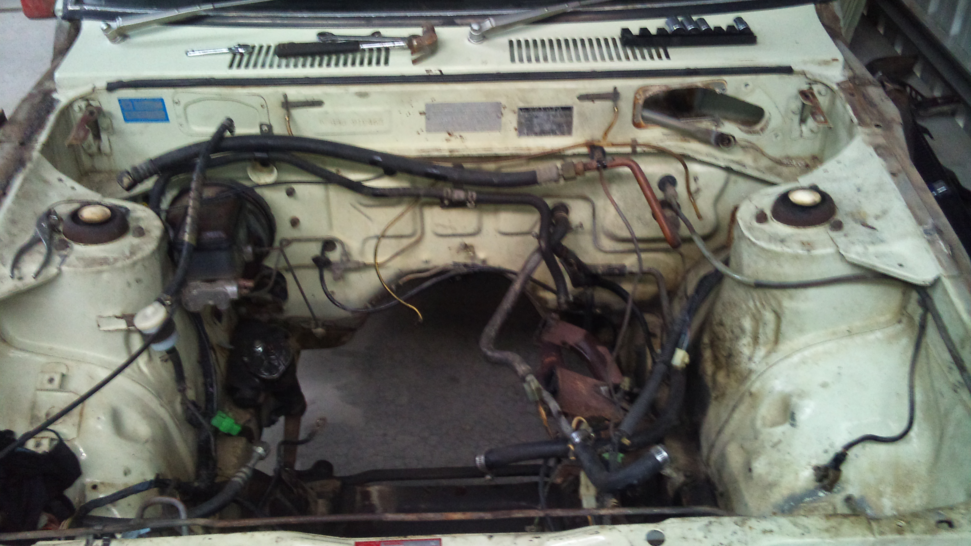

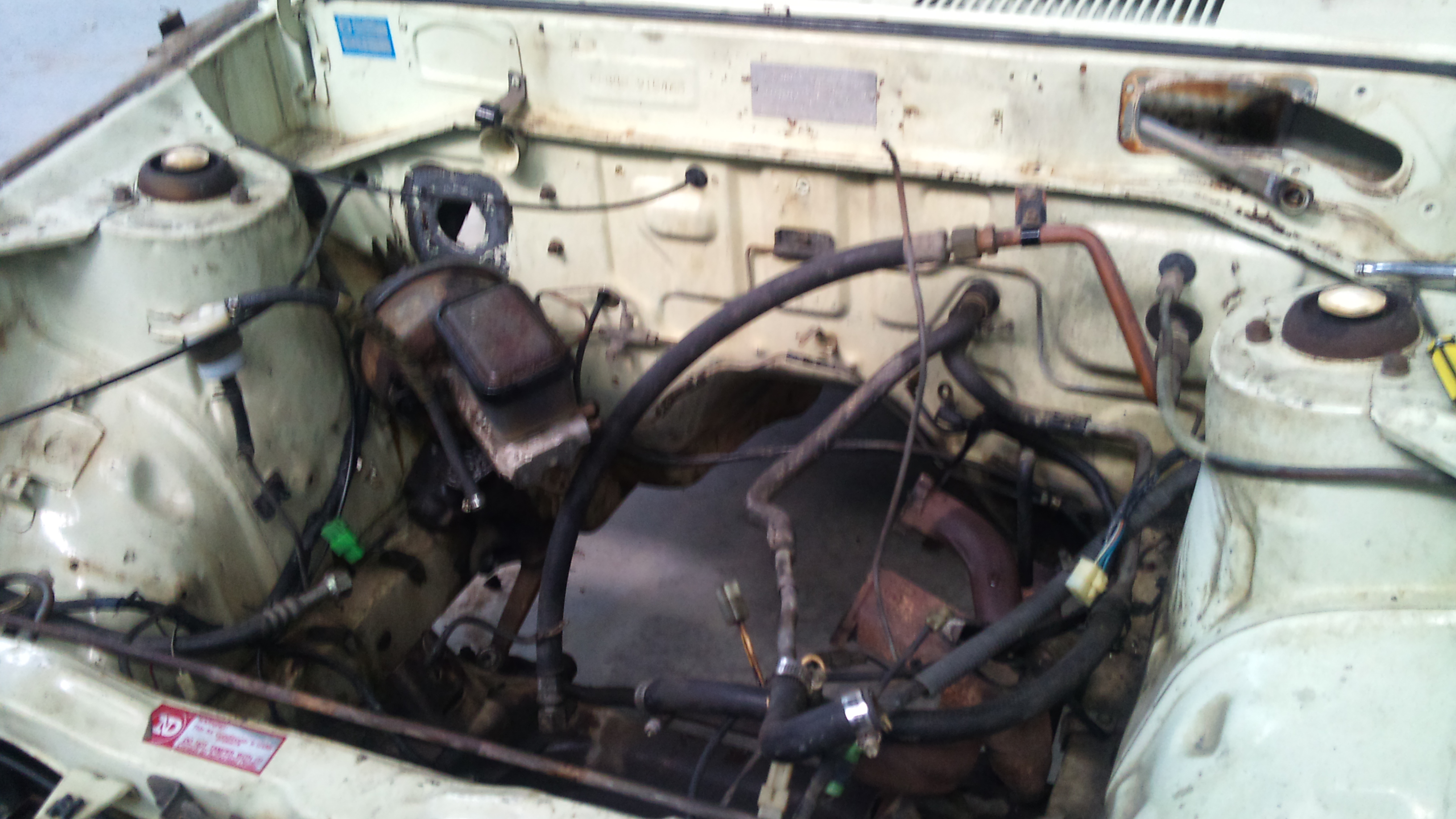

  14. and........... engine+auto out !! Looking forward to cleaning up the engine bay, and getting down a fresh coat of CT black. Will be updating soon!
