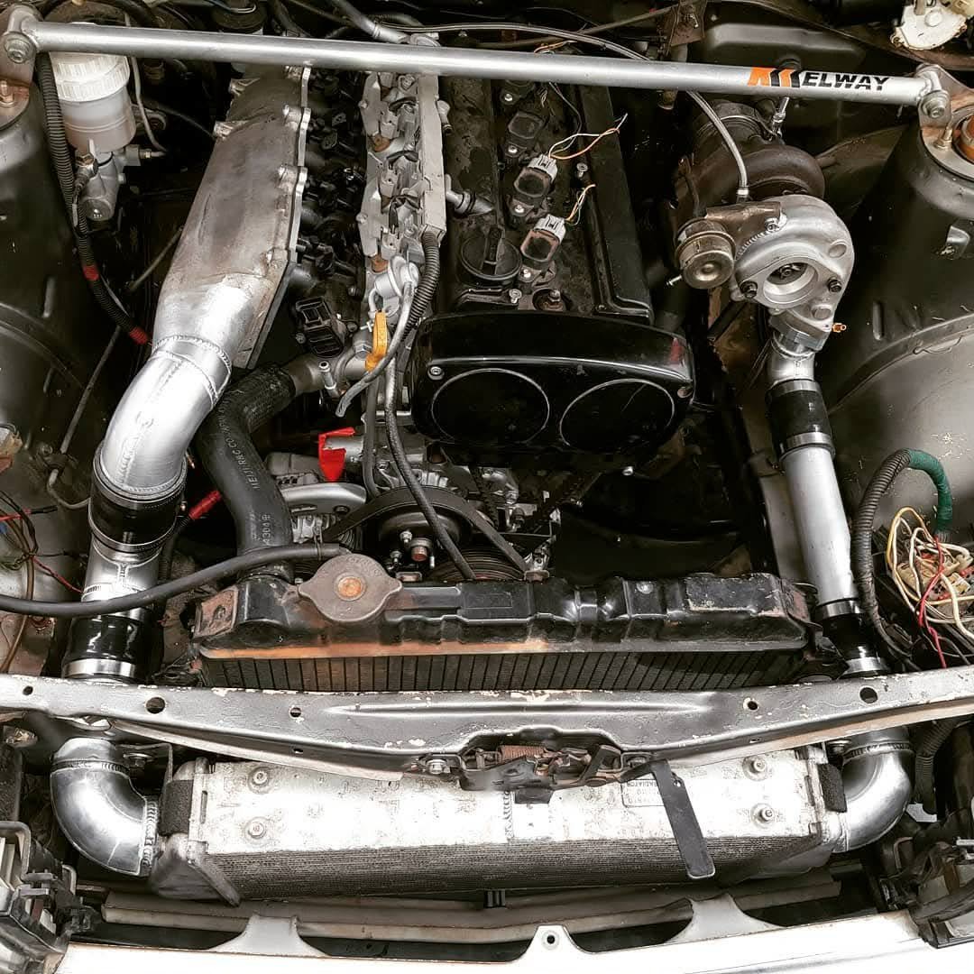

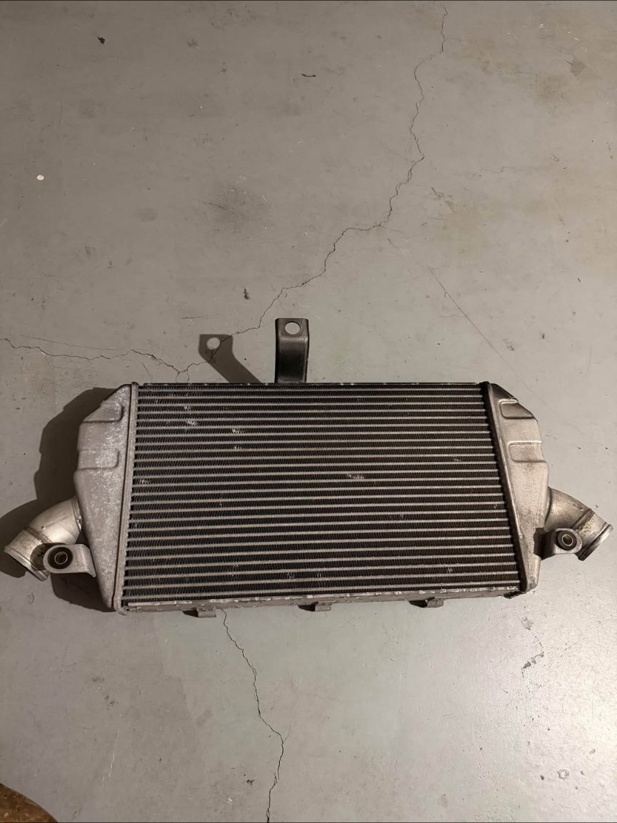

  1. finally picked up the evo 8 intercooler, interestingly one elbow is silver soldered on the other is welded, weird choice but ill just knock them off and rotate them to fit the ke

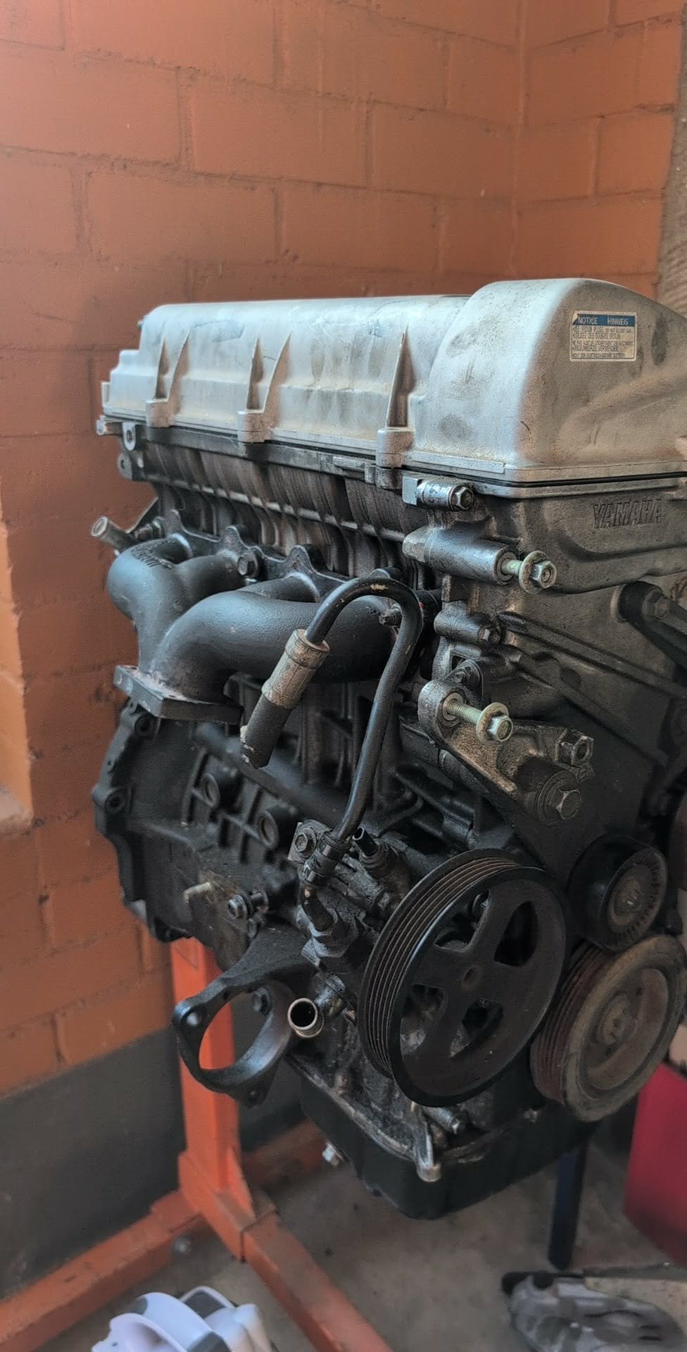

  2. I actually don’t think the 2ZZ will really be a thing in 10 years — there just aren’t that many of them around 100% enthusiasts choice. I went with a 2ZZ because the 4A-GE is an early ’80s design, and the 3S-GE is basically the same story: iteratively modernised over the years, but the underlying block and rotating assembly are still ’80s tech. What I do think could become a popular option is the hybrid Camry 4-cyl. If you check out Frankenstein Motorsports on YouTube, he’s shown that the 2AR-FXE (2.4L) comes with stupidly high factory compression and can make around 240 hp just by running an inlet cam in the exhaust position and using a custom cam timing setup. Bonus is it still shares the same bellhousing pattern as a 3S-GE, which makes it really appealing, and absolutely mass produced.
  3. Can confirm it’s basically the same as a 4AGE. A mate and I did a long-block to long-block comparison and from memory the 2ZZ was only about 2 kg lighter — can’t even remember if both were wet or dry at the time 😅 It’s that close that little stuff like fluids and brackets would swing it either way anyway.

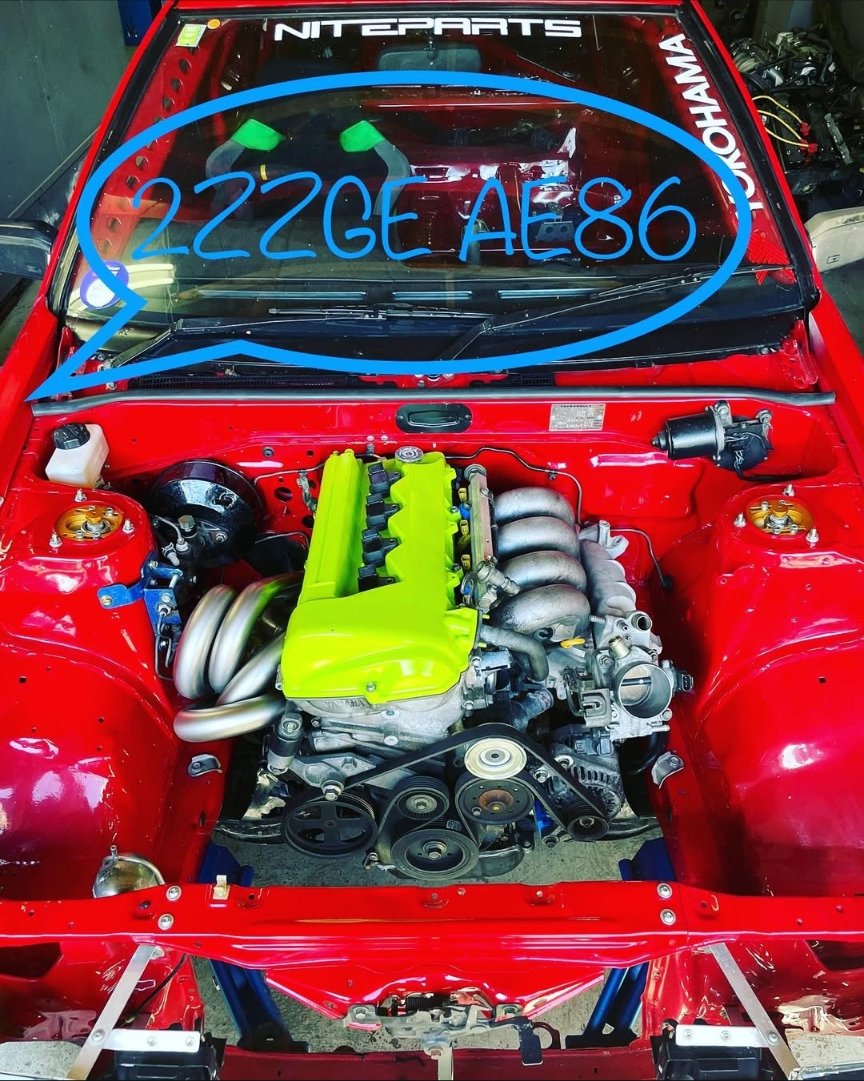

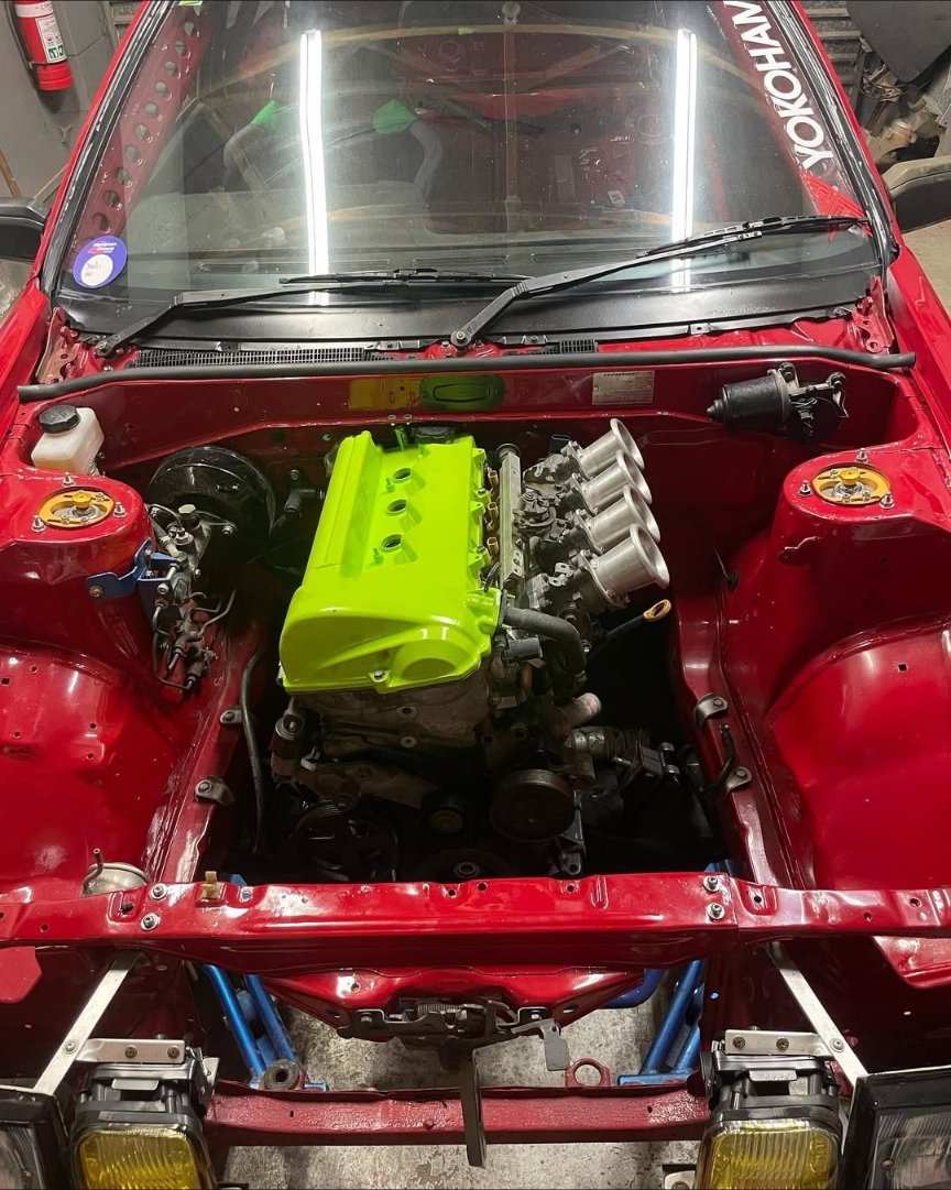

  4. Sorry to necro my own thread 😅 The KE is finally moving again. It’s getting a 2ZZ-GE with a GT2871R I picked up off Marketplace. Niteparts do an AE86 conversion kit, so I’m on the hunt for an AE71 crossmember to make that work. Still going ITBs… because I clearly hate myself. CNC Innovations do a 2ZZ-to-ITB adaptor, then I’m running a SQ Engineering to GTiR plenum adaptor plate to tie it all together. I’m doing an electronic throttle conversion using a Honda APS and an AE86 pedal. The ITBs are actuated via an EFI Hardware throttle actuator, so the throttles themselves are still cable-operated — just way less fabrication and a much cleaner setup overall. Out back I scored an RN40 Hilux diff, currently sorting disc options for it. Steering is Prius electric column power steering because I’m running AE86 power-steer knuckles and a FLOS quick rack, which makes it properly heavy up front without assist. Brakes are Series 5 RX-7 4-piston calipers on AJPS mounts, with a standard EP91 Starlet booster and a Pajero master cylinder. I’m also running an electric A/C compressor, as the factory A/C mount is right where Niteparts pick up the passenger-side engine mount. Fuel system is a S13 EFI tank — fits surprisingly well, hangs a touch low but gains about 10L extra capacity, so I’ll take that win. This is very much a spare-time build, sourcing basically everything from Marketplace and wreckers. Case in point: I’m even heading out tonight to pick up an Evo 8 intercooler to more or less copy a mate’s setup, even though our hot and cold sides are different. Funny how getting older means making slightly more thought-out choices… still dumb ones, just better planned 😂
