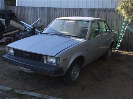

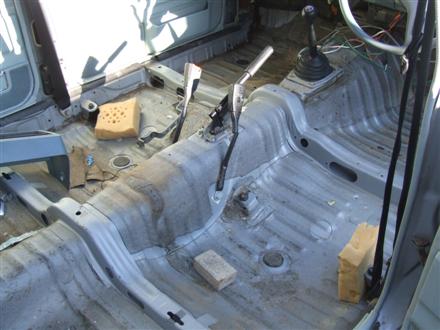

Well, I started this project a little while ago after picking up a rust-free shell from Trendact. Bloody cheap too. It had NO interior except the dash and steering wheel and door trims. My first plan was to throw a 4age at it. But finances stood in the way of that. Then I was going to freshwn up the 4k (needed a rebuild anyway). But then I found a nice 5k to wack in it. I've been told that it's had a stage 2 cam thrown in, and some head work done. I've already change the box to a k50. I'm going to make a complete custom boot install. And of course a respray. I've also got a spoiler to go thats currently sitting on my other ke70 (daily driver shit-box). Was hoping to have it done by christmas but :P :) :D as luck would have it, I don't earn enough or have enough free time. I have most of the interior now, just need a couple of more bits and pieces
