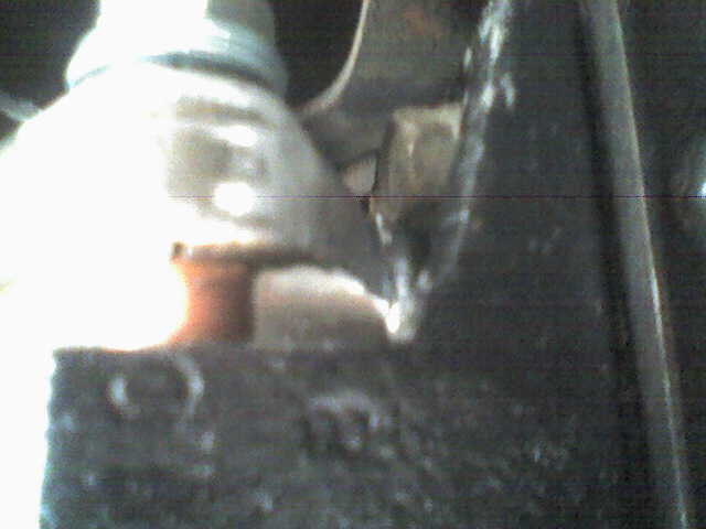

After getting the alt on I had difficulty getting the fan belt on. The problem I found out was the alt was hitting the nut that holds the back of the alt mount to the block. Pic below of the bolt:
As you can see above this was the alt sitting lose out as far as it could go so it didn't let it move in much and well if the alt was hitting the bolt there was still not enough play to get the belt on and if it was on the belt would be SUPER tight.
So the cause of this is the original alt didn't have the rear mount off set backwards. As you can see in the pic above my copper spacer I made :jamie: But the standard one also has a sheet metal mount so it slides between the bolt and mount and wont hit.

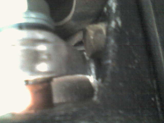

So the solution to this was to grind the alt mount down. And this is the alt after grinding:
The pic above is the only one I have of the gridded alt mount but this is with the fan belt on so you can see still a gap I took a good chunk out of it with the die grinder and problem fixed.
