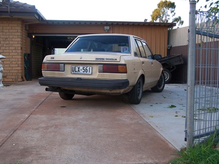

Bought a new KE70 today.
Its beige with late model front.
Its got a locker, cut springs, tacho dash and twin upswept tip :D
Oh and the best part hardly any rust, just a little bit in the tyre well.
Paid 400 for it and it came with loads of stockys and tyres. A few hard old 155s to help the 4K slide ;)
Few problems are cracked windscreen and a pretty mangled r/h/f guard. but ive got the parts to replace these on my old sev.
Plans for it are firstly tidy it up and do a bit of suspension work, then either my 4K Turbs setup or a 16v.
Ill get pics up tomorrow, when i get it home.

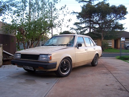

Suspension:
Front:
Stitch welded strut towers/ chassis
AJPS 6KG Springs
KYB Short Stroke Shocks
Sprinter Struts
Corona LCAs New BJS and Bushes
Long Wheel Studs
2 8mm Spacers
Simmons B45 Rims 15x 6.5 Ghey offset
Hankook Directionals 195/55 15
Rear:
Welded Borg Warner
AJPS 4.5KG Springs
Hotwires 13x 5.5
Random Tyres
Custom Adjustable Panhard Rod With Urethane Bushes
Brakes:
Front - ADM Sprinter Discs/ Calipers With Lucas Pads
Rear - Stock New Linings/ Wheel Cylinders

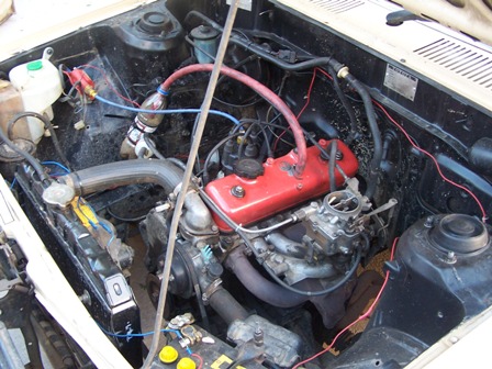

Engine:
4K
Early Manifolds no emissions
Air Filter removed
Oil Catch Can
Electric Fan
2" - 2 1/4" Underdiff exhaust, with one resonator
Timing at 22 degrees advance at idle
