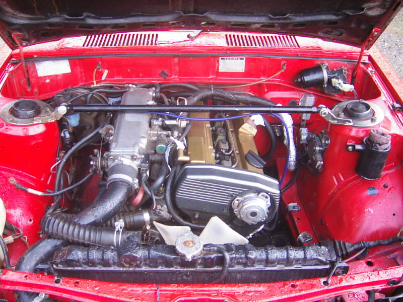

Motor & Driveline. NISSAN CA18DET. t25g turbo, hi flow stainless manifold, full 3 inch exhaust from turbo with atmospheric screamer pipe, VL turbo fuel pump, 1 litre surge tank, Supra front mounted cooler..

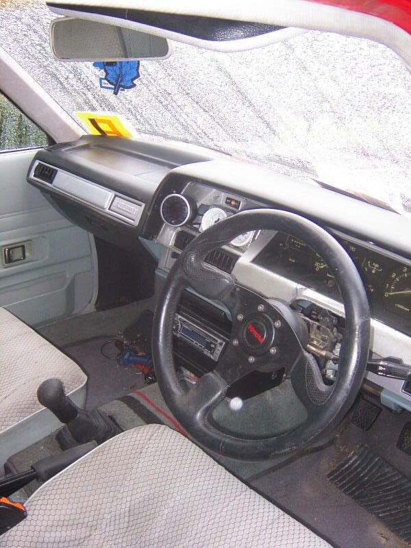

Interior: some sort of aftermarker 350mm wheel, auto gauge water temp, omori boost and oil pressure gauge. greedy turbo timer, fire extinguisher, gutted buckety standard seat..

Sweet ride dude :P Can you tell me more about the cressida arms? So they run a balljoint that mates to the S13 coilover?
cheers mate.. s13 hubs bolt straight up with the cressida arms... not a straight fit but pretty close.. a little bit of grinding is required to make the arms fit in the ke crossmember.. you will need a s13 hub knuckle thingy to bolt the s13 coilovers to.. the coilover has to have body adjustment in order to work properly..
