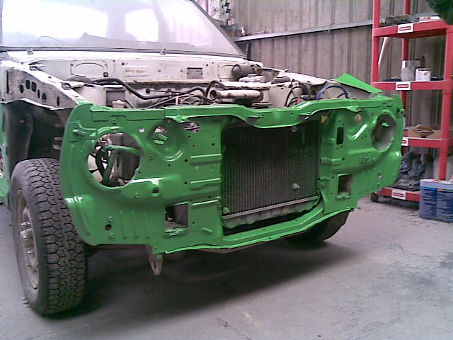

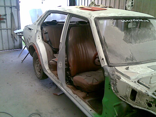

Well thought i would put up some kind of update, its a very very slow project (hence the lack of updates)

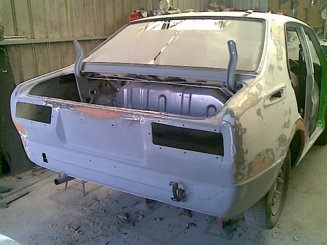

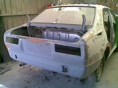

It is now completely stripped and all sanded except 4 rear end.

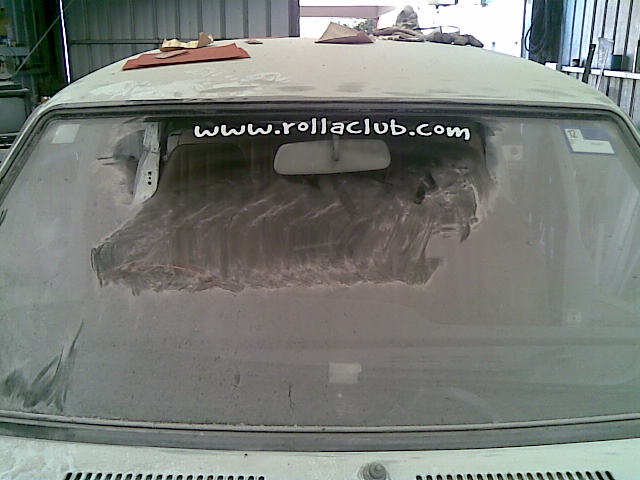

Couldnt wait, jus had 2 put the stickers on lol

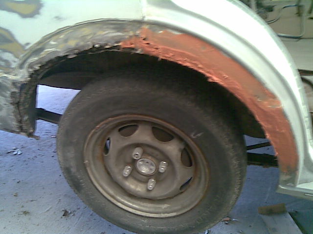

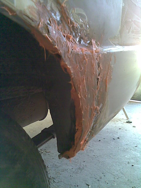

Metal plate welded in and fibreglassing overtop
Other side also in progress

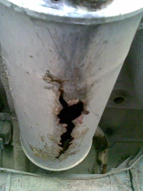

Is this bad? lol
Its first sniff of green
As usual, the pic doesnt show the actual colour. its ALOT better in person

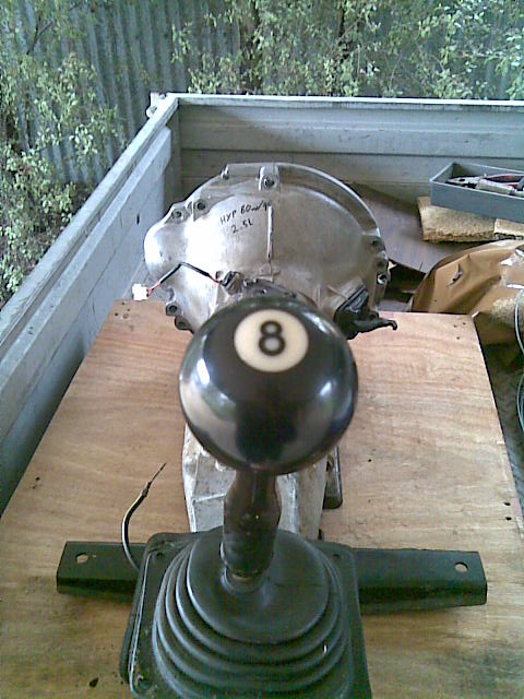

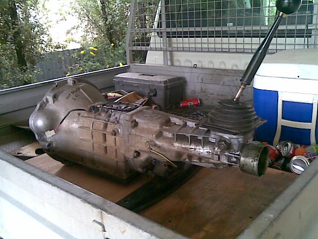

go this the other day.....
and chucked this on it, have been lookin for one for so long

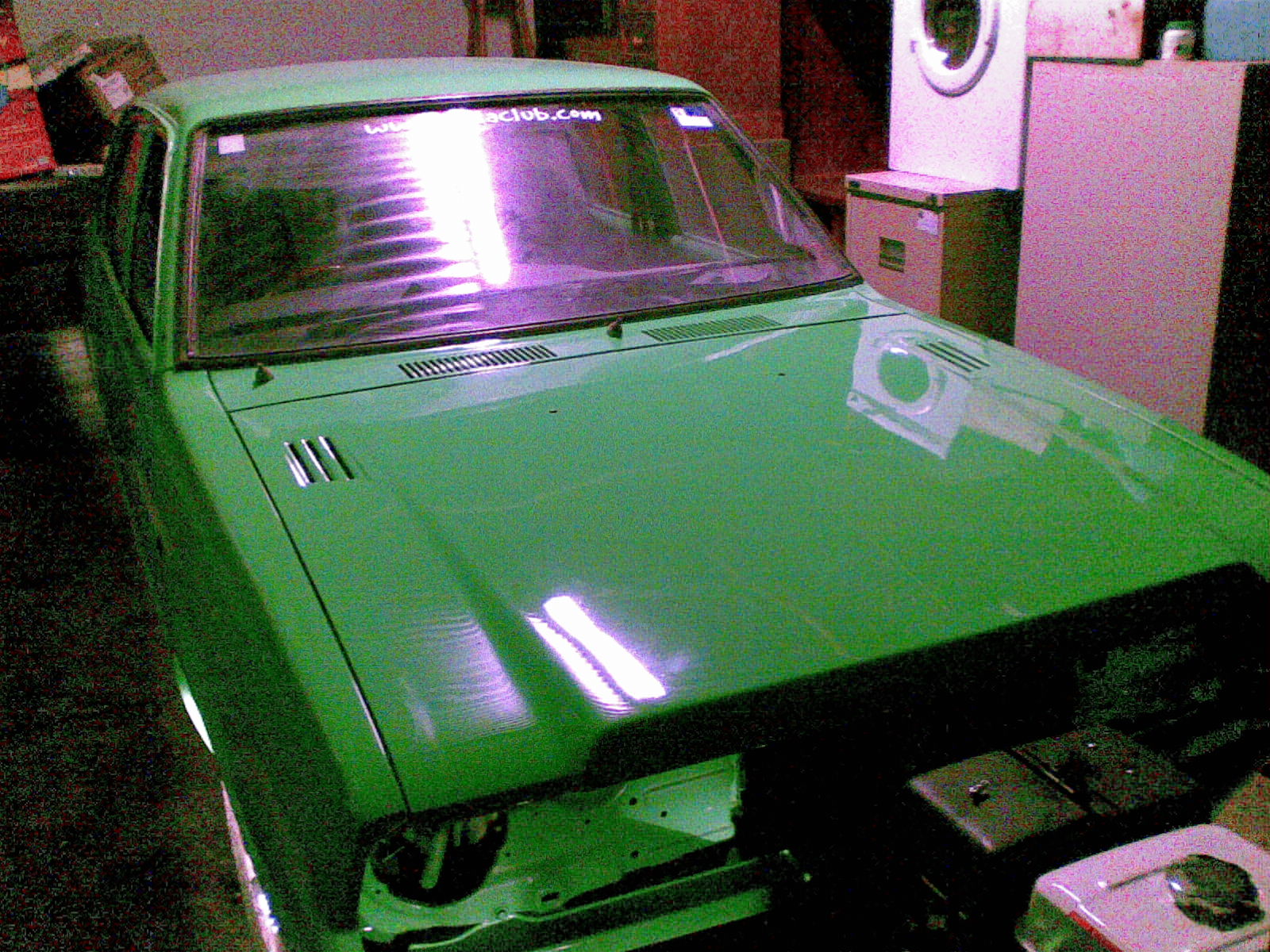

october 3 2008, holy s**t! it's been a while since last update. well comparing to the above pics u wouldnt recognise it. ALL dents and creases have been knocked out, and bogged (if needed), all panels are back on, primed and aligned. inside of doors and door jams are green, came up sweet as!! the spot priming was finished today, unfortunately cold weather so drying time was gonna b a while before sanding. and if all goes well, it should get it's first green coat next weekend. in the mean time, i bought a specometer tacho to replace the clock, i've been trying to work out stereo issues, what to do about wheel spacing and fixing a carby problem..... hopefully get some pics of it next weekend and post them up.

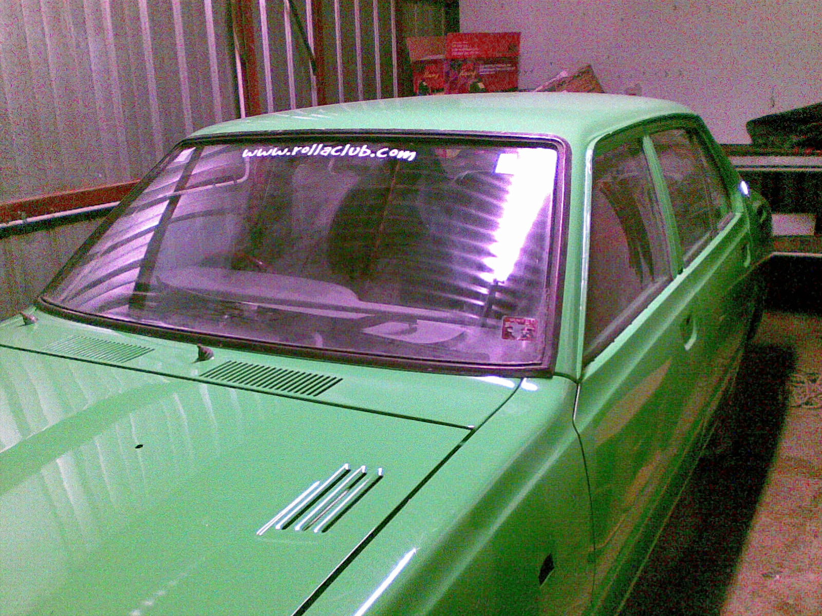

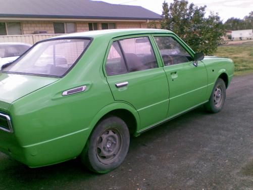

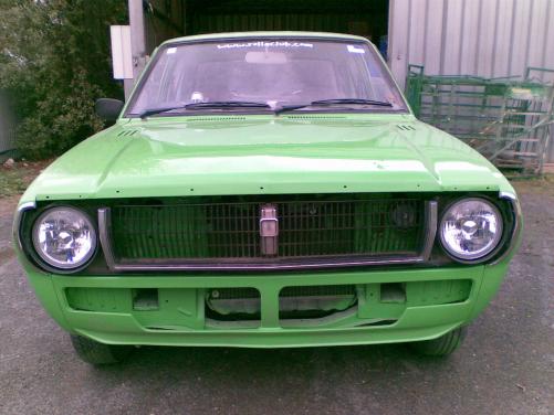

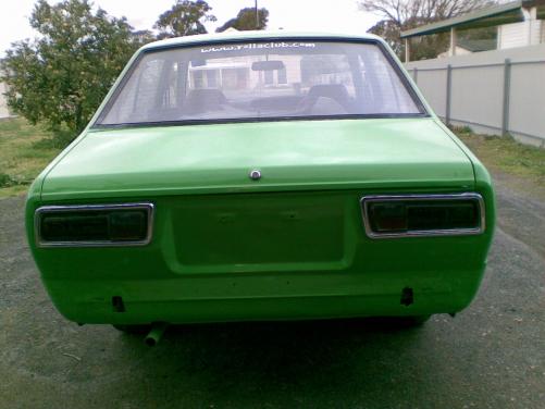

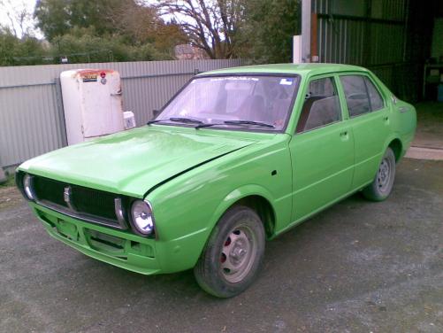

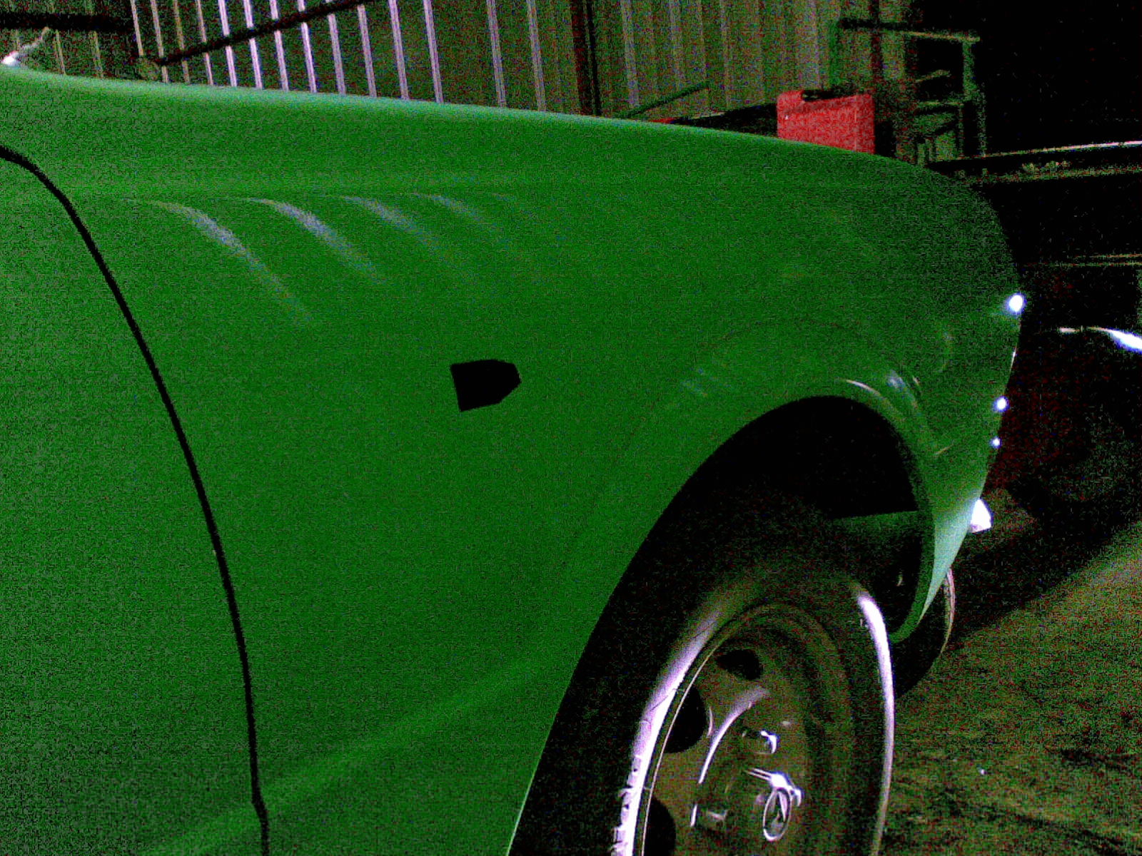

Pics up.
all painted, WOO HOO!!!!
the pics really don't show the colour as usual
this is as close 2 the colour as i can get, still nothin like
will get more pics this weekend out in the daylight
