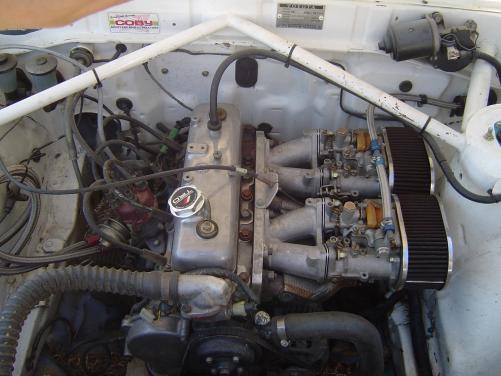

hi cam. i think your right about them hitting the bonnet. sounds like you've still got the van sump. your right about the angle of the ports & the shape of the manifolds - gives you a better attack angle on the valve. ive seen the 7k efi setup, not to bad at all. i did have the 5k upright efi when i built it, but just couldn't get the perforance out of it, so we bolted on a set of dellortos & all the power came back. its got alot to do with how the fuel is delivered - a droplet of fuel carrys alot cooler charge than the spray from the injector. they both have there +s & -s.

The 5k sumps I've had are identical to late dished 4k sumps, they are larger than the early 4k ones. No problems with fitment into a ke1x with the ones I've had, and my motor sits lower than stock with a modded mount on on side.
Not sure if they are the same as van ones... You have to remember that a lot of 5k's came into the country as jap import motors, so unless the motor came out of a van, you can't really be sure of the motors original application.
The main reason the upright motors go harder is because the inlet manifold has a straighter, less restrictive path into the head.

Well i'll be custom making my inlet manifold to suit my twin webers so i guess i'll accomodate uprighting the engine in my designs. id love to get the 20mm pistons but ive already got the 18mm pistons :wink:

have you got any photos of the sump you made? and just of your engine in general :wink:

raff_gsr ask Kangaroosa to post up the measurements of his sump baffles also. He has pics of his sump in his for sale thread.
