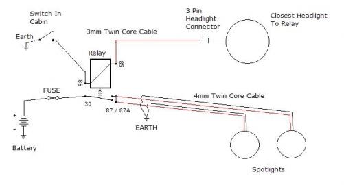

Depends on how you want to go about it, Attached is a quick diagram I whipped up on how we do it at work. By law spotlights are required to function off high beam, So we tap into the wires on the back of the original headlight.
You will need some 3mm twin core cable, 4mm twin core cable, Fuse holder with fuse (25A) Depending on how big the spotlights are that might change, Switch and some crimp terminals.
Basically start with mounting your spotlights, Mount your relay, Wire the positive of the spotlights to your relay, Earth both the negative of the spotlights to ground, run your switch wire through your firewall, mount the switch and connect it up - when it runs past the relay cut the insulation to bare the positive and connect it to your relay, make an earth from your relay to ground, wire your switch wire to your headlight high beam, then finally connect the battery to the relay via a fuse holder...

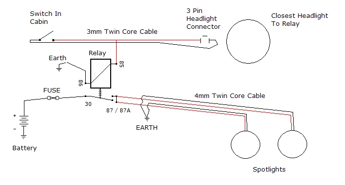

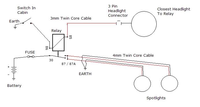

More or less the same but using less wiring. To get the power for the relay you just splice into the high beam wire at the head light (or if its for fog lights - the low beam wire). The relay won't work till you've closed the circuit at the switch.
To find what fuse rating you need
Voltage / watts = amps
12v / 100w = 8.33333amp (but use one thats a bit higher due to spikes when the light gets turned on, say 10amp)
Same goes with the wiring for the spot/driving/fog light. Where as the wiring for the relay/switch combo you can get away with cheap and nasty speaker wire if you feeling cheap and nasty. The relay itself only draws something around 1-2 amps when its turned on
But all in all keep it neat, tidy and have good clean earthing (grounding) points.

The switching circuit on this one is safer if the switching wire shorted the lights would just come on, with the top circuit if the same wire shorted the headlight fuse would blow then you could be in a lot of trouble without headlights if driving at the time.
You would be doing a good effort for starters to rub through Twin 3mm Gas as it is double insulated, Do you understand how the light actually functions when you switch it on and then to high beam? You aren't going to blow the headlight fuse..
its a good circuit just add a 5 amp in-line fuse i understand how the circuit works, I Have also seen how some people run wires, My corolla when i bought it had a 5mm single insulated house hold wire going from the battery terminal thru a sharp hole drilled in the firewall to the boot un fused.
