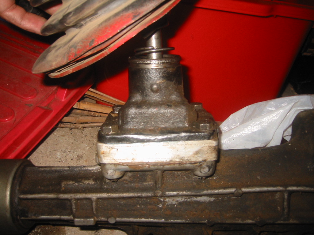

Just thought I'd put up some piccies of the short shifter I built.

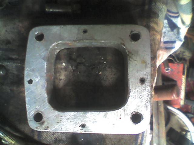

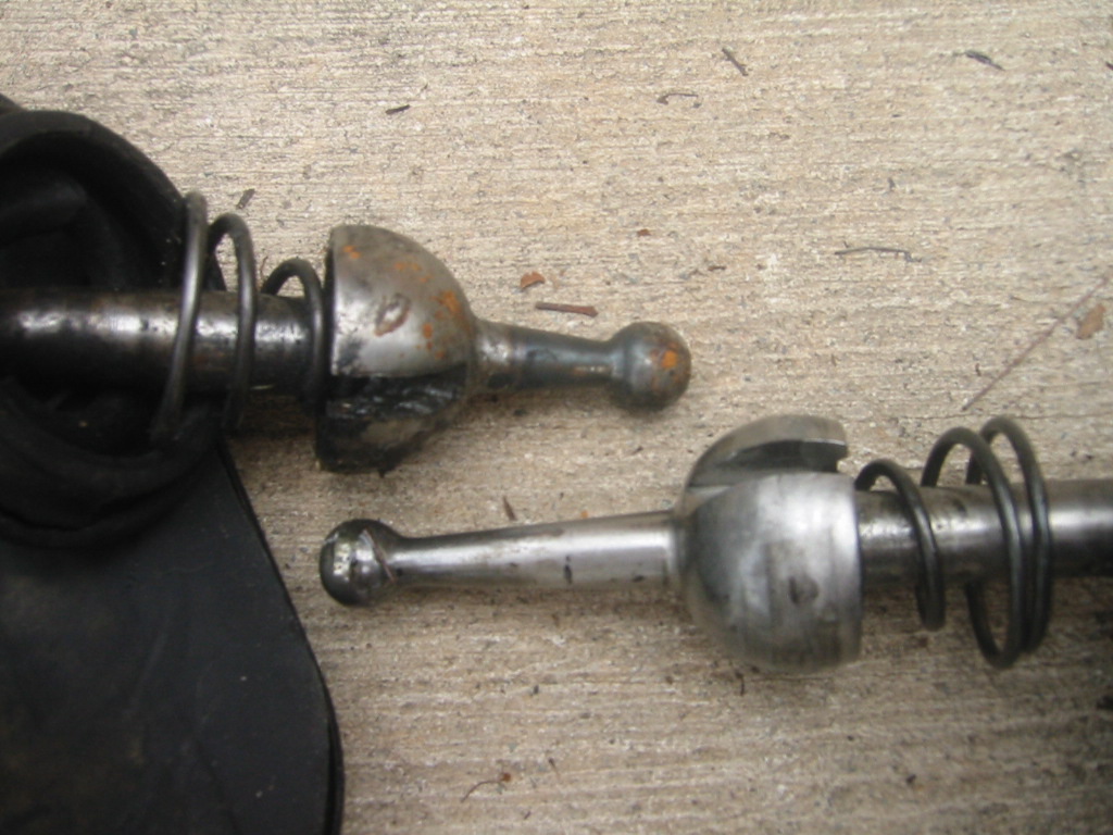

Mark I shifter was done by welding an extra piece of metal into the g/box end of the shifter. The extra length was around 20 mm. A spacer plate was made up for to go between the extension housing and the shifter mount.
The photo's below are from the Mark II effort. A new lower section of the shifter was machined from tool steel. The extra length was 18 mm. Another spacer was also machined up out of 18mm thick Alloy.
The reduction in shift throw was around 50%.

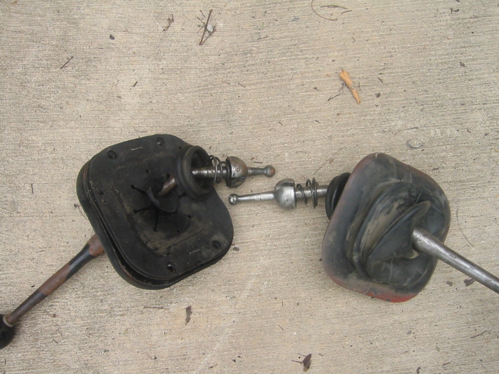

Now manufacturing a new lower section of shifter is tricky, and takes someone fairly handy on the tools (ie: I didn't actually make it, someone talented did). Another option would be to only machine up only the end of the shift. ie from the big ball thingy to the tip. You could cut the existing end off, and thread the new one into the ball. the trick would be getting the exact length correct.
Food for thought.
Standard vs modded shifter.
Spacer on box side.

Very neat. I take it the spacer needs to match the additional length of the shaft?

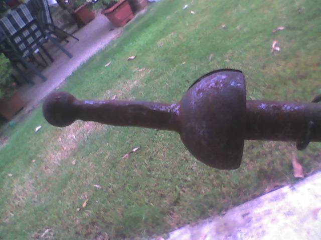

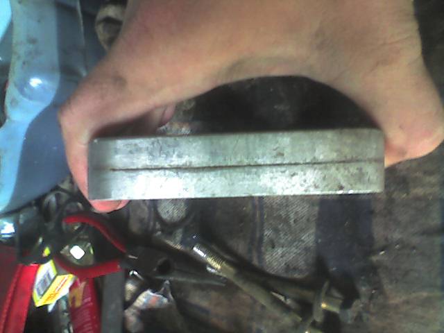

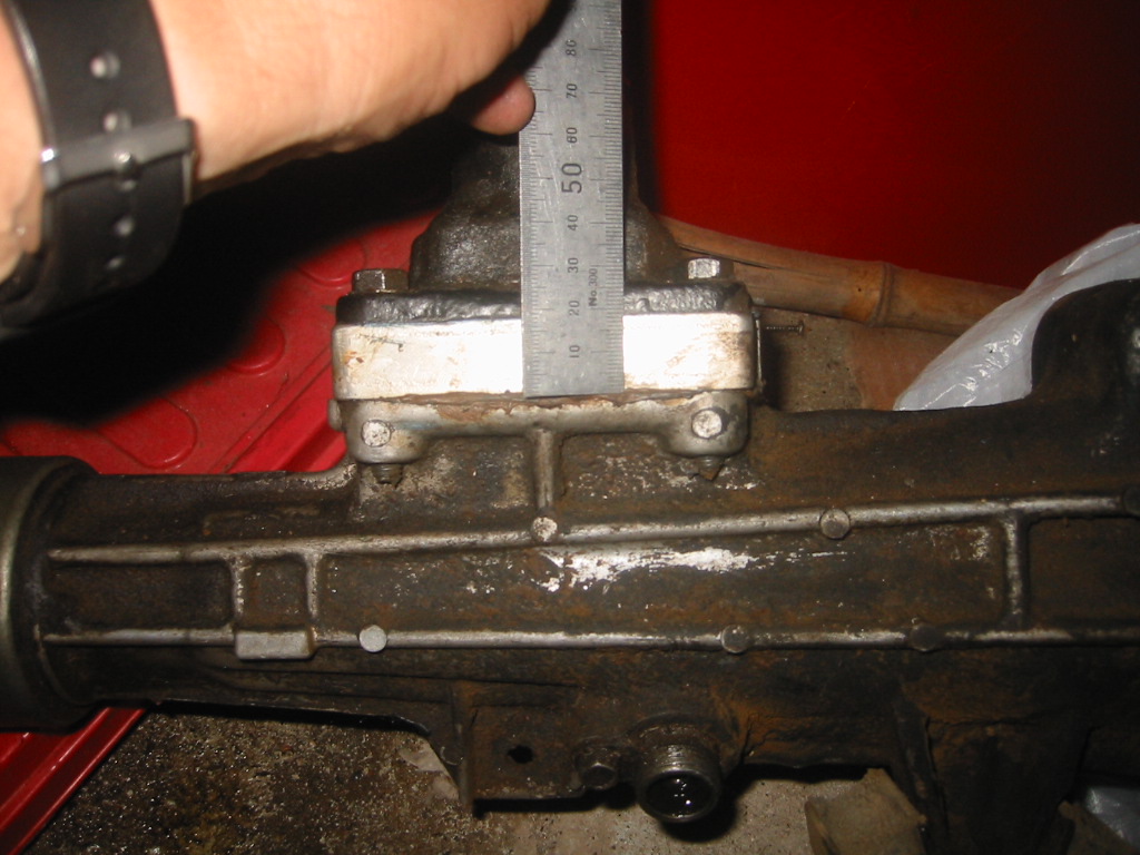

Just to add info to Red. MK I was 20.4mm thick to be picky. Also Ill throw up a few pics of MK Ito show people the weld version so they can see how the build can vary but still be good.
Main point with these WELD THE EXTENSION ON STRAIGHT. If you don't the shifter will be off leaning in a different direction from where it should sit etc could get messy.
Also For the spacer could just buy aluminum plate thick or thin. MK I by the looks is made with thin plate 10mm thick and 2 pieces pinned together.

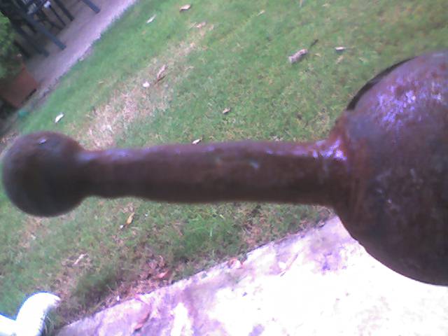

Also Red after talking about it I had a bent rusted now in the bin shifter. I cut the straight part off at the ball. Would be enough metal there to drill and tap a thread so you can have screw in longer sections so you could vary/tune your shift. Never took pics of the cut and metal room but.
Pics below of MK I
Above close up of weld.
Cam.
MK I I got out of my box today sitting in shed. It shifts the same probably shorter as it is 2mm longer. Yes I know has surface rust ill get to that one day..LOL So no MK I hasn't broken anything, still works its just dirty.
