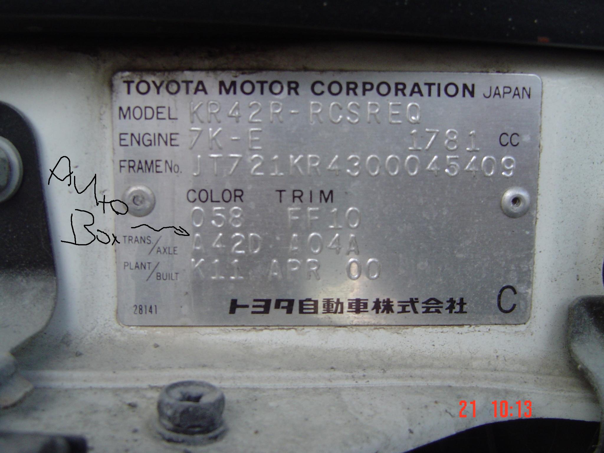

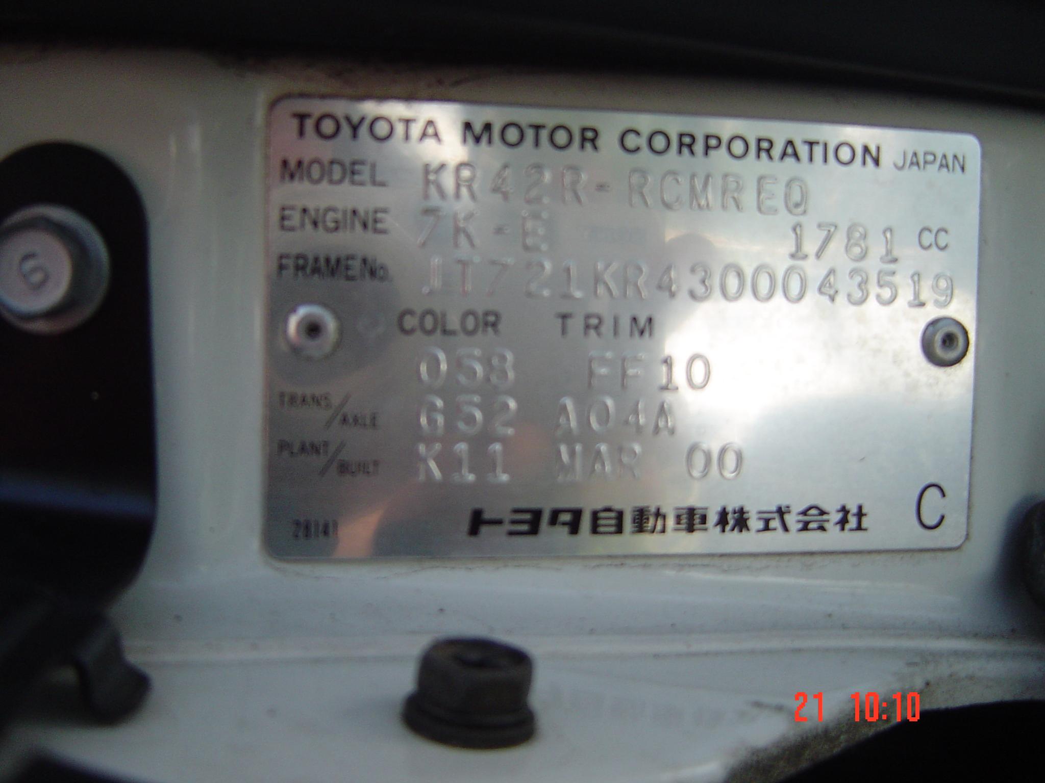

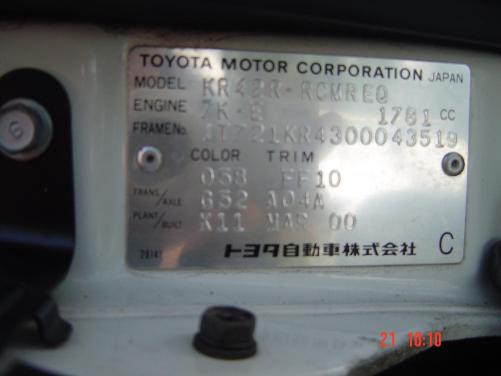

Do you know what year model the KR42R is then? Would you have an axle code for the diff in your van?
kr42 was 97 - 2004 i believe, the later ones have EFI. i'll get an axle code for you later on.

If you can get the code..It would be appreciated.I thought the townace diff would of bolted straight into my panelvan

Manual and Auto Vin Plates.
Auto one is shown, manual one is other one :yes:
