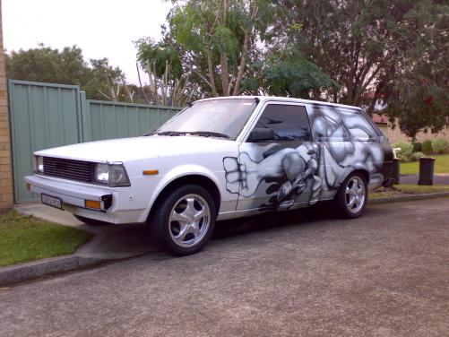

  18. I am jealous....I want your car....I love my KE70 Vans 5k With K-50. Wheels...15x6 Graphics by: The One and Only (Idiot) other than that...Pretty well stock.

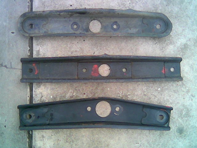

  21. Thanks for the info.Do the compliance plates have japanese writing on them? or are they made by AMI My car is a KE70 Panelvan made in Japan (Japanese compliance plate) I am using a T-50 from a AE86. I have tried using the following x-members AE71 and AE86 so i thought the TE72 might fit Here is a pic of some cross members Jap Ke70 Aus Ke70 Aus AE71

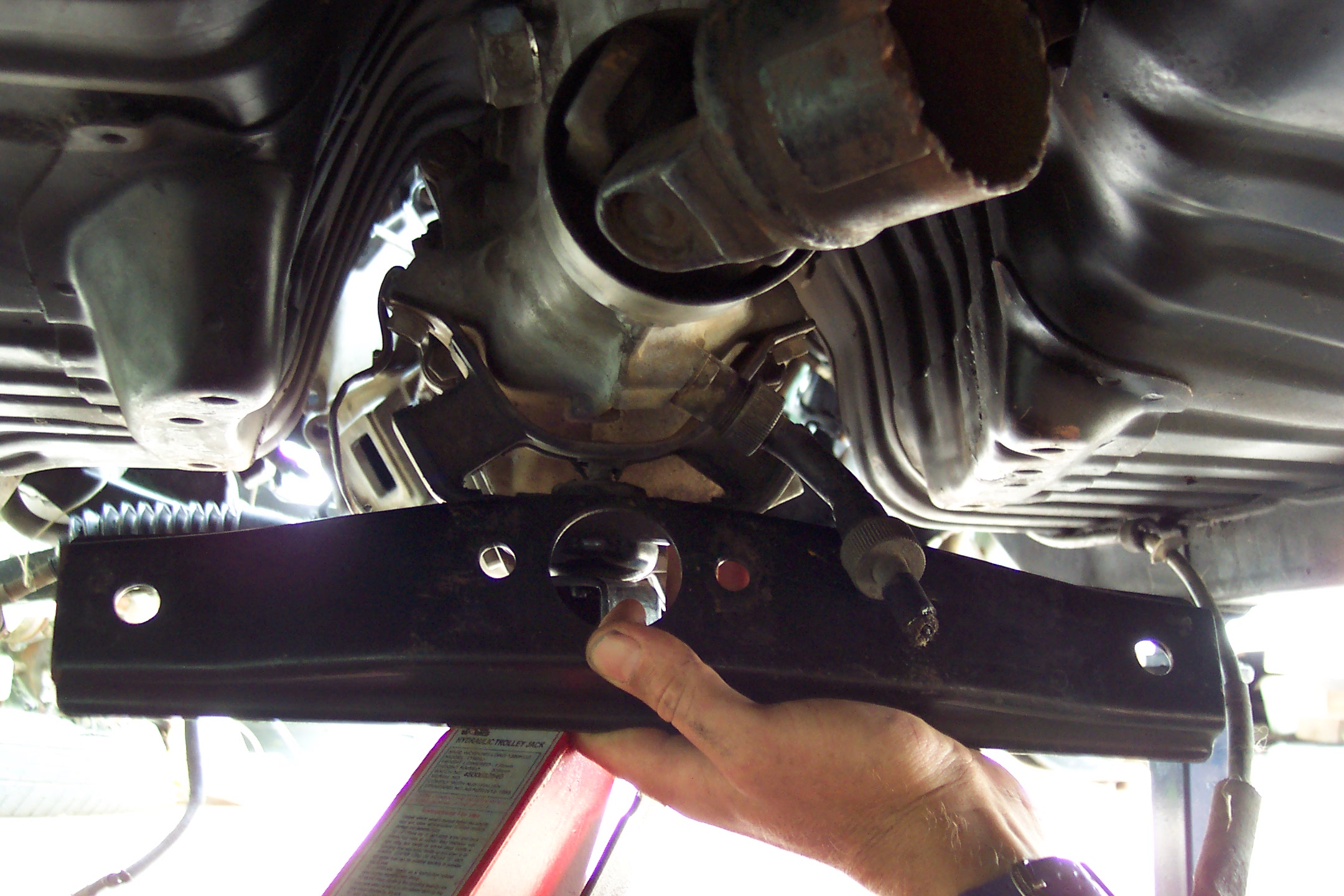

  24. Have you checked to see if it hits the engine mount? looks like it will be close :D
