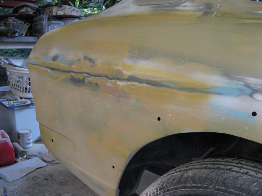

Does anyone have any tips or techniques for restoring the line down the centre of the quarter panel? The quarter panel has had a few knocks and access behind it is limited.

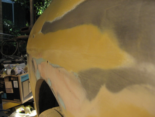

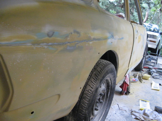

Ok, with the assistance of masking tape, duct tape, bog and primer filler I got things sorted :hmm: Pretty happy with the results, it really sharpens up the character lines of the car. It's going to be painted black so things have to be perfect.
1. Roughed up the metal gently with the grinder so the bog has some tooth to stick to, then taped masked one side.

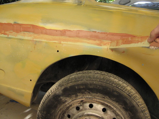

2. A thin skim of bog added in downward strokes then flattened long ways.

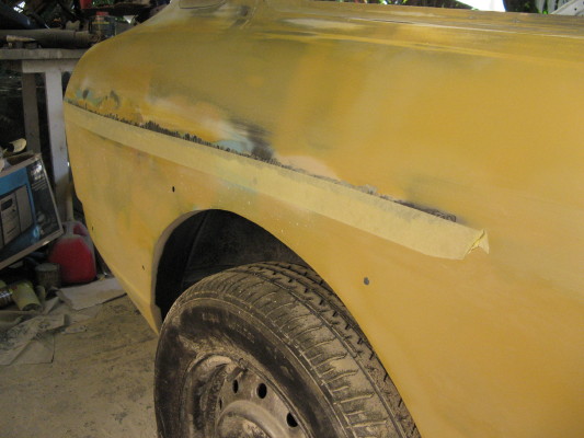

3. Feather in with a block and palm sander, trying to be careful not to rub back the centre 'ridge', duct tape will protect the centreline from being sanded back.
4. Repeat on the bottom side and use primer filler to fill up any scratch marks and pinholes.
Doesn't look to exciting (the primer dosen't reflect light well) But the quarter panel is dead straight now and should look awesome when it's painted black. :y:
